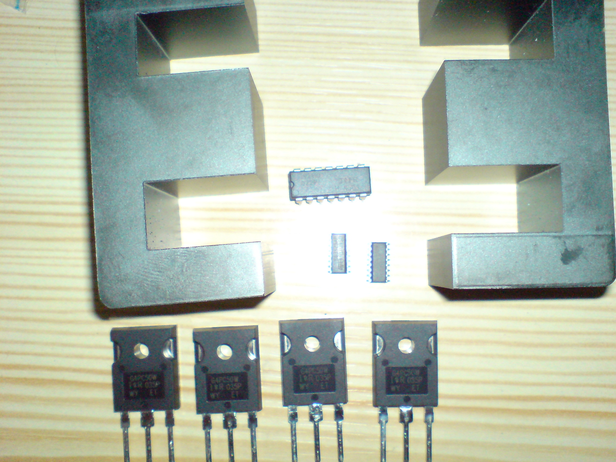

AFTER 2 YEARS I'm back on this topic , now it's about 5 kw smps , full bridge
so I will use the next parts :
MUR460 antipararel with the igbt
IRG4PC50W
EE71 (6.8CM^2)
AND 5 KW PFC
I calculated the transformer at 400v input so at 100khz i need just 10 turns( i use 12) primary , at bmax=1500 .... the secondary it's at 150v and i guess 5 it's enought (with 12 turs ) and will be around 166v .......
I think i will use2* ir2110 , but i don't know how it will handle those igbts at 100 khz with 10 ohms Rg
The triky part is the transformer , i have cooper foil about 0.1mm thick by 40 mm wide , but i can buy also 3mm litz wire , so the question is : witch is better the cooper foil (I'm afraid for the capcitance that those foil will create)
Also litz wire is good but i don't think it will fit into the transformer , because for the secondary i will use 2*150 v , each 150 will be bade with only 2 diodes (center taped secundary for each 150v) ...to minimase loses.
Also the transformer doesn't have bobin , so i will use sticlotextolit to make it , for the cooper tape(if i will use ) i have hostfan tape
http://i34.tinypic.com/2h699ch.jpg
If anyone have something to say about what to use , please write :
BTW it's not regulated JUST LLC ...

Dexter,
In 2001, i have built SMPS 2500W.
- Bridge mosfet APT6030
- Litz wire on "3c85" (not sure, 9 years ago)
- working frequency around 500kHz on low load, 150kHz on high load
Actually the most problem is pcb layout/wiring.

Interesting , it seems that yours is resonating depanding on load , can you post a schematic for it ?
I think mine will be with 100khz , LLC , but with frecvency shifting is more interesant .
Yes, resonant system. Efficiency around 90%, for 2500W output, around 2780W input. So around 280W heat dissipation when full load. This is very hot. I use 2 dc fans and a big customized heatsink for the cooling.
