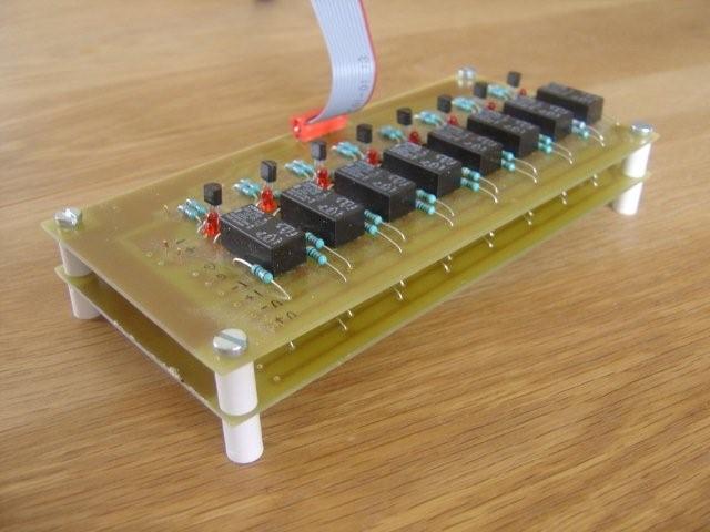

I've finally managed to get it together. It tok me some years but here is a picture of my volume control for the Aleph P 1.7 :angel: :angel: :angel:

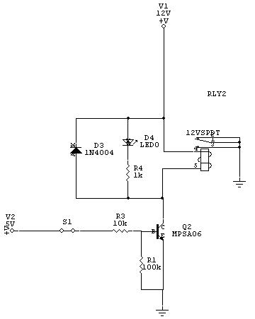

loovet said:
And here is the asambler code that I've used.
I have to say that I am not that much in to programing, but it works. The only problem I have recognised so far is that there is a "blip" when several relays are released at the same time.
besides solutions in code for bleeps,you can always put cap in parallel with each coil
Algar_emi said:
What processor did you used?
You may change the code to make sure that only one relay is changed state at one time.
What do you use for volume control? Do you have the schematic of the controller circuit?
Thanks...
SB
I used th PIC16F84!
I will change the code as soon as I have the rest up and running. But i have to figure out how🙄
The volume control is from the Aleph 1.7.
BR
/loovet
Hi Zen Mod,
I’m on my way to get the rest together and might soon start to focus on the volume control and a solution for the bleeps.
With elco i asume you mean electrolytic, right? Any hint on the value of these?
And Zen Mod, it’s a nice avatar you’ve got, Hope you’ve read the book.
Thanks in advance
/loovet

elco - yup - electrolytic
say - that for usual 5-15mA coil 220uF is enough
book ........ not just once ......... even in 40. , that's one of books I read every 10-20 months ......
I like movie too - from which that pic is taken .....
