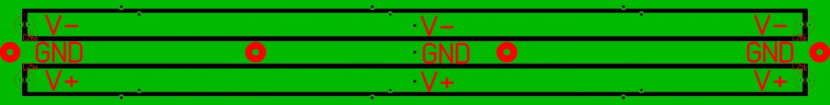

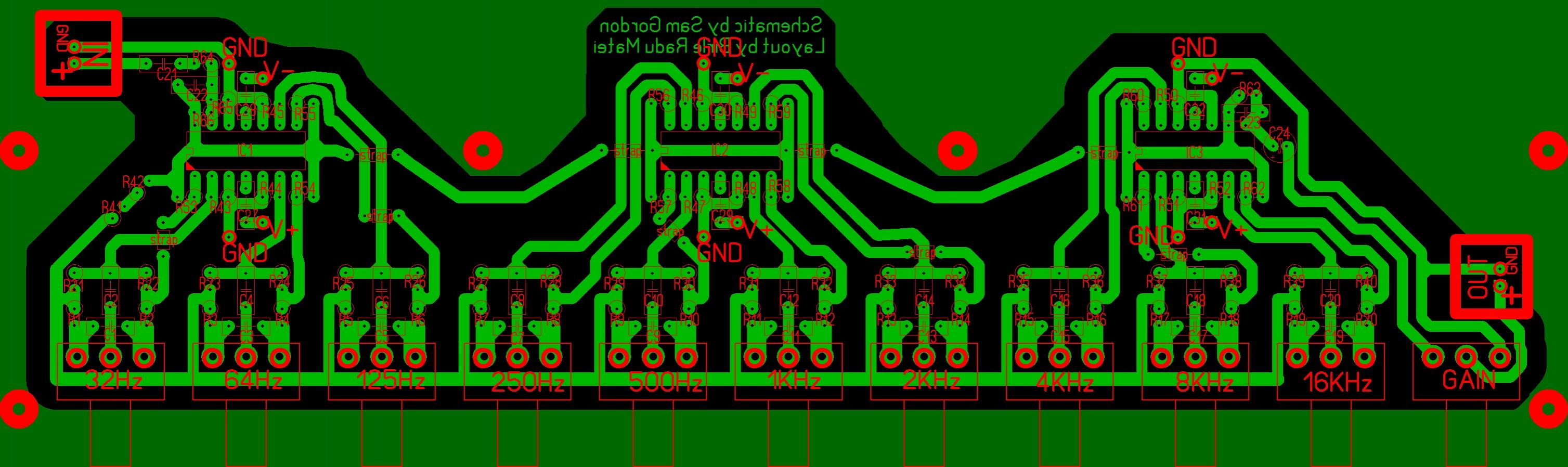

I finished the board. I only have to triple check it. The pads are big and the traces are big so anyone can etch the boards, even if they trace them by hand. In the mono configuration you can build the board as shown. I did not deal with supplying power as many of you wanted but I made it easier for those who want more than one mono eq board. It also has a ground plane around it so interference is minimised. To supply power you have to build a power strip. To ve more exact, etch a power strip. Everything is bolted togheter so it's easy to parallel an infinite number of boards. As I said, I have to triple check everything so there's no mistake it the layout. For the ICs I recommend soldering a socket.

I finally finished and checked the layout!
I'd tell you something about the THD performance or so but i sincerely have no idea how to simulate the schematic.

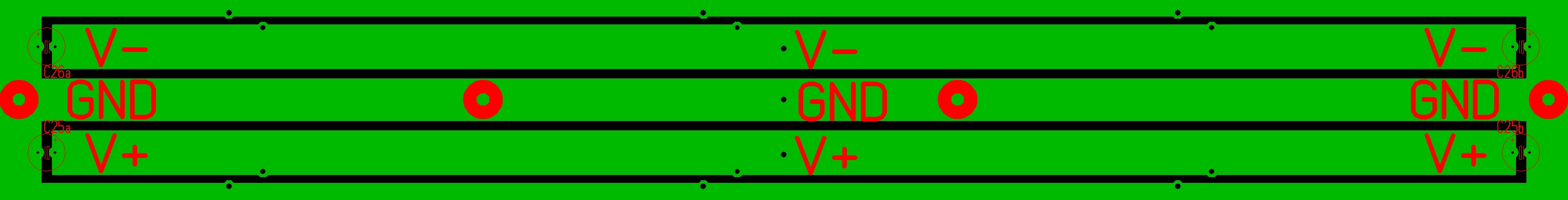

The board is mono but you can stack them, thus having all the connections close together making wiring stereo pots easy.
You'll see that the supply connections are near each ic. I did this because it was much simpler to design and it also makes the boards easily stack-able. You bolt them together with 6 screws (M3) which also act as ground connections for the ground plane. The actual supply (+-15v) will be connected to the power strip and distributed further through long pins. I'll try to make a drawing. I hope you like it and is useful!
The gerber files are NOT mirrored!
Even though i checked it, i recommend double checking. You can use Gerber View to add both copper and silkscreen in order to simplify the job of checking the circuitry i you can't download the pictures.

About stacking the eq boards, it should be like this:
_________________________________ <<power strip
_[]___||||__[]__||||__[]__||||__[]___ <<eq A
_[]___||||__[]__||||__[]__||||__[]___ <<eq B
|||| - the power delivery pins
[] - M3 screws
The EQ boards look great to me (no doubt other members will comment on the technical aspects).
I like Struth's suggestion of separate boards for the pots and circuitry. That way you can use dual gang pots to control both stereo channels from the one pot, run a ribbon cable(s) running to the other board, and have more flexibility on how to lay out the components
True for some. I'll have all my small signal stuff in the front of the amp, the amps left and right, transformer in the center, protections and output in the back of the case so this is the kind of board that suits me best. One can also do the whole two boards thing by etching another potentiometer board and wiring to the boards I designed; the shield can be connected to the front part of the ground plane if that's the problem.

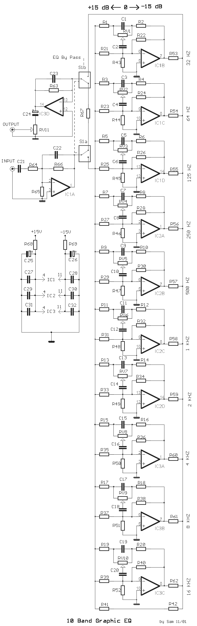

Brlmat, regarding the EQ circuit: Your pot symbol threw me off at first but I see you used the standard bax circuit only for one control per section. You could have used two per section, as 1+6,2+7,3+8, etc. Each paiur of bands is then far enough apart that they do not conflict using the same opamp - half as many opamps then. How you did it will work just the same but requires more power.
