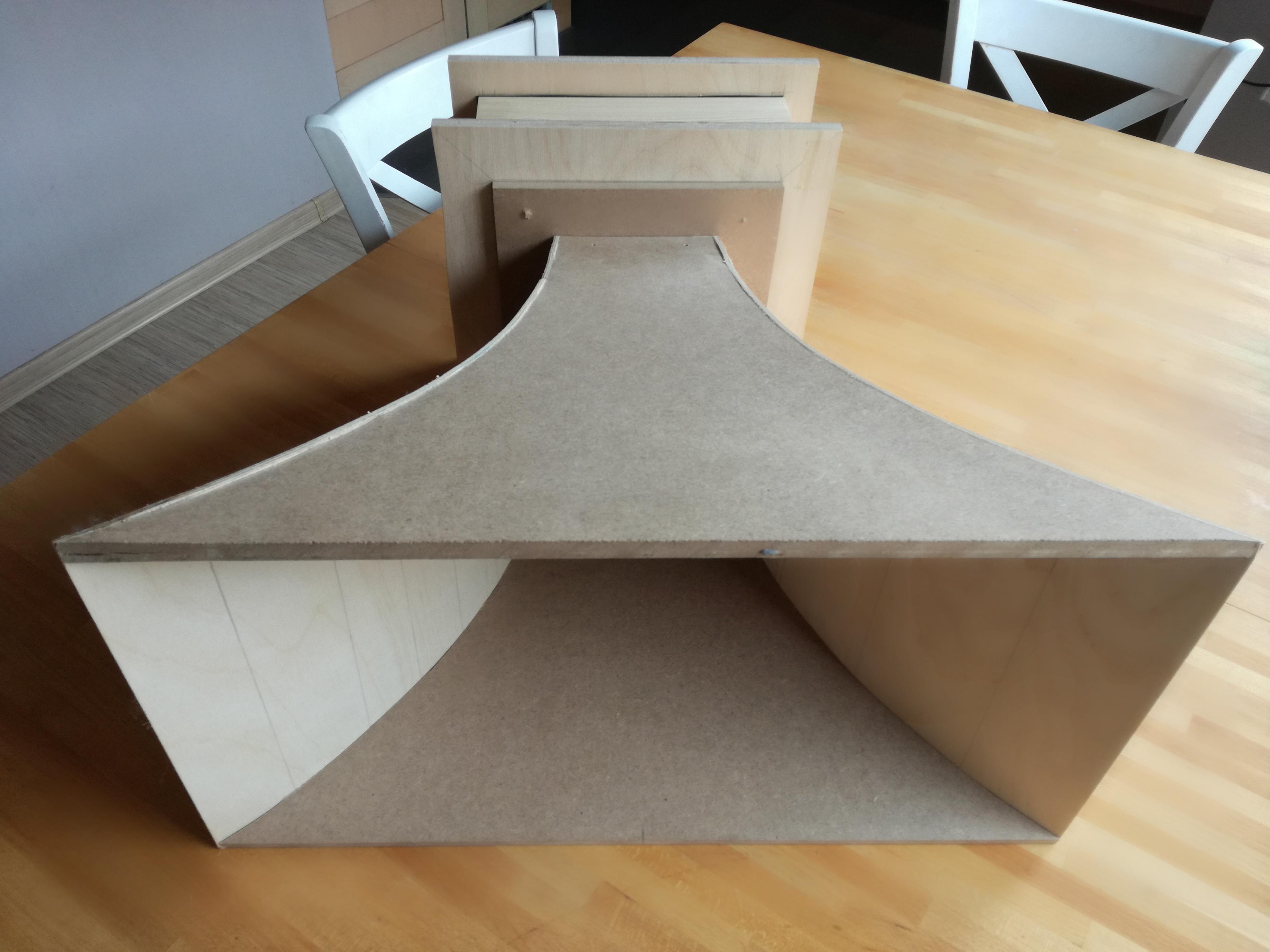

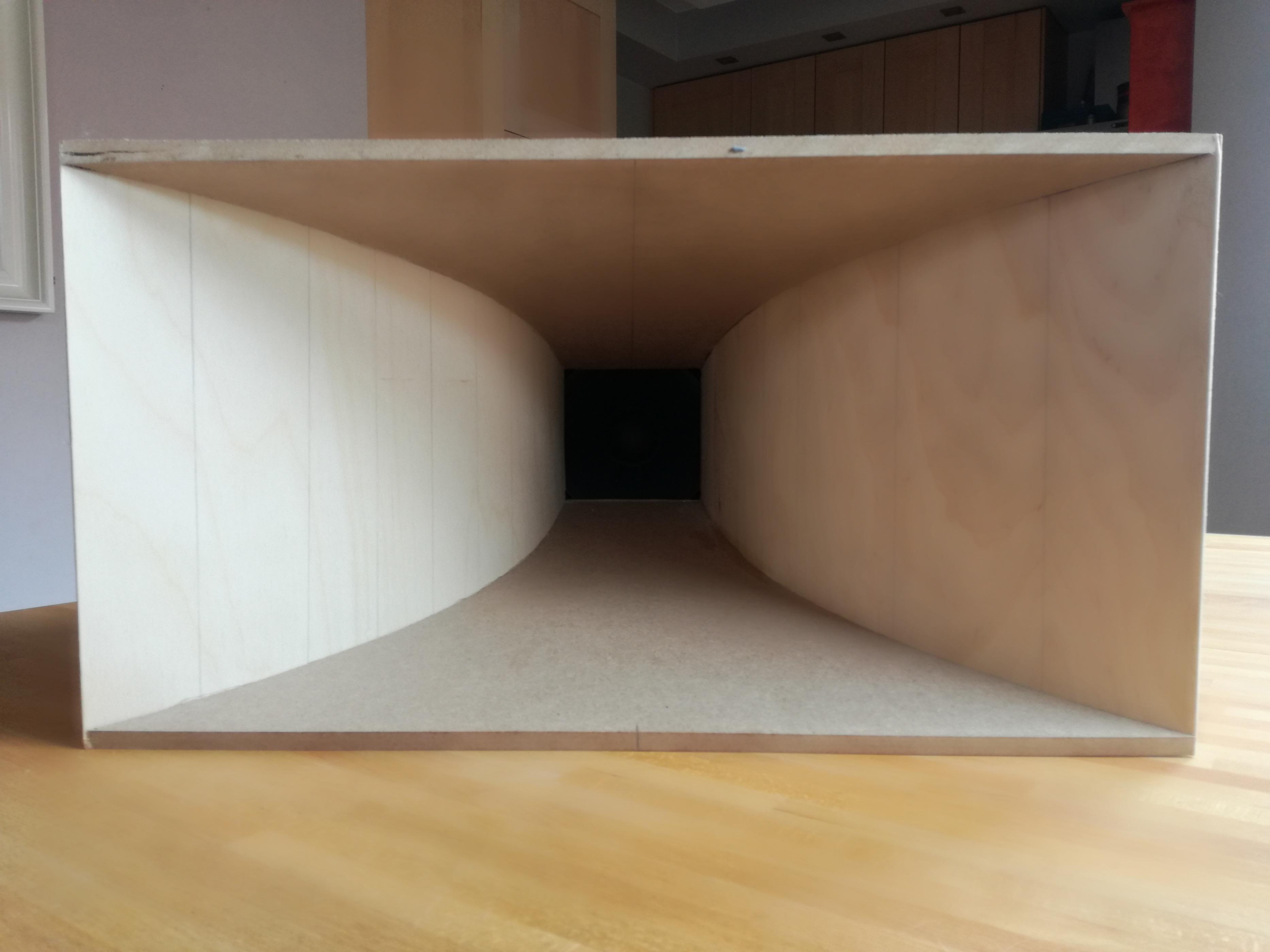

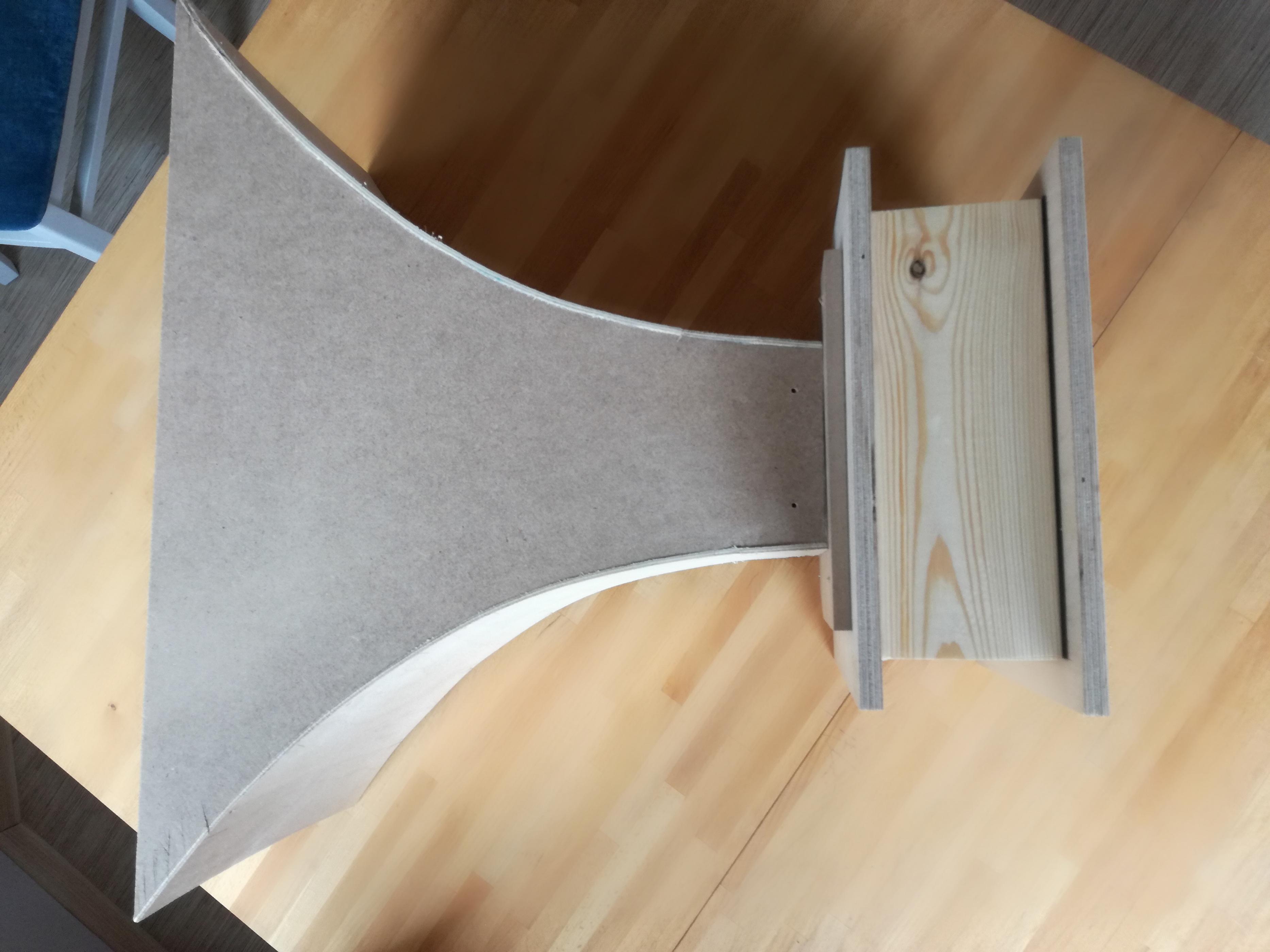

Having that on mind I realized that what I needed is a prototype... so I built one. The mouth is 28x55 cm (inner dimensions), the throat is 11,5x12 cm, inner lenght 41 cm. I didn't get 8PE21s yet so I thought I could try the horn with FaitalPro 8FE200 I had from some old project. The rear chamber is made as small as possible, sealed, filled with some polyfill.

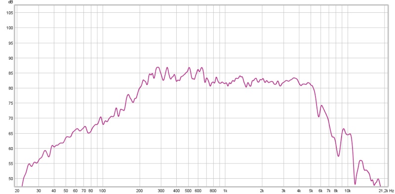

I've taken the measurements. As you can see it's quite good from 200Hz to 850Hz, then it drops rapidly.
It made me think if having the intended BC driver in that horn would really be so different that I could reach 2000Hz on the upper end. Any thoughts? Ideas?
Maybe some modifications to the horn?
need better high end response.... it's phase plug time...
and i would filler the corners between the vertical and horizontal so as to radius them and find a way to round over the mouth and turn the throat circular . ...but that's just me.

I think I install a vertical piece of mdf to shut the throat completely but with a circular hole of 8 cm (diameter) and then try to fill (with some clay or something) the space between the new throat and the horn walls - to make a smooth-ish transition.
Pretty smooth, too. That would be good with minimal EQ.

Note: you used different scales for the measurements, so they are hard to compare at a glance.
If you are using simple EQ, the subjective comparison may not be "fair".
e.g. with a low order crossover, the Seas will be about 10dB louder in the 2-4kHz range. It will overlap a lot more with the HF driver.
In my experience, a less symmetric throat can give smoother HF.
You could try putting scraps of foam onto the mounting plate to break up the symmetry of the gap between the cone and the horn throat. This might fill in some of the HF notches you measured with the 8" Faital.
When you go from prototype to final build, you could try making the throat taller / less square, eg 10.5x13 instead of 11,5x12.
