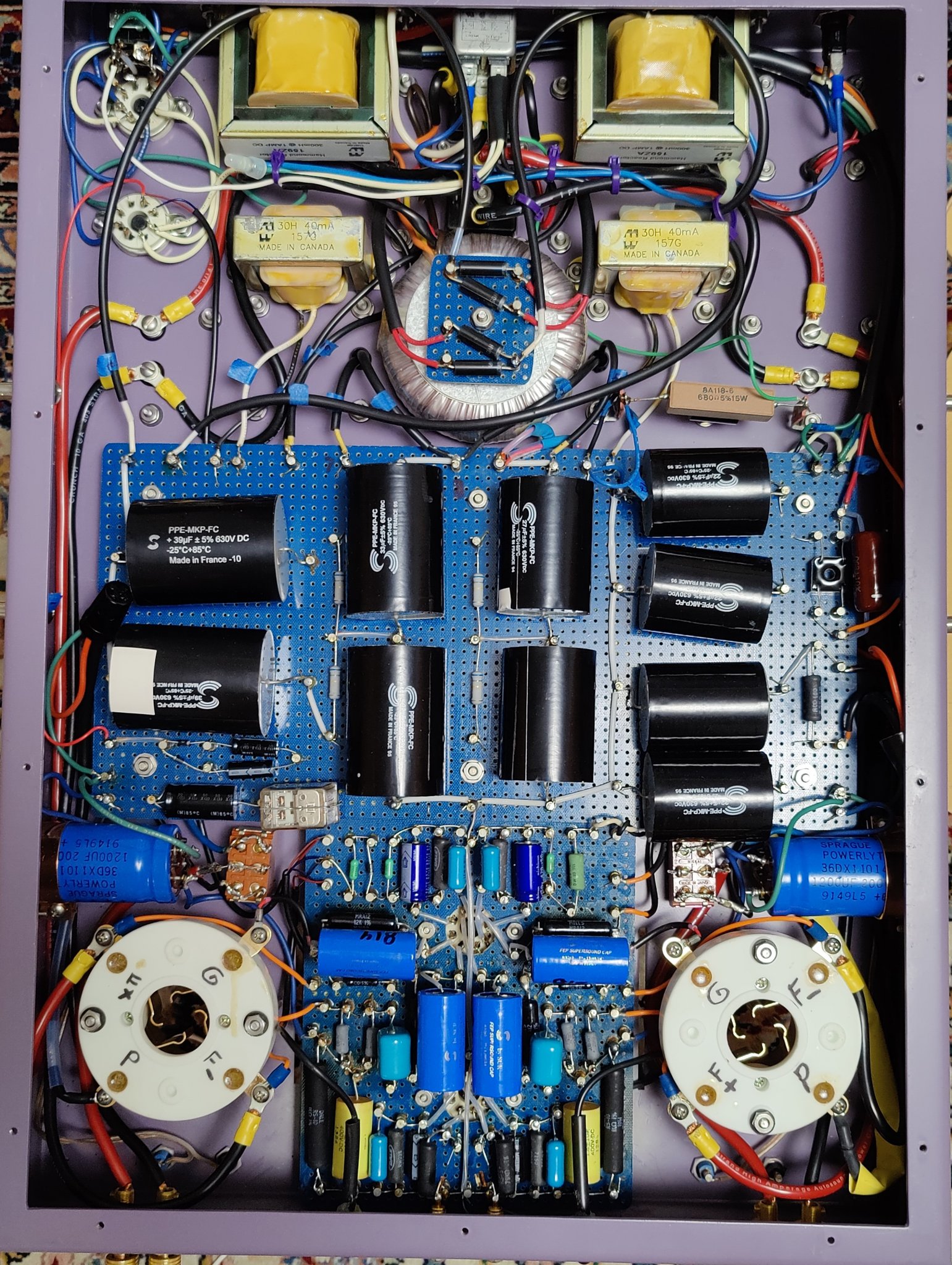

Attached internal shot of the amplifier. Power supply is 2/3's of the chassis. The input/output board is between the 211 sockets. Those electrolytes on the side of the amp just above the 211's connect in the filament/bias circuit of the 211 tube. These might be candidates to replace as it gets toasty there. I have replaced the grid to plate coupling resistors barely seen above the blue teflon solen caps, which are also upgraded from regular film caps, and to the outer edge of the lower blue Teflon caps. Last weekend I replaced a 1K and 2-25 ohm resistors in the same filament/bias circuit for the 211 that those electrolytes also serve. The 1K's are located on the lower outer edges of this board and the 25 ohms are just above them.

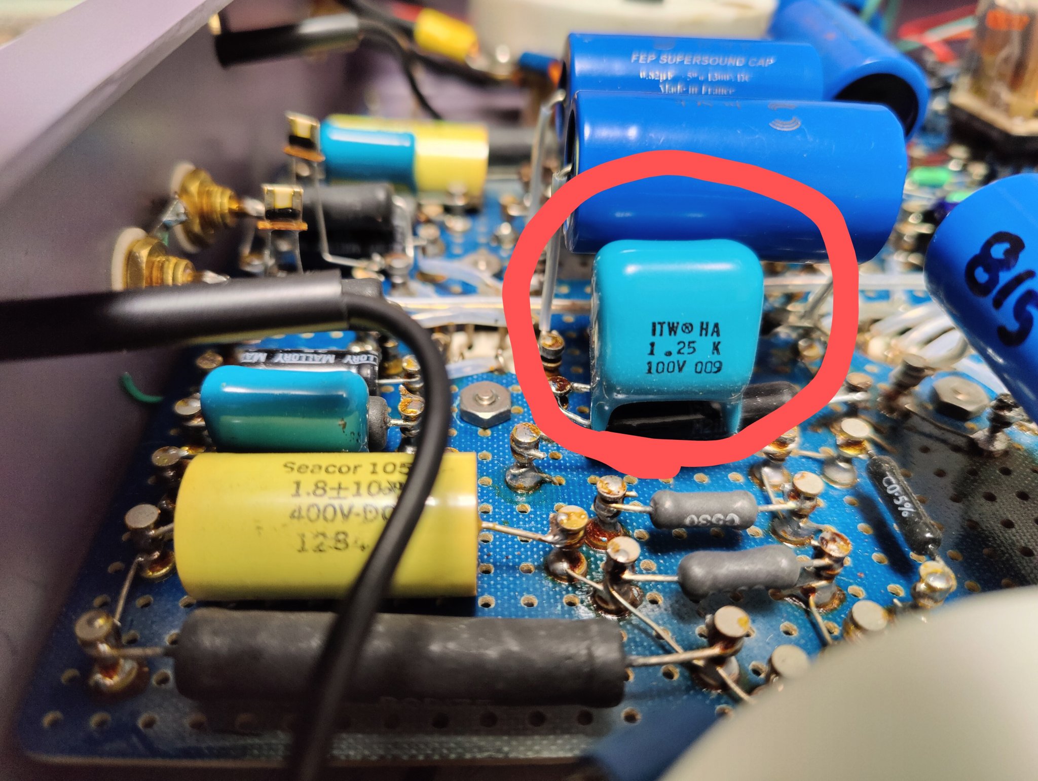

What value of capacitance is this capacitor? the schematic says it should be 3.5uF, 100v. You can also see better the 1K and 2-25 ohm resistors before I replaced in this picture.
Looks like 1.25 uF, 100 V. K is the tolerance if I recall correctly. 1.25 uF is an odd value. Capacitors tend to follow E6: 1.0, 1.5, 2.2, ... 6.8. Sometimes E12: 1.0, 1.2, 1.5, 1.8, 2.2, ... 8.2.
The black power resistors? They look fine in the picture.
Visually the board beneath was discolored and the resistor looked pretty worn, so I just went ahead and replaced with same value.

Does the ticking subside after a while? It could be a thermal thing. If the ticking remains even after hours of warmup, I'd go looking for crappy connections in sockets and the like. I suppose a dying tube or capacitor could do that too. Or maybe something is arcing over because of dust/grime collection.
Many seem to forget that power resistors will reach 250-300 ºC when operated at their rated power. Even with 3-4x de-rating, which is what I normally use, they'll reach 80-100 ºC. Over time anything near the resistor will develop a bit of 'patina'. 🙂

The, now very soft ticking, usually doesn't start until the amp is on for 3 hours sometimes even 4 but once starts will remain until I turn it off. Replacing resistors definitely helped, but you can see in the pic a lot of flux on those turrets, so some of that could interfere with a clean signal transfer I suppose. I'll focus on the coupling ones between grid and plates and clean turret with acetone and pipe cleaner then resolder with my Weller digital iron with the biggest tip on, I use cardas solder. Then maybe some of those electrolytes will be next to replace. Might even replace 6sn7 and bx7 tube sockets but that looks to be a major PIA, I cleaned them pretty good. Tubes have been swapped and have no effect on the ticking. It is pretty soft now tho, a good thing I guess.
One more interesting development. I finally managed to get one of those Topaz very low interwinding capacitance isolation transformers. I have plugged my amps and dac into this transformer. Its been two weeks now and I no longer can detect any ticking at all, Hmmm. When the amp was plugged straight into the wall or another Tripp-lite isolation transformer I had very soft ticking, now with the topaz it appears gone. So maybe it was something on the AC line?
