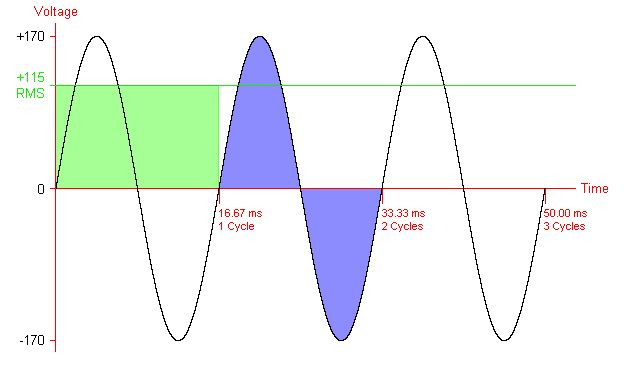

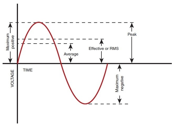

"24V RMS AC" gives exactly the same heating power as 24V of DC.
While the AC spends time at zero, it also peaks up to 33.9V.
Anyway if start/recup were an issue, the station designer could just throw higher voltage at it (or wind the heater to take more power at lower voltage), only being careful to cut-off before anything melts. (Besides the solder.)
