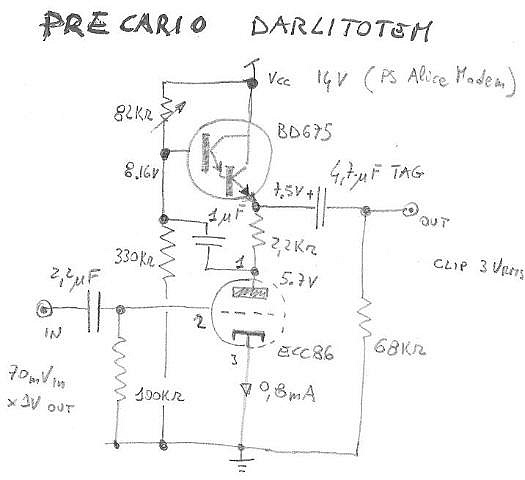

Please take note of the new link to PREcario low voltage tube preamplifier
New link:
http://www.audiofaidate.org/uploaded/plovati/PREcario_darlitotem_lowres.JPG
Hi plovati!
How can you change the schematic instead with tube ecc86 with replacement ECC83 (12ax7).🙁
In this case, the anode voltage Vcc=+ B = 250V.
Thanks for the help!
