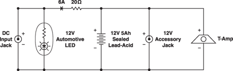

24V Battery Amp Wiring Help
If you check the podzuma schematics, he charges his 12v battery pack with a diode and resistor.
Now, I have 2 12v 7.5ah batteries in series for this amp. If I put 2 12v accessory jacks in series, what kind of things do I need to change in order to charge my 24v battery pack instead of this 12v circuit.

what is the input voltage?
if it is from a car or 12 volt charger it may not charge the batteries completely.
to charge from a car you will have to step up to around 28 volts

put the batteries in parallel to charge and series to run you devices.
a battery should not be charged faster than about 10% of its ah (amp-hour) rating unless the manufacturer has some other charge rate listed, many times on the side of the battery these charge ratings wil be listed.
now then if the batteries are completely discharged they may very well draw much more current than 10% thus overheating the battery leading to and explosion at worst or depletion of the electrolyte.

charge voltage maximum should be 13.6 to 13.8 per battery and a series current of around 750 to 1000ma, if you have no manufacturers
information to be safe.
at full charge do no exceed 28v and limit the current at 750 to 1000ma
an lm317 with a heat sink in current limiting would work well, us heat sink.
it might work well with your power supply if the open circuit voltage doesn't exceed 37 volts to the lm317.

And as someone above noted, you just need to rig up a switch so your batteries are in series when using them, and in parallel when charging them.

You can connect them in series(similar made battery preferably). You can use the circuit shown here but you may need to change a few components to get about 28-30Vdc output. Charging current limit to 120mA.
