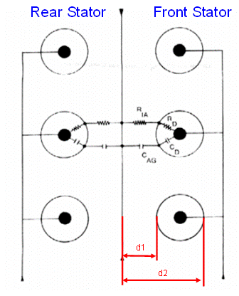

Acoustat`s use about 1/16 of an inch spacers so if you want greater efficiency you will need to go for a thinner spacer and less bandwidth.... Best regards Moray James.
Acoustat actual D/S was 2.5mm (1/10 in). Solvent welding caused the wires to sink into the grid slightly providing the extra gap.
This value agrees pretty well with the measurements I took of two different Acoustat models(1+1 and Spectra 11) which were 0.09".
http://www.diyaudio.com/forums/planars-exotics/183168-acoustat-answer-man-here-8.html#post2493836
Does anybody know if Acoustat had a way of controlling the amount by which the wire would sink into the grid?
Seems like it would be important so get consistent results.
are you both measuring the distance between the surface of the dielectric and the diaphragm? I measured between the top of the styrene holding the stator wire down to the louvre and the diaphragm as that is the physical limit the diaphragm has till it hits the stator. This had to be averaged out but was fairly consistant on the panels I measured. Best regards Moray James.
We are measuring the distance between the uncharged diaphragm at rest, and the outer surface of the PVC stator wires.
Looking at the attached pic:
d2 = the spacer thickness = distance between diaphragm and the surface of the louver.
d1 = D/S spacing = distance diaphragm can move before hitting the stator wires.
Since the wires are glued to the louver, d1 = d2 - OD of wire.
I measured:
d2 = 0.15" & OD of wire = 0.08"
So, if wires were glued to the surface of the louver, D/S would be 0.07" = 0.15 - 0.08
But, the wires melt down into the louver a bit.
With dsink = distance wires sink into the louver:
D/S = (d2 + dsink) - ODwire = 0.09"
Yes the actual physical distance that the diaphragm can traver till it is going to hit the stator (or in actual fact the styrene on top of the insulated wire) is D1 minus the thickness of the styrene used to encapsulate the PVC stator wire to the louvre. Best regards Moray James.
@bolserst
That picture looks like it came from an interesting context...
Should have mentioned, the figure was taken from the Acoustat White Paper.
I had added the dimensions (d1, d2) to the figure in an old post and just grabbed it for use here.
