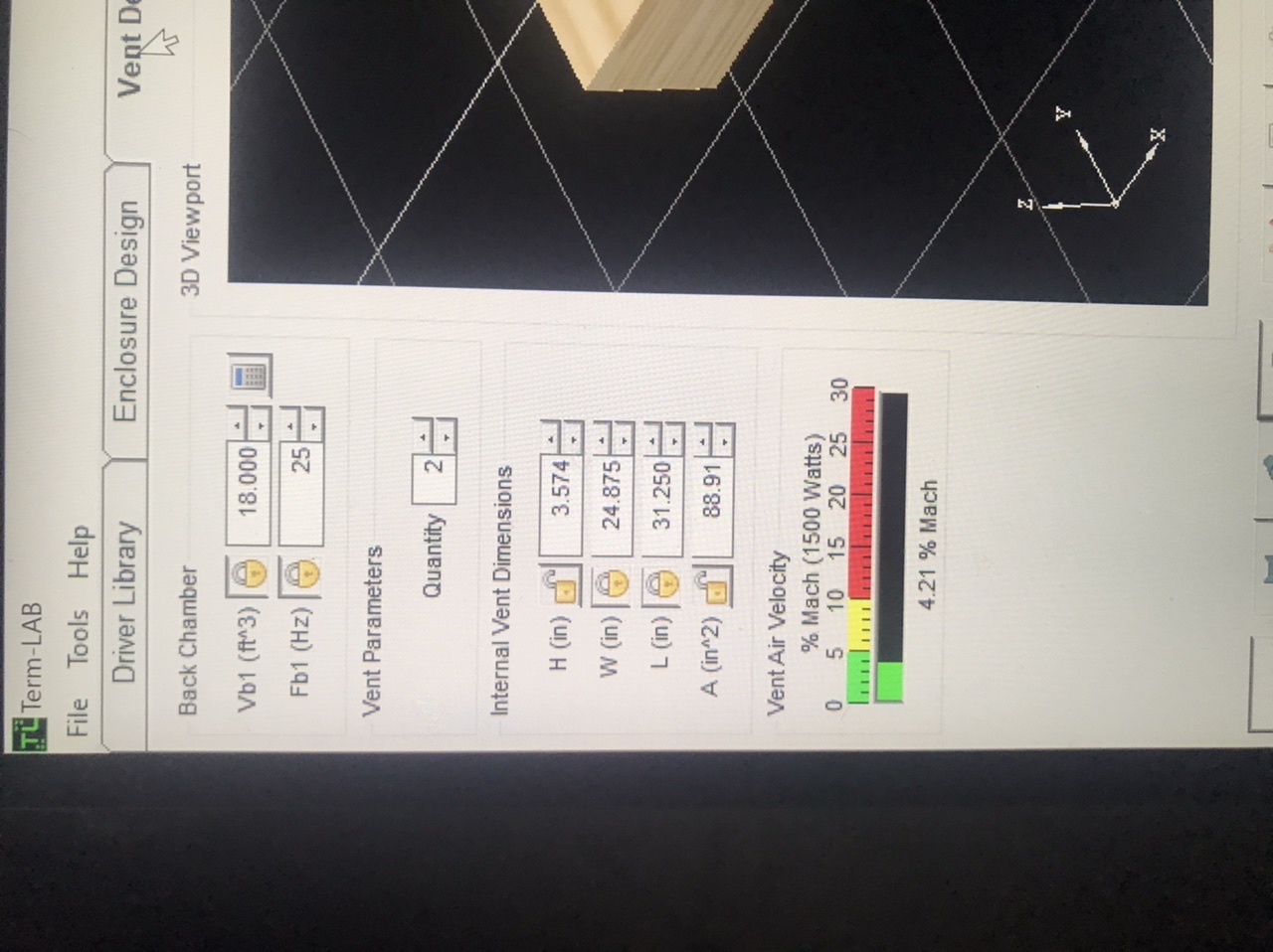

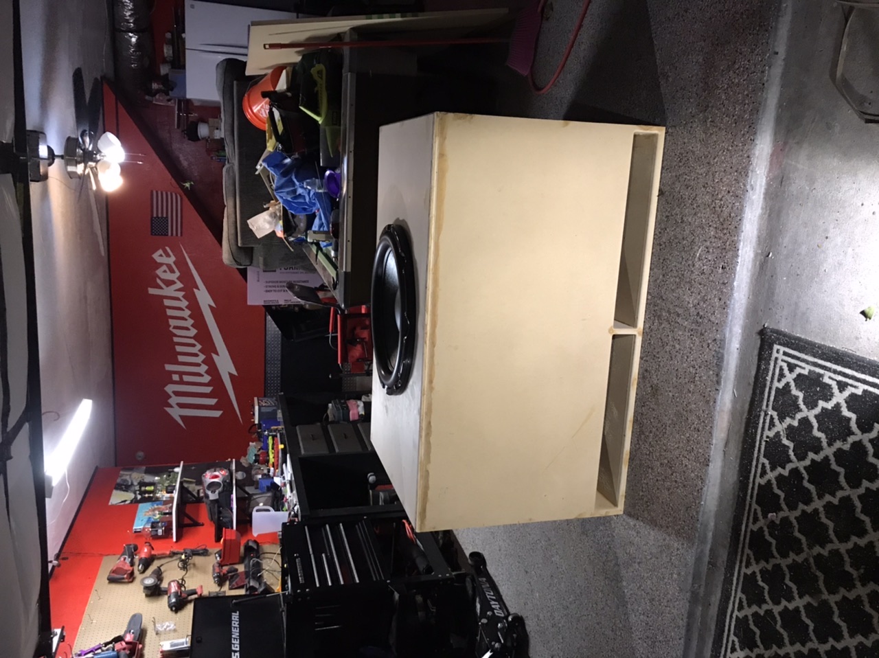

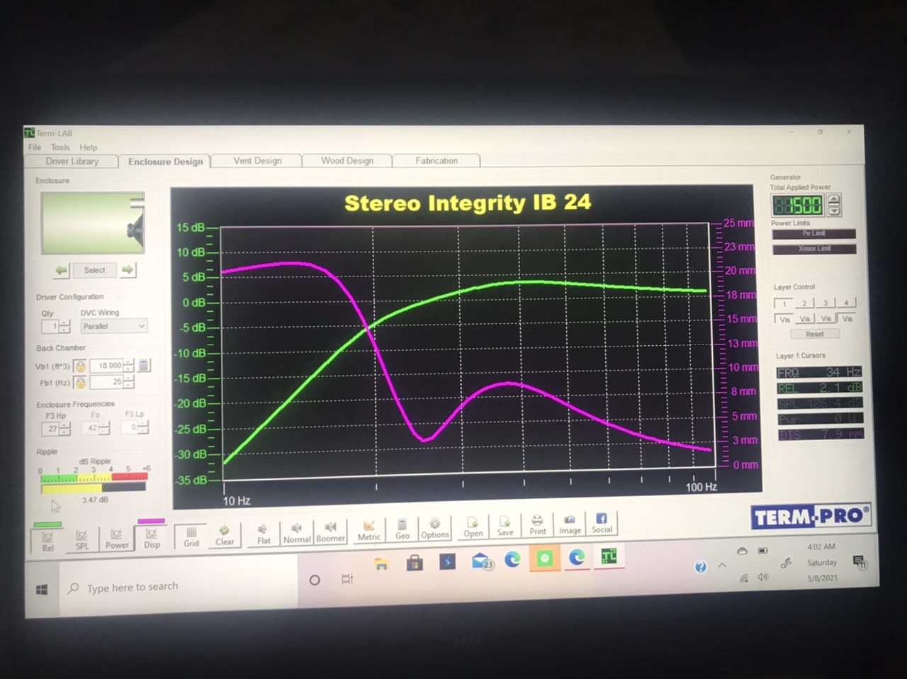

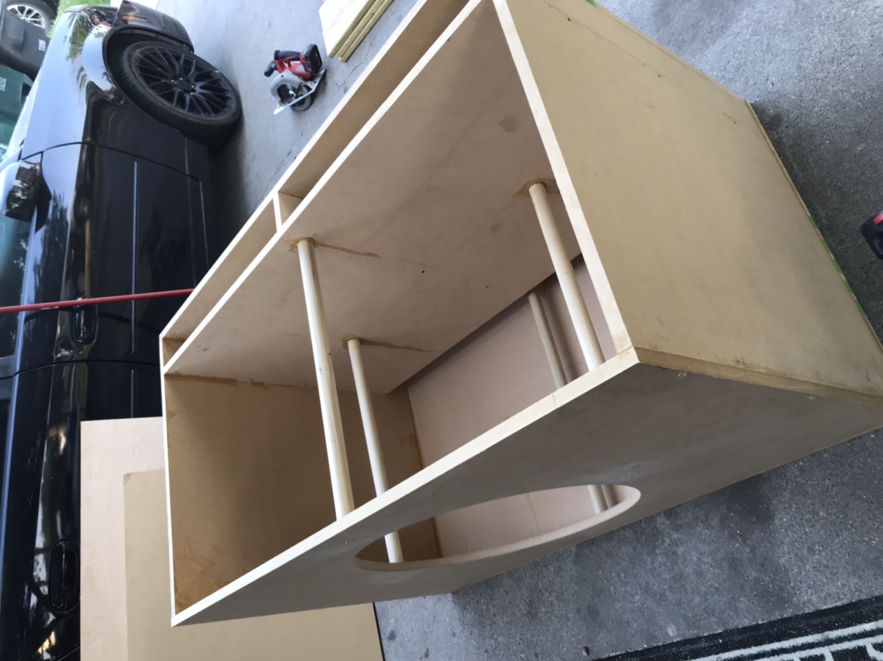

My main question: does the box I built NEED more bracing to avoid a panel blowout? I’m ok with minimal panel flex but I can add more dowel rods to brace sides and front/back panels together.
I finished my 4th box build today. It’s definitely the biggest I’ve done at 28ft^3 gross volume. I enjoyed the process and I am very curious to learn more about building boxes of this magnitude as I have almost zero.
My big concern is bracing. I’ve never used it but I knew I needed to for this build I just didn’t know how much. For sure on the loaded panel to support the weight. But is there a mathematical way to figure out how stiff or rigid the panels should be? I’m currently going to school for mechanical engineering. I have an associate degree so far and almost done with undergrad classes so I can understand almost anything thrown at me no matter how technical. If I don’t get answers I’ll probably search my statics book and see if I can find a solution that I’ll share.
I want to be able to say ok the woofer is this “x” many inches and weights “x” lbs and will it be side/top/wedge mounted. How big is the panel it’s sitting in? What’s the material thickness? What’s the bracing material? Bracing thickness? ... use “this formula” to calculate amount of bracing for opposing panels and “this formula” for adjacent panels.
Not sure if I’m making this harder than it should be? how do you experienced guys do this process without unnecessarily over bracing your big boxes to maximize chamber volume but still keep a tight box that won’t flex or blow out a panel.
I’ll leave some pics of my project attached if anyone’s curious.
Any tips appreciated as I am fairly new to this and I want to learn how to build premium boxes!
This is a finished box but not “finished finished” the guy I built for said he wanted to rhino line on his own.

Here is a good rule of thumb: a brace should be placed such that the subpanels have higher aspect ratio than the aspect ratio of the panel being braced.

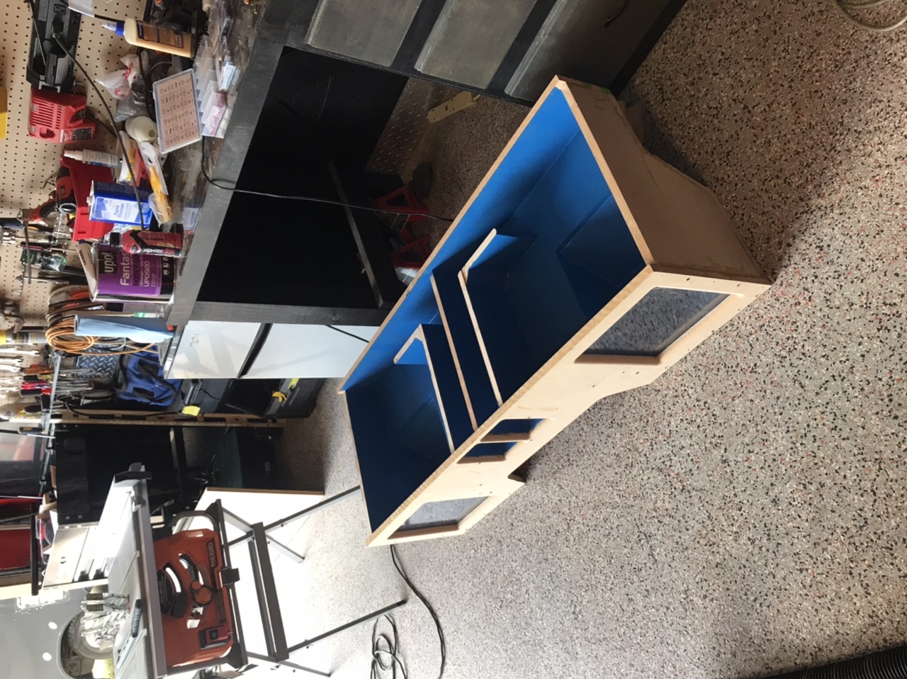

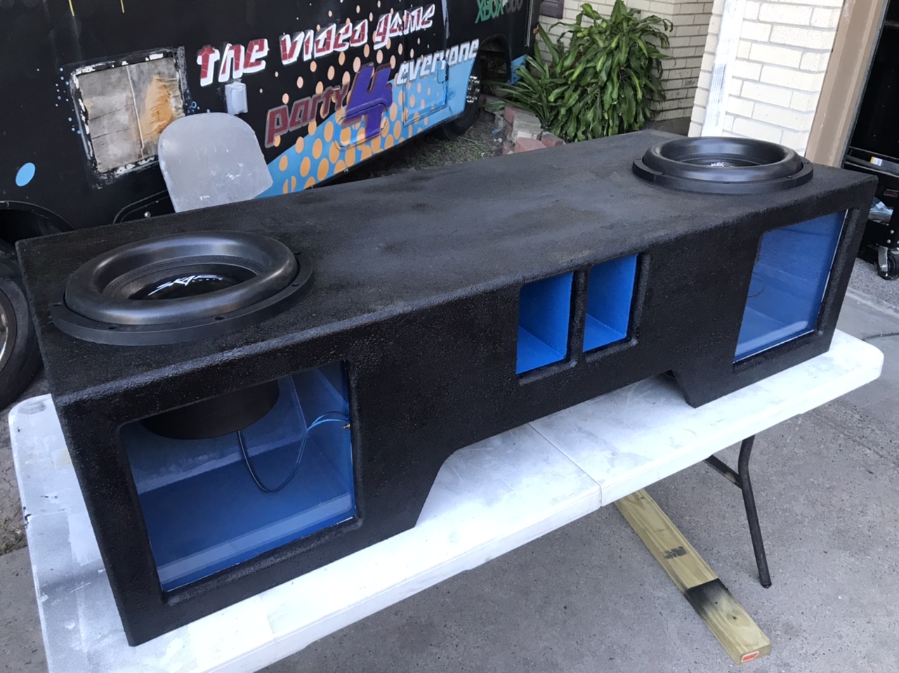

Here’s my last build to give you guys an idea of where I’m at more or less.

Blowout no, but balloon, yes. A big unbraced 19mm MDF box will balloon.
dave
If that is a hole for a 24” that box has totally inadequate bracing. And MDF?
What are the box dimensions?
Anytime you do a subwoofer you have to seriously consider taking advantage of push-push loading. I would choose 2x18” over a single 24” (quality similar).
dave
How would you recommend I beef it up giving It’s already built... but has not been plugged up and tested. Cross bracing the 4 vertical walls to stiffen the box through its horizontal axis? How can I avoid making this mistake in the future? And would you recommend a different material other than 3/4 in MDF which is the thickest I can get my hands on locally.

I don't know about the mathematics of bracing (I'll leave that to your engineering classes). The way I think of bracing is to imagine each panel being like a speaker, flexing in and out. I would put the bracing in the middle of the points each panel flexes the most. So that would be the mid-point of the top/bottom. I would put three horizontally to brace the side panels. I would add a brace above and below the speaker to strengthen the front/back. All in addition to what you already have. But I've only braced lower-end speakers, I don't know if this would be over-doing it. To my knowledge, the firmer the box is the better the speaker will perform.
With regard to the wood, I would have chosen hardwood ply over mdf. You could strengthen the mdf by gluing panels of hardwood ply to the interior surfaces, this shouldn't change the interior volume too much.

Your cabinet is near 800 litres, to give you an example of the bracing required in a 135 litre box for a 16”. Start the brain moving.
15mm quality plywood be the first step up. 18mm is the usual choice with woofers, doubled where needed (baffles usually)
A good description.
That is not a good placement. It will not suppress the primary resonce (i can find an illustration if needed).
dave
Even if you keep the mdf box, I would replace the front baffle (that you mount the drivers on) with thick hardwood ply.
At the very least add a similar number of braces top to bottom as your front to back bracing. I'd also put bracing end to end. You can add a second skin with a constrained layer if you are disappointed with the initial result. Don't get too stressed about everyones' opinions; there are degrees of perfection.
