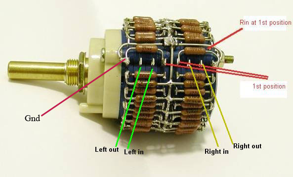

24 stepped volume control schema?
24 Step Chinese Attenuator
It should be very like this:

Yes I have,but there are 4 or 5 points where it is possible to connect it..
The ohm meter can be a critical tool for figuring out how to hook it up.
(1) An attenuator like this usually has 3 connections - input, output, and common ground.
(2) The resistance from input to common ground should be constant and equal to the rated impedance of the attenuator. So, if this is a 100k atttenuator, the resistance from input to common ground should be 100k.
(3) The resistance from output to common ground should vary with the setting of the switch.
Your challenge: use your ohm meter to find the three terminals that have the desired properties.
I tried googling based on the string "24 step attenuator" and found many references. You might want to study up on the topic.
Yes I`ve done a google but they all look different.
Heres a pic from above the red dots indicate possible soldering points (one channel):
I guess I´ll have to messaure more,I think I can be pretty sure of that the black wire is ground.
