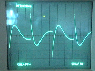

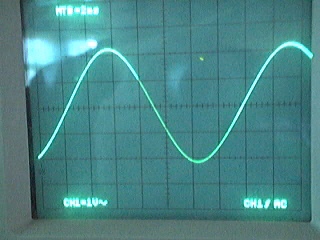

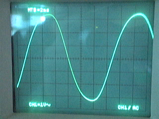

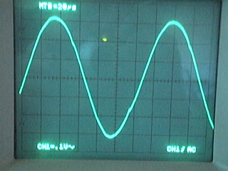

i was wrong, it was not that small peice of solder, that was the problem.... it did the same thing yesterday🙁
so i now im trying to find out what is wrong. using a scope and a signalgenerator.
one of the channels works fine, the other one do that "thing"
to fint the fault i have connected both channels input to the signal generator. i tryed to measure at the outputs, on the channel that i think is okay. it looks fine when i feed it with a sine wave.

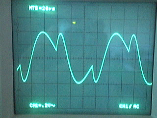

but when i try to use a triangle wave!
at high freqency (8000Hz) it looks nothing like a triangle wave more like a sine wave with a lage deformity.. at low frequensy it very hard to tell if it is a sine, triangle or square wave.. they all look almost the same 😕 that can't be the intention?? when i try a square wave at 8K Hz
Help plz

These waveforms are not right. Sine waves should never get distorted when they pass through any crossover. Forget all these fairy tales about "transient degradation". The most probable cause for that distortion is an op-amp in some filter stage clipping or driving too low an impedance. It may be also due to op-amp instability.

I mentioned earlier in this thread that my 24dB active filter distorts pulses and it do. But the sine waves are not distorted, and that’s unquestionably the most important issue. IMO transient response also has an impact on sound reproduction, but surprisingly modest.
