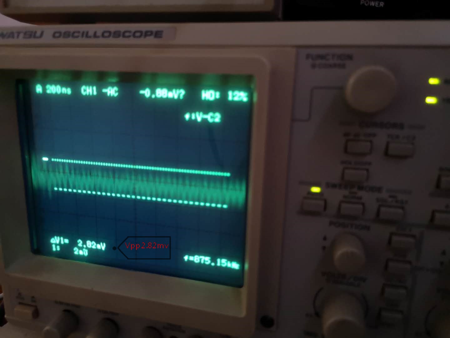

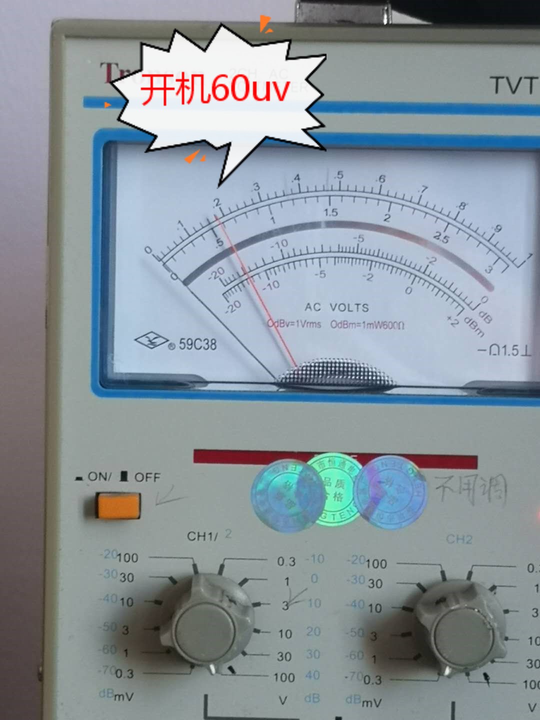

I want to measure the RMS value of the output amplifier noise voltage. Can I use a millivolt meter? How to measure accurately?
The bandwidth of a millivolt meter is 1M, and the bandwidth of an oscilloscope is 20M. Is this noise parameter good or bad?
60 µV would be fairly decent within 20 kHz, let alone 1 MHz - it is likely to be far less than that within the audible range. I wouldn't be surprised to see <20 µV or even <15 µV there. (Do you have a decent soundcard input available?) A value like that would certainly be within my expectations for the given circuit.
The scope may be showing some sort of ground loop noise. Is the amplifier
a) an IEC Class I device (mains earthed), or equipped with another kind of explicit protective earth connection (maybe a parallel RC)?
or
b) an IEC Class II device (floating), and if so, is its mains transformer equipped with a shield winding (that is actually being used) or not?
Stupid question - you do actually have mains protective earth in the lab, do you? This 75 kHz "stuff" could also be coming from the scope's very own power supply...

Because the peak-to-peak value is only 2MV, the frequency display of the oscilloscope is unreliable, and the frequency will keep jumping. Because the oscilloscope time has been adjusted to the minimum, the interference frequency is about 20MHZ. After the power amplifier is powered off, this waveform is also displayed. I do n’t know what the interference is.
