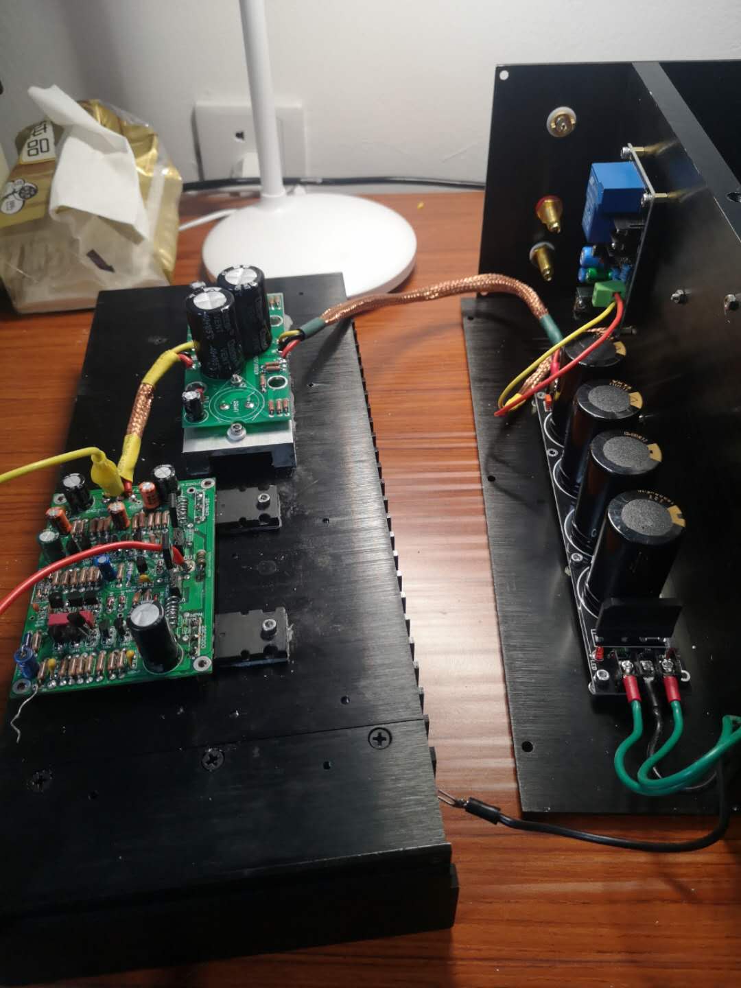

Before installing the case, I achieved this effect through a separate power amplifier circuit board test, so no volume potentiometer was connected, and I also tried listening with headphones.

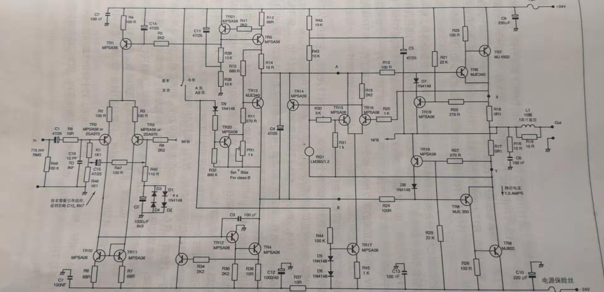

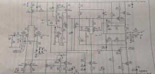

Do you mean ESI Planet 22x amplifier or is this A local DIY design or copy? How about a picture of your assembly and perhaps a schematic diagram to see how it is connected and if there may be problems.
See post #2 again. You cannot and do not use or measure amplifier noise when the input is open circuit. Either short the input direct to input ground or with a resistor of 1-47k which should approximate the load of a preamplifier or other high impedance source that is normally connected.

The left and right channels have the same parameters. I added a voltage regulator circuit. I cancelled the high current protection in the circuit.

My actual input impedance is 2.2K instead of 47K. Maybe this is the reason for reducing the noise, please see the circuit diagram provided earlier

My 2 cents:
1. An amplifier like the circuit shown should easily provide inaudible or near-inaudible noise by itself when used with normal-sensitivity passive speakers (85-90 dB SPL / W / m). Even assuming a mediocre 15 nV/√(Hz) input noise density, a gain of ~26 dB results in less than 50 µV of output noise. That's <-86 dBV, or >95 dB below 1 W / 8 ohm level. (You can employ an opamp output noise calculator for this exercise.)
2. Good call to whoever brought up R6/7, which should be more like 220 ohms. In any case, I'd be awfully surprised if input noise density on this one turned out to be much worse than 5-10 nV/√(Hz). Even horn speakers beyond the 100 dB / W / m mark should be quiet happy with this one.
3. Your big problem usually is not the power amp, but the preamp or whatever source you've got hanging at its input. A standard preamp is considered good when it reaches 3.5-4 µV of output noise - around twice the input noise of even a mediocre power amplifier! Likewise, getting down to 2 µV on a DAC output implies a dynamic range of 120 dB if 0dBFS = 2 Vrms. Feasible? Yes. Easy, common and cheap? Not so much. If you want 0.8 µV, it gets even harder with dynamic range requirements being pushed to 128 dB.
4. Issues like in 3) can usually be tackled with some passive attenuation ahead of the power amplifier, as preceding devices tend to provide (a) more level than required for amplifier clipping and (b) even the clipping point may generate substantially higher sound levels than required (few people are likely to require more than about 110 dB SPL, which with sensitive horn speakers could mean less than 10 watts!).

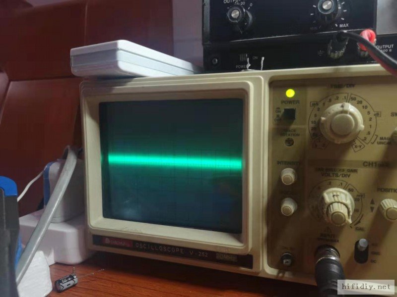

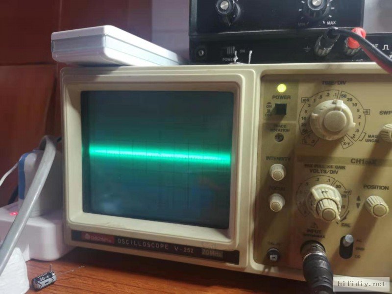

The load resistance is 8 ohms and the oscilloscope is 5MV / DIV. Power amplifiers measure at power up and power down, and they have the same amplitude. If you use this parameter, can you say that the noise during startup and shutdown is the same? Same no noise.

Measuring noise with an oscilloscope seems unreliable. Is it reliable to measure with a millivolt meter?
