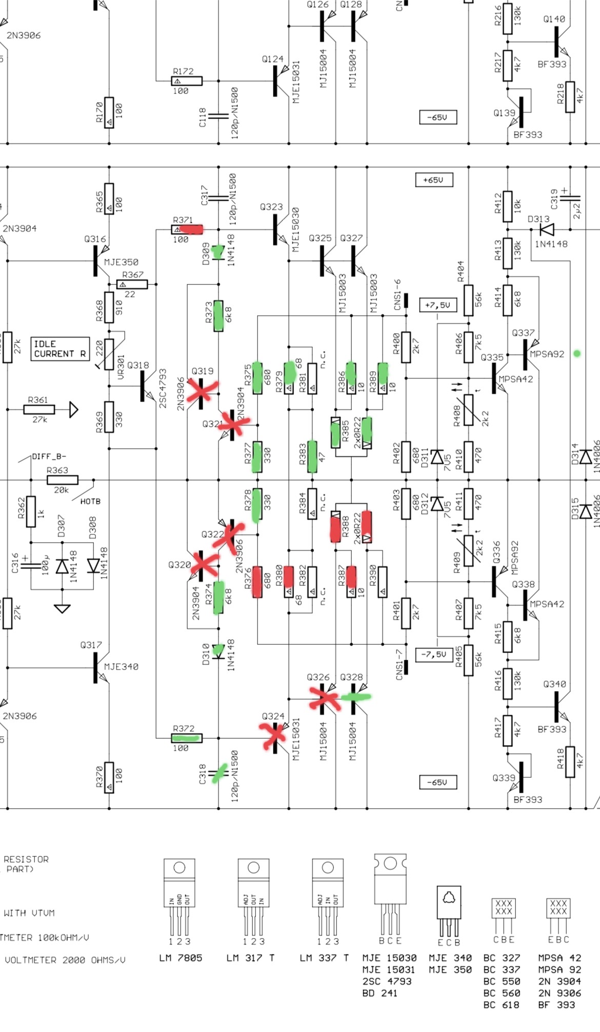

Hi All,

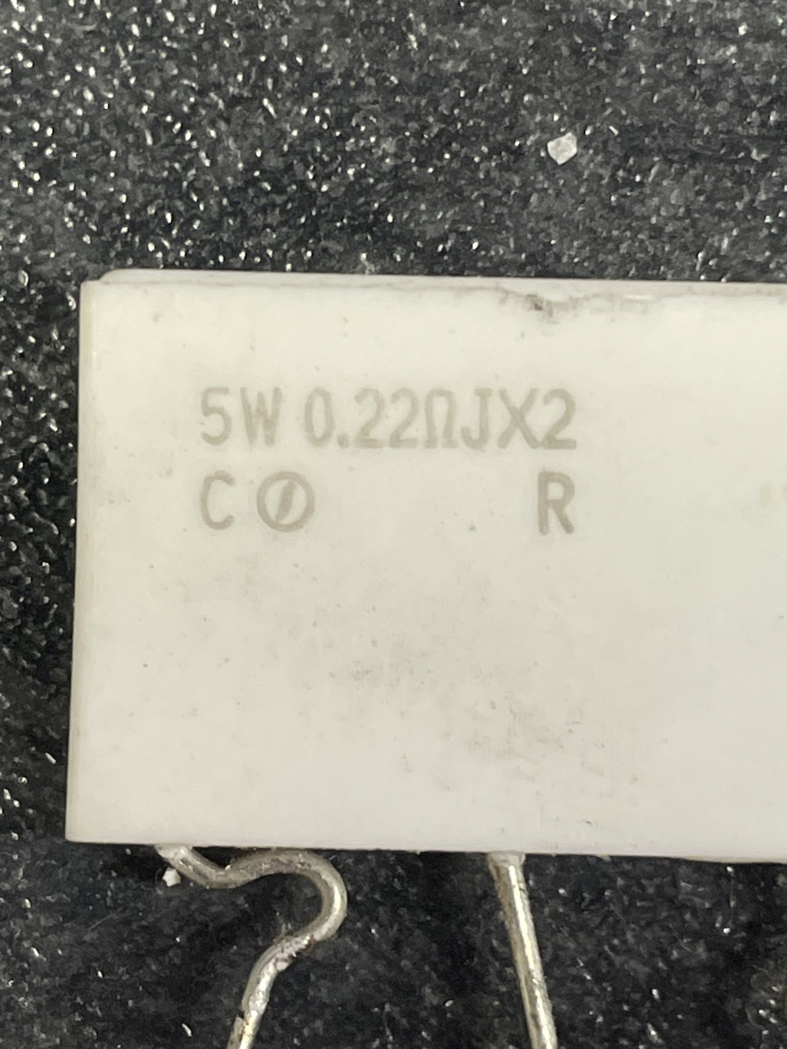

I’m looking to replace a .22R dual emitter resistor for a dynacord powermate 600 That has gone into protect mode.
1, 5w 0.22ohmn JX2
I’m Having bother finding one.
Is there a substitute I could use please?
I have confirmed 10 faulty components so far on one channel. The other channel is ok.
Thanks in advance
