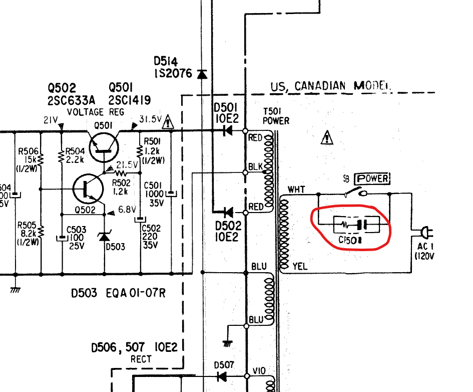

If the button is a mains switch then check and see if it has something like this across it. A capacitor like this will allow a small current to flow and that is enough to generate a very small rail voltage in the amp. You may then hear that as a click if you connect/disconnect speakers. The cap is essential to protect the switch and the behaviour is normal.
A faulty mains switch that passed a small current when off would most likely not last long and would burn and carbonise so I don't really think that is the problem.

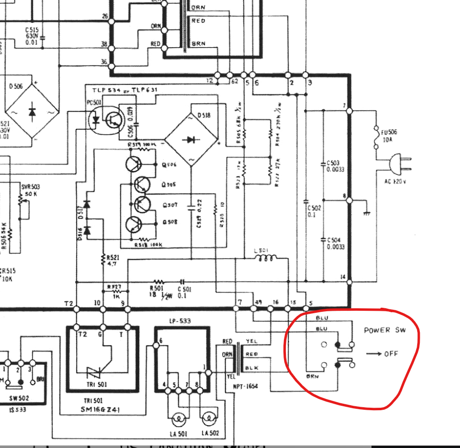

Again, without seeing a circuit diagram it is hard to say for sure. I suspect the Carver mains switch is actually not disconnect the mains fully by design like in this second image which is a Carver M500T amplifier. This is NOT a normal mains on/off circuit and the unit is still partly powered.
I would doubt you have a fault with this one 🙂

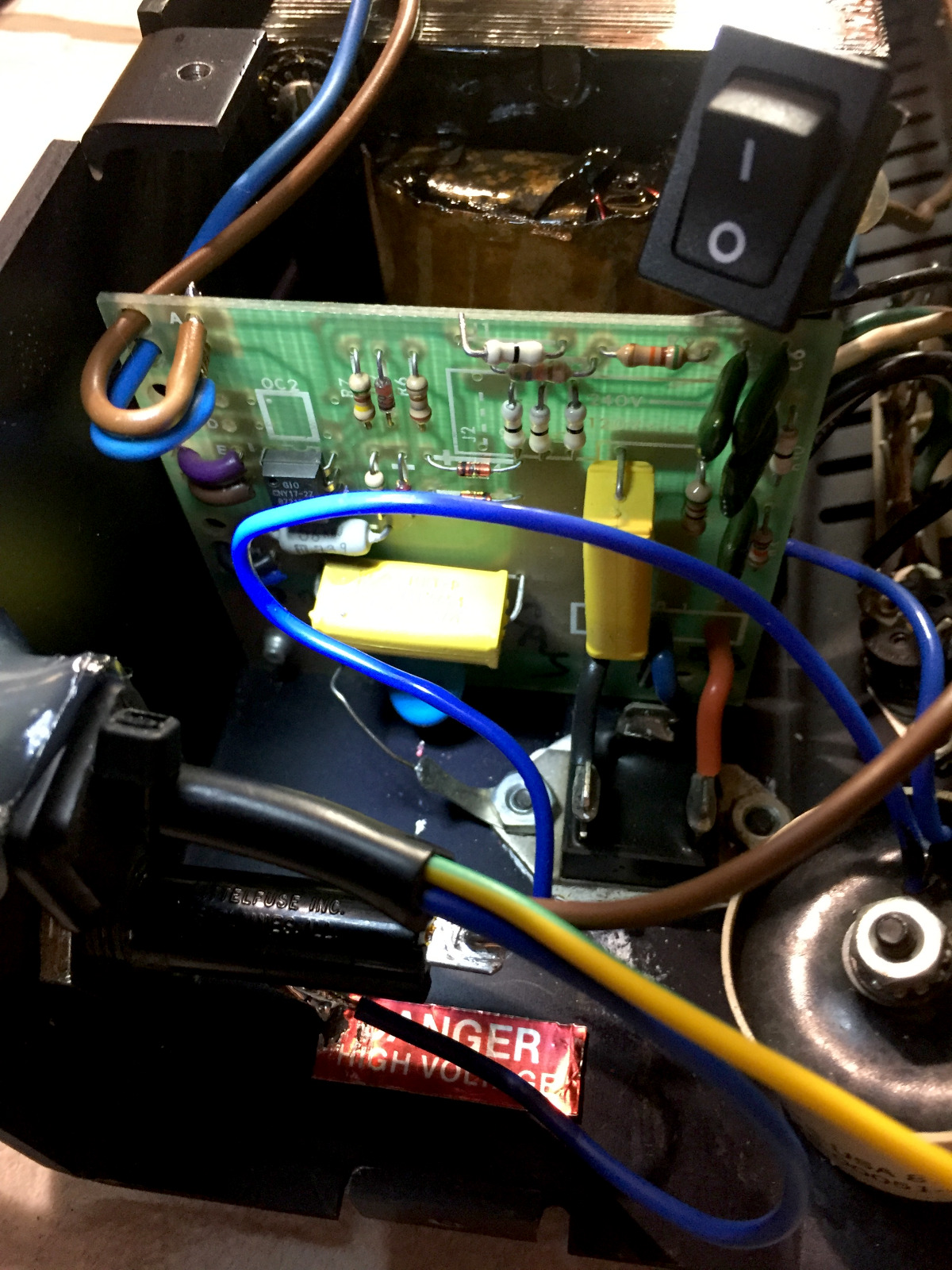

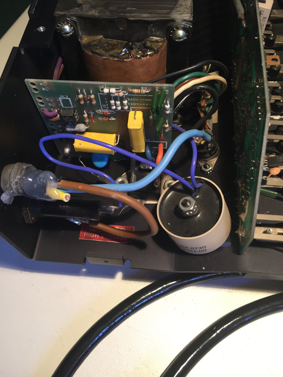

let's see... I'll summarize this Carver M 1.5t, which pushes and sounds divine. this amp was born without a button with the wire directly to the American plug. initially it was placed under a base with a switch, then I saw this modification and implemented it with the button placed on the back near the power cable.
the first pic you see the 220/230V input area, while in the second you see the two cables that go to the button, here now in the fly version because I did a first test always with the switch base ready for any eventuality.
Its not easy to follow tbh 🙂
I suppose the first question has to be did it do all this before it was modified? Also I see what looks like a cut ground wire in the first picture and an intact lead with ground in the second.

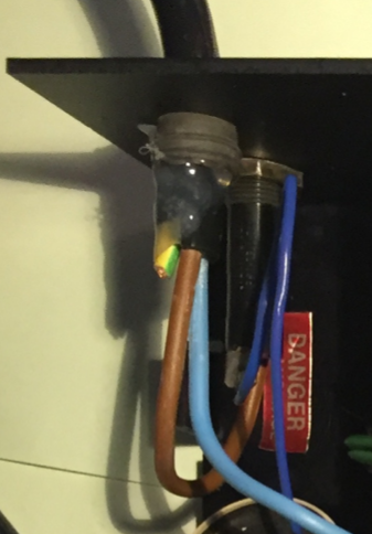

Just out of curiosity, since I'm not a technician and Mooly's experience is at least ten billions times greater than mine, I took a look at the photos you linked describing it as "the conditions of the amplifier as it arrived to me 30 years ago etc. etc." and the following is a detail of one photo
where you can clearly see the cut ground wire inside the thermal glue that seals the power cable that originally has no switch at all.
For this reason I guess that the amplifier has double insulation and does not need a ground connection.

it is not connected. the original cable with American plug had only two wires and so it was reconnected.
