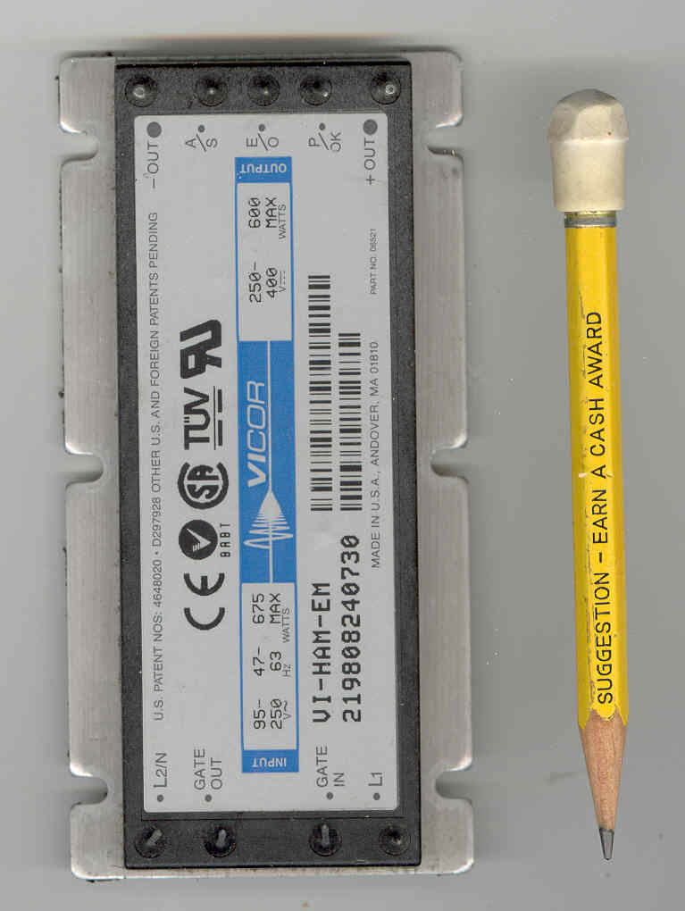

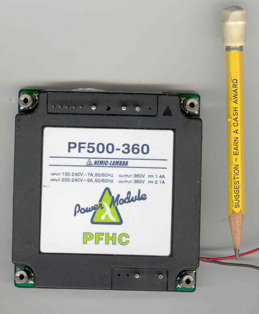

One can also get those PF (power factor) controllers to do the AC to DC task, regulated DC output. (check Ebay for cheap Lambda PF500-360, 500W 360VDC) (Vicor makes some too, I think maybe lower VDC too, maybe 270 VDC?) They are all non-isolating boost regulators, so still need the xfmr. for isolation. They typically run from 120 VAC or 240 VAC. They draw sinusoidal current off the power line. But need some shielding and caps. You may still want a DC amplified capacitor regulator (a Mosfet with RC Vref) after them to make for rock bottom DC supply impedance.
Lambda and Vicor PF module pics
(I think the Vicor one is for a post PF controller, electronic, DC filter, I couldn't find the PF part off hand here, but it's the same size)
Oh,
that IS the Vicor PF controller module pictured above right, the active DC filter module is half as long (confusingly also called HAM for harmonic attenuator module). Looks like it does anywhere from 250VDC to 400VDC regulated output. (an external adjust pot.) These PF controllers were from around 10 or 15 years ago, so probably newer models are out by now. But these are the ones likely to be found on Ebay for cheap.
