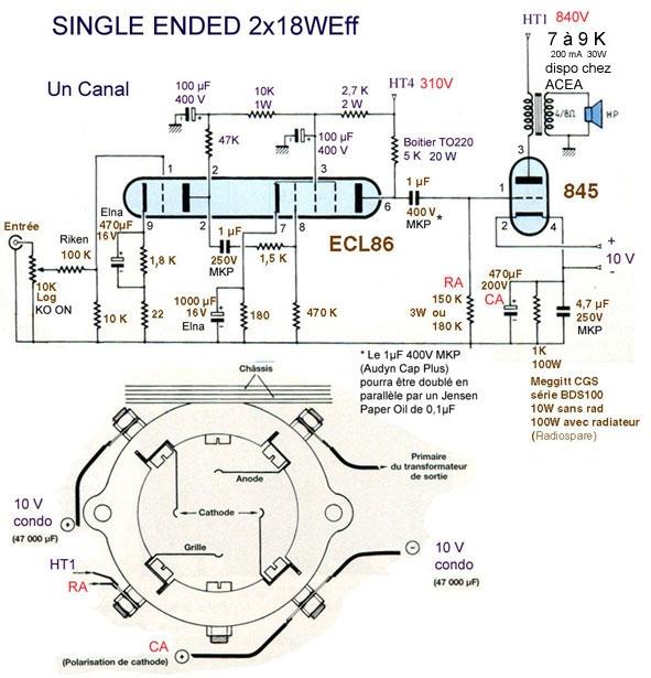

Can someone let me know if I can replace the 211 tube with GM70 type?
I know I can replace 845 with GM70 if I adjust the heater voltage. GM70 use 20V for filament.
I have a nice 211 schematic "Goliath" but I want to use GM70 power tubes.
Greetings gabor

Yes that is the schematic. I know these tube hard to drive..
Many people drive the GM70 with D3a tube. Get about 17-20W power.
Here not tha D3a tube is the drive of the GM70??
Thanks one more time.
Greetings gabor

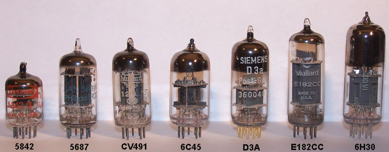

There are many design with 2 stage with out inter stage transformer. Some people say the D3a would be the best choice.
Many of these tubes have a plate resistance
about 2Kohm but only the D3A and 6C45
have an amplification factor greater than 50
D3A specifications in triode connection
filament voltage: 6.3V
filament current: 315mA
Max plate voltage: 200v
Max plate dissipation: 4.2w
Max cathode current: 33mA
Plate resistance: 1.9Kohm
Amplification factor: : 77
Max resistance in grid circuit: 0.5Mohm
6C45 specifications:
filament current: 440mA
Max plate voltage: 150v <<<<< it is lower than D3a
Max plate dissipation: 7.8w
Max cathode current: 52mA
Plate resistance: 1.2Kohm
Amplification factor: 52 ±16 <<<<< selection is necessary
Max resistance in grid circuit: 0.15Mohm
Inter electrode capacitance:
input: 11±2 pF
output: 1.9±0.3 pF
transfer: 4.5pF
Greetings

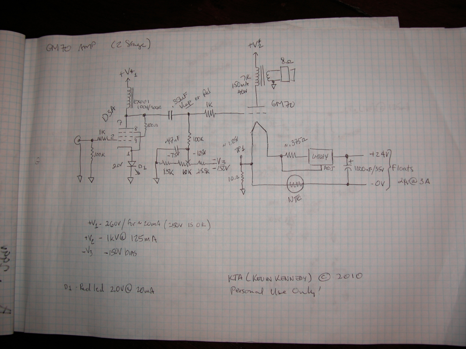

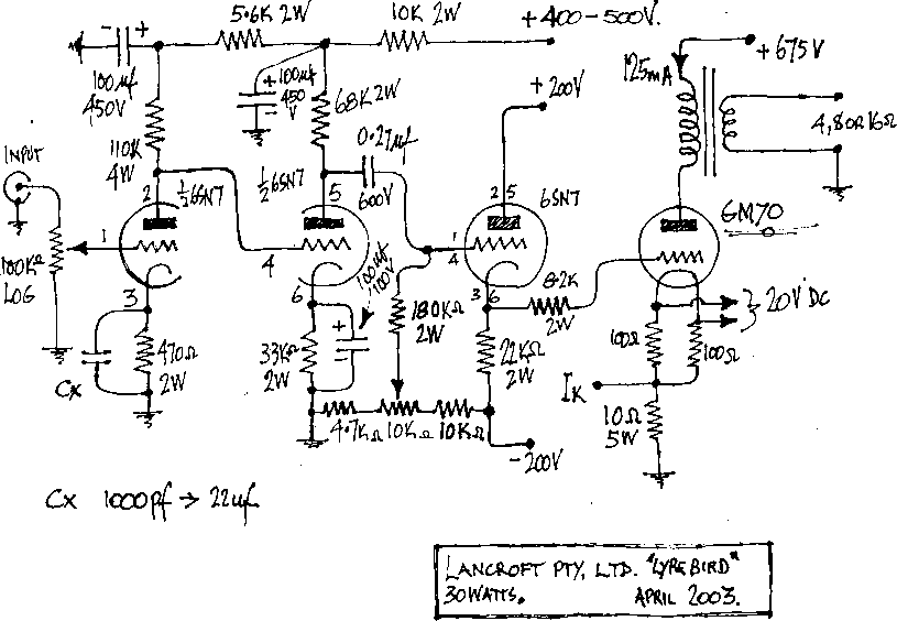

Al do I have several schematic based on two stage design!
Here is one design by Andrea Ciuffoli
845 Amplifier with only two stages
Only problem the 100H choke have to be special low resistance.
I attach other two stage design at the next post, but I'll go with 3 stage now!

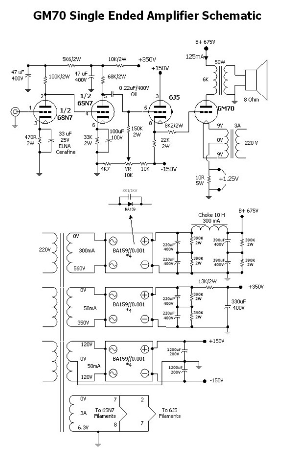

For these circuit 6SN7 & 6J5 I ordered the tubes and sockets.
I try to build these, all do these need at least 3 or 4 power transformer🙄
I will attach at the next post some 2 stage working design!
Greetings gabor

Hello
Here are some 2 stage design
The third schematic here!
http://www.goodsoundclub.com/pdf/6E5P_Swedish.pdf
One of the derived by D3A tube at the attachment.

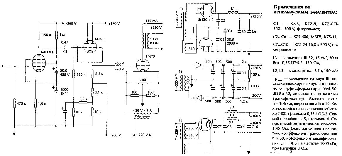

These is another design
Nicholas' GM70 SE Amp There are more schematic but I do not want to dump all those here....
Any way I try first the 3 stage with 6SN7 & 6J5 tubes. Only problem I have with that design the low plate voltage.
I would like to go with 900V on the plate and a bit less bias.
In case if these design does not work out for me I do not want to buy another power transformer.😱
Greetings gabor
