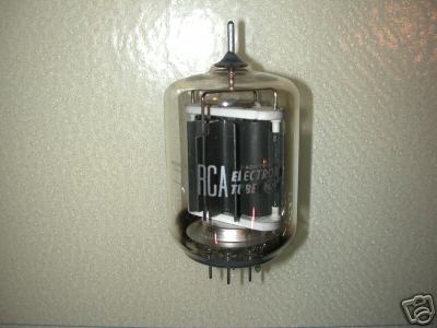

fdegrove said:To save you from the disappointment why not sell them, they catch a good deal of cash, and make something with readily available cr*p....
Completely useless, send to me for disposal. 😀
Tim
That isn't a 211. It has what appears to be a septar base and an anode pin. It's probably some sort of RF tetrode.
