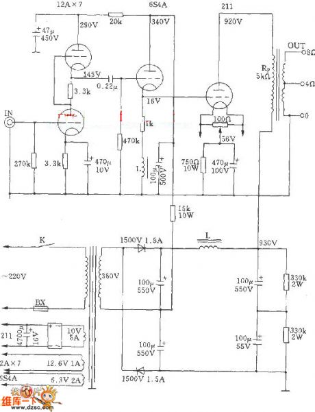

Here's another schematic I found regarding the 211. It looks a lot more similar to Mingda, also a direct connected cathode follower. The grid of the 211 has positive grid voltage but the 750R cathode resistor lifts the cathode's potential to around 56V so the grid is minus ~40V compared to the cathode.
I think the grid voltage is around ~15-20V also in Mingdas, at least in the same ballpark. But there is very small cathode resistor for the 805 that does not rise cathodes potential so the grid stays positive compared to the cathode. I have to receive them first in order to be able to measure.
Maybe I could rise the cathode's potential compared to the grid also in the Mingdas just by using different cathode resistos for different tubes. For example ~1800R for 845 and ~750R for the 211.

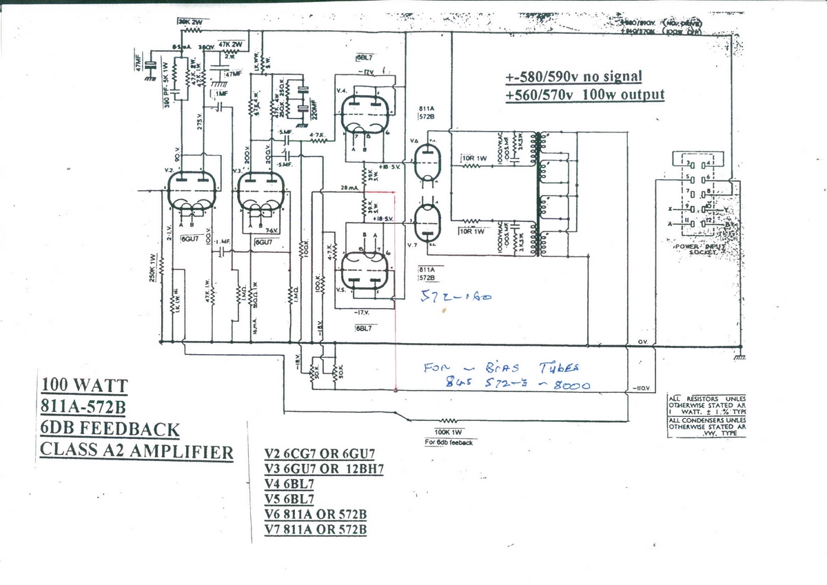

You need to change the bias circuit from + to -; I have just done this in a push pull circuit.from 805 to 8000 similar to 211 Mu of 16.5. The 8000 needed only 12 volts - bias at 650 volts

Legis, If I be you I would like to built a 2 in to 1 amp with the wonderful 572-B tube:
Its works with B+500V to 3W and 900V to 20W.
It would be nice to have a 3W and a 20W amp in the same chassis.

805 572b 811 chnage for negative bias
The 572-3 is now very expensive have not been made for many years; they are a 572-160 with the grids wound to produce a tube similar to the 845, with 6.3volt heaters.
The Pp circuit shows how to change from + Bias to - Bias. Instead of the cathode resistors going to earth + bias; for negative go back to the output of the bias supply.

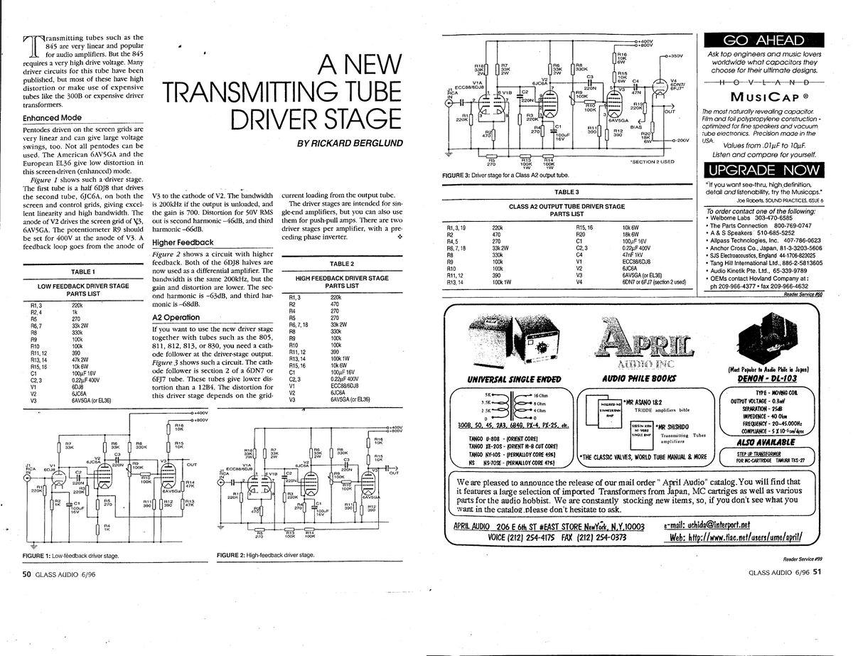

The 845 worked OK in the MC3008-A circuit with a 1477R cathode resistor, which lifted the cathode ~133 volts meaning the +24V grid is approx. -110V compared to the cathode. Anode voltage is ~940-950V so the tube had ~810-820V across it. Bias was approx 91mA with this cathode resistor.
But the problem was low output power because of the low operating point the first tube, the 12AX7, which has only 63V across the tube and 1,6mA bias. It has been set for the original circuit and input sensitivity to give very long tube life propably.
At first the output with 845 tube was limited to ~3,5Vrms because the input tube 12AX7 was clipping. Then I lowered the 150k anode resistor of the 12AX7 to ~70k, which raised the voltage accros the it to ~103V and the bias was also raised to ~2,6mA. With this setup I could get almost 5V before the 12AX7 clipped, meaning almost 3dB more juice. I will have to continue testing and raise the operating point higher still.
FYI: the next tube, 12AU7, has ~150V across it and the driver tube 300B has ~370V across it. I did not make notes of their bias. They might be up for the task to drive the unsensitive 845, but the first tube needs a higher operating point definitely for the 845. 211 has 6dB higher gain than 845 so it's easier to drive.
