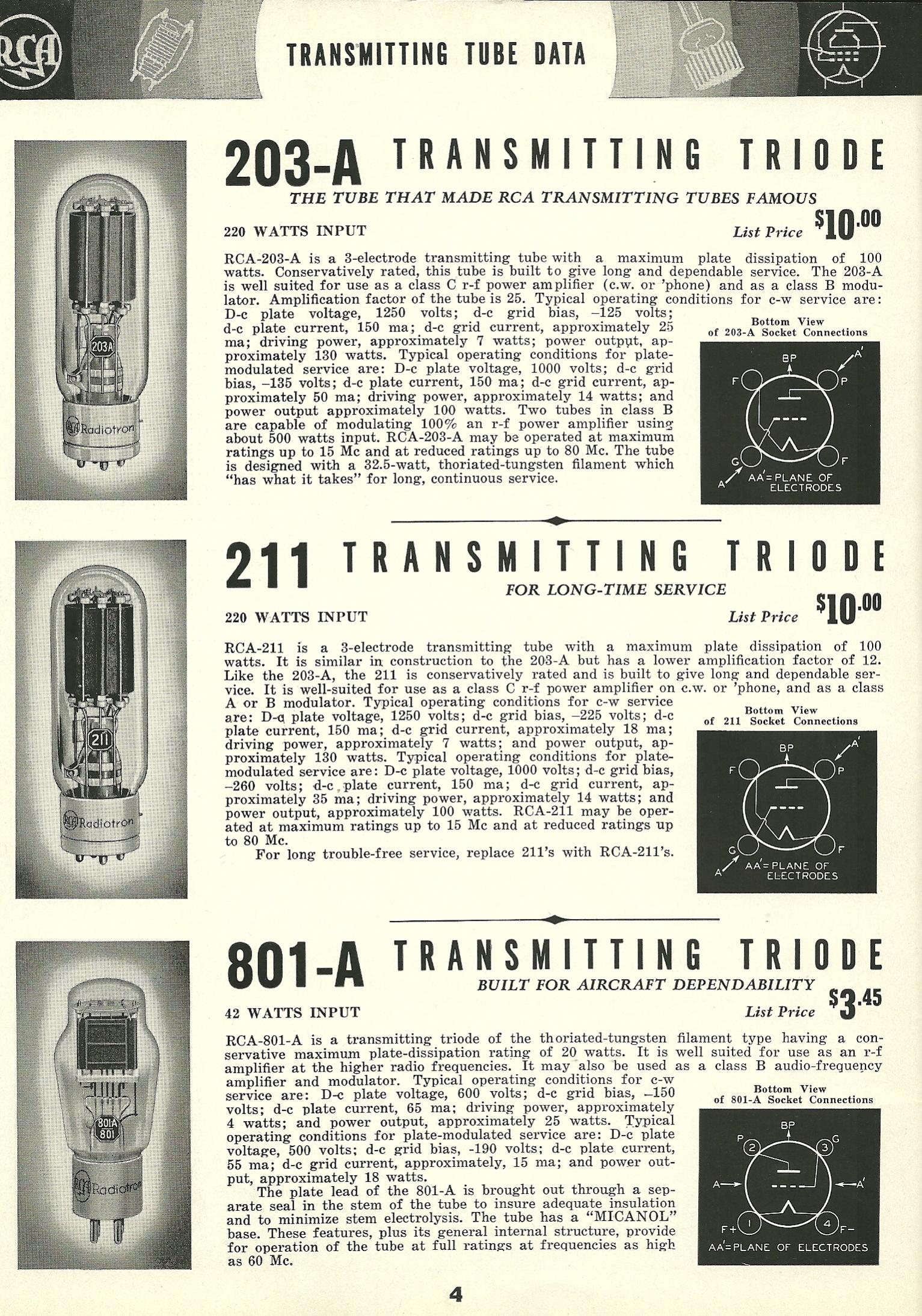

I wrote to Jack Elliano (Electra-Print) recently. In his 211 A2 amp, he runs the triodes near 100mA plate dissipation. Since the datasheets I saw indicate 75W, I asked...
Q About your A2 amp, I'm surprised to see 100W of plate dissipation. On GE datasheet, 75W is indicated for class A (but I know some versions are 100W like 211C or something).
R RCA transmitting tube manual says, 100 watts. GE was mostly TV tubes and got in the habit of rating lower to increase reliability, guess it carried on to these also. No matter, just watch for red plate. If you use a blower on them, they will go to 150 watts. We have been an Amateur Radio operator since the 1950’s so this is common practice for us.
All power triodes work best at near or full plate dissipation, this is the only way to achieve A2, if you check, A2 was called “extreme class A” back in the 1940’s.
Jack is right.

75W!
RCA manual clearly states 75W max plate dissipation for Class A:
http://frank.pocnet.net/sheets/049/2/211.pdf
If you want the tubes to last, stay with 75W!
Thomas
That's what it claims all right. Be best to keep the Pd to 75W. 100W won't sound all that much louder anyway, and the 211's will last longer if not pushed so hard. That 100W looks like an ICAS rating, or an intermittent rating for Class AB/B/C for operation that's not "brick on the key" service.
