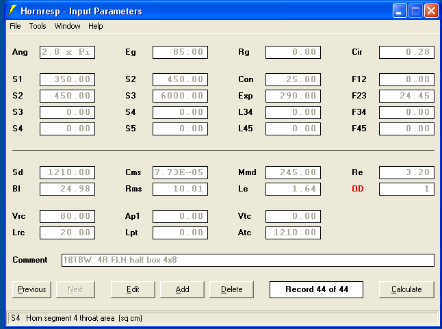

One driver per cab. Two 18's (4 ohm) or one 21 (8 ohm) on a CA18 or QSC5050. Two 18's in even a 28" wide cab is "too much driver". If the driver and box aren't matched properly, the efficiency suffers. You get the same SPL, but with a lower input impedance. Higher Z means less heat in the motors and amps. There's no point to going front loaded unless you can take advantage of the efficiency boost. If you don't, TH is just as good - and better if you undersize. I have simmed the simple prototypes (offset driver with exponential flare) with 18's and 21's and the results look promising. I've narrowed down the box sizes, path length, mouth and throat which work best in both form factors. The necessary volume is there (700 or 900 liters), so it should be a matter of getting the flare close enough so that at 30-80 Hz the differences don't matter.

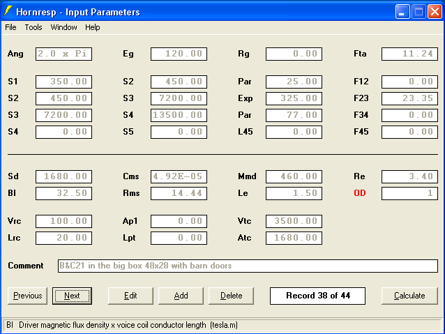

Her's a sim for the B&C 21. 48x48x29.5 external and makes good use of 4x8 wood (sim wants 904 liters without the flare extension, this should be enough). Note the main flare is just exponential - but if the approximation in 4 segments is good, it should turn out reasonable. I have it as an OD, because that's how I would build it. Try it with and without the last segment, in 2 to 8 boxes, with the B&C and the PD drivers. I have a similar one for an 18, just cuts the width down by 4" (but is even more wood-efficient with all the internal panels at 24"). oops, first one is wrong screen shot for a 21.

Again, the sketch in Post 19 is conceptual. The exact locations of the internal panels are still to be worked out. The idea is to move the endpoints of those 5 segments around until it reasonbly approximates the second (exponential) segment of the Hornresp sim. The path length I get is within a couple inches, and even taking internal panels and bracing (expect to lose 1.5" of width and 1.5-2" of depth) into account there is enough volume to do the job. It's just a matter of bending it till it fits. If you just threw it together, it would probably "work", but will certainly work best when the expansion is right. These FLHs, when stacked, are not THAT sensitive to the flare being exact. But if you cut down the volume or lose length is when you run into problems. A single lab horn pretty well sucks, two is useable, and at 8 all the 'wonkines' is just flat gone.

wgski, your sim on this page is confusing to me..... that is a *massive* mouth. even in a stack of 6 it doesnt really dig below 40hz...
....that is a *massive* mouth.
The conclusion I've come to is that if you want a real 30Hz, you're just not going to fit it all inside the box. Sure you can build a little TH that's flat to 30... at 90dB/W. I want 100, dammit.😀 And keeping it all in the 4x4 form factor results in 20+ mm excursion requirements at 30 Hz.
