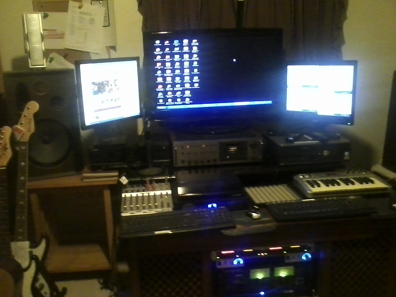

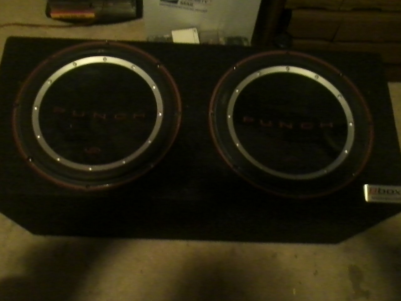

Thanks for the dimensions for this project! I think I'll give it a try and let you know how it turns out. I'm currently using twin 12" Rockfordfosgate P1S412 in an enclosure from the specs of the PDF file I got from them. I'm not happy with them at all...I'm pushing 1000 watts wired in Parallel while it is a dual enclosure each side is 14H x 18W x 10D inches for an internal size of
1.02 Cu ft Vb, F3 of 43 HZ...at least that's the specs they gave me. My Satellites for my system are some old school 12 Inch 3 way Utahs that I've modified by just changing the midranges to some nice 4 inch paper cone mids and some nice 3 way crossovers. The Utah's are very nice and smooth as silk. Powered by a Carver Receiver for the front and a couple of class D amps for the center with a nice walnut converted 1970's HI-FI with dual coaxial speakers for the front. and rear speakers. All of this is ran by my dell computer with a PCI Soundblaster PCI card that I have a nice project studio to do church music on and listen to (Plus some old classic rock) Biggest problem not enough bottom end! When I went to the vendor I bought the Midranges and saw that they carried 21" woofers I thought, YES! I'll sell my old dual 12 in Boat anchor and get 2 of these with seperate enclosers...But being an amatuer at speaker box building what size. Thanks for your post! It's easy and to the point! I'll keep you posted on my Old School meet's high end with some pic's when I get done!

These drivers and the cab recommendations are for a mobile audio app. For HT sub duty, each driver needs at least 2.88 ft^3 and preferably more, though they still won't be all that loud unless a relatively large 6.35 ft^3 [or more] vented alignment tuned to 20 Hz or less is used.

So If I were to put these subs that I have right now into much larger cabinets I would get the sound I seek?
I'd say there's a good chance you could redesign something that requires a larger cabinet but provides more output. If that's a sealed box, almost definitely. Ported boxes have much better output capability.
Cars tend to offer pretty huge gain at low frequencies. A lot of car audio boxes depend on that fact and are really pretty anemic down low. As soon as you take it out of a car it's gonna sound a lot less impressive. That could be exactly what you're experiencing.
Here's a quick design. Try this out in hornresp. The port does not need to be that ridiculously large but just wanted to show you can get a pretty nice response out of those drivers if you wanted to without buying anything more.
Well, you didn't provide any specific performance goals, I just pointed out that these RF drivers want to 'feel' large vented cabs tuned low to get the most gain BW out of them, which in theory will be near/at THX reference in room if up against a sturdy wall and maybe even exceed it a little if corner loaded.
