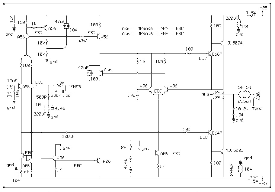

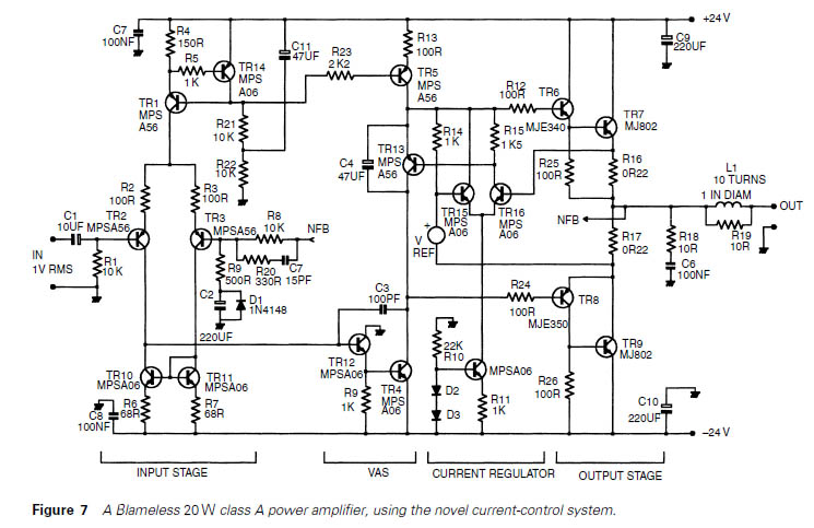

I have adapted the silicon chip amp to save some time as I am building a few speaker enclosures at the moment.
These class A (or A/B) amps are pretty simple, in terms of their build and I would suggest it is a good place for a beginner to get started into solid state amps. Buy a kit from a reputable supplier and stick the bits into the holes - you wont be dissapointed if you follow the instructions supplied.
Design concepts are another thing altogether, and the SC amp bears little resemblance to the previously posted schematic - however I guess that the component count would be smaller on the SC than the Douglas Self original.
The board that I have cooked up is almost the same as the SC job with the exception of the output filter and power resistors, but so far so good.

With reference to (4) I guess you mean mV offset which, of course, you can null by matching Vbe of the input pair and (according to some) this will improve the sound and add 20 years to your life as well. Just how you improve on vanishingly low distortion has me more than a bit puzzled but there you go.
What rail voltage do you have there? 24V or so?
