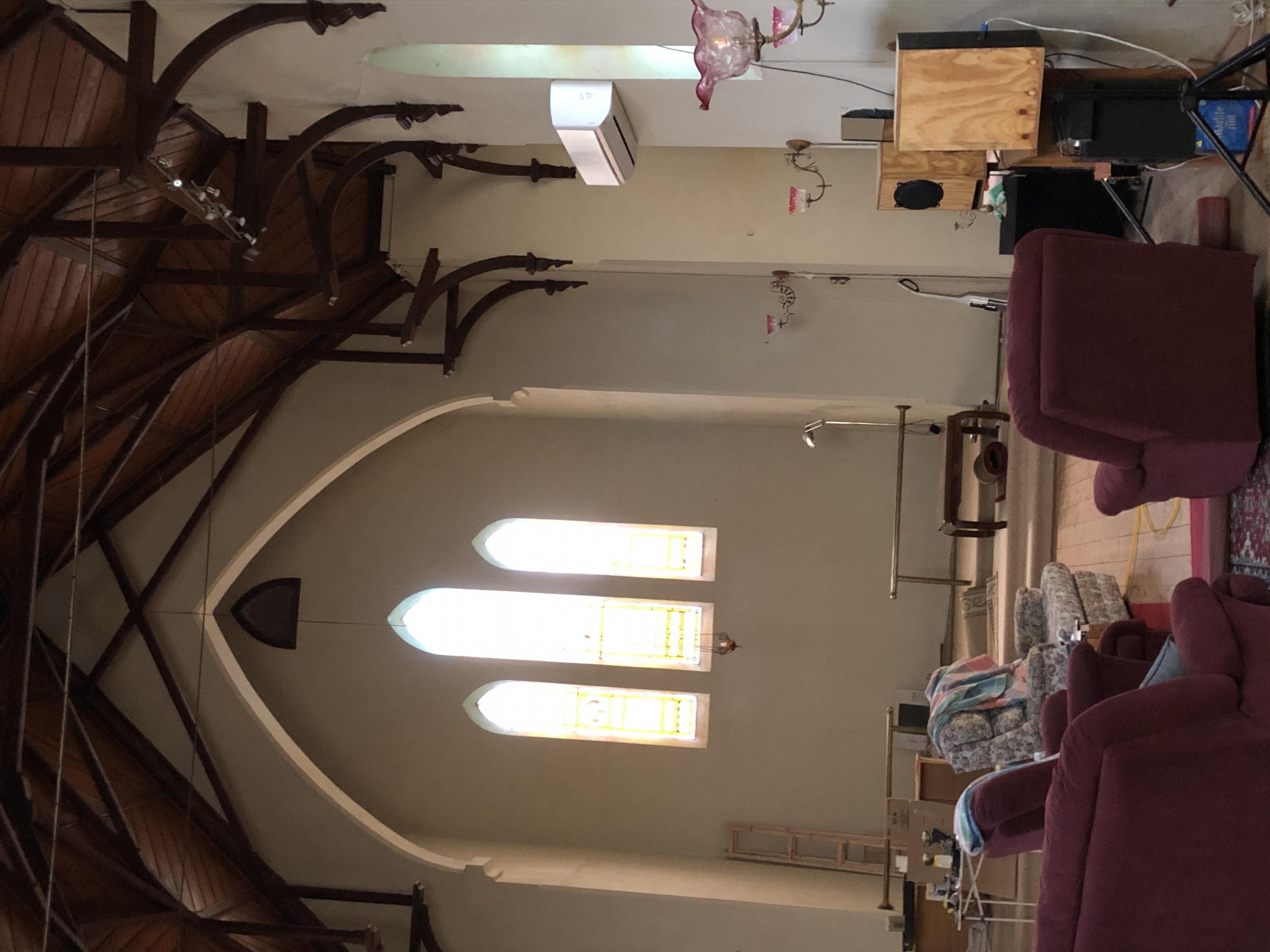

So for reasons that defy logical explanation, the wife and I would up owning a 130 year old, gothic revival church. This would normally have little to do with a 20Hz horn loaded sub, except that we are toying with the idea of living there.
The church itself is about 60 feet long and 20 feet wide, with transepts off to the sides of the altar that are about 6 feet deep and 11 feet wide.

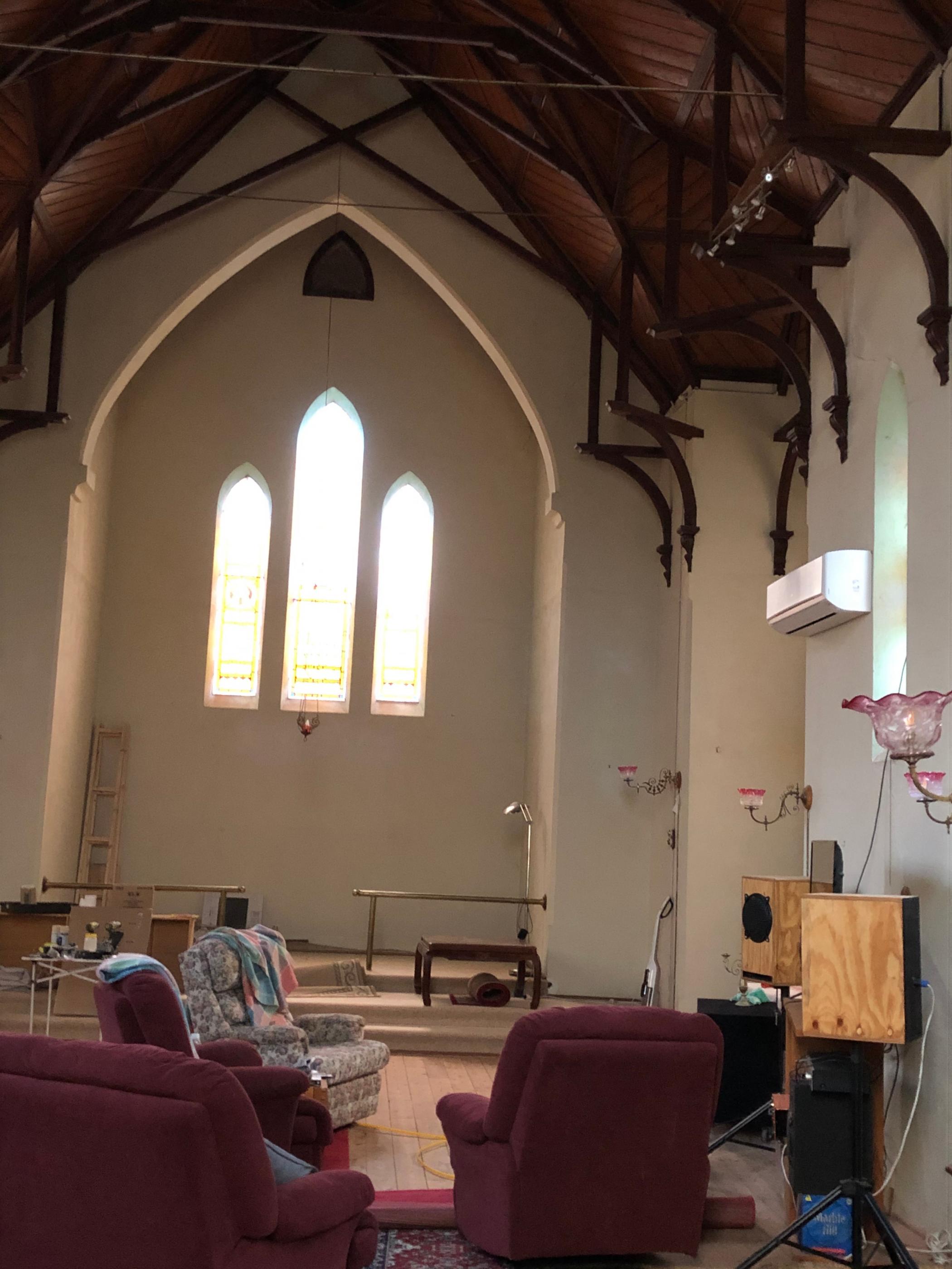

One of the big challenges is that the celing height is over 30 feet at the peak. This is one huge volume of a room. And also an impressivbe one at that!
The transept that the "workbench" AKA dual horn loaded sub goes into is off to the left in this pic.
The sheer volume of the place sets a challenge in providing solid bass. At the same time this provides a few opportunities to build a speaker like I will never have the chance to do again.
The bulk of the hall is a pretty massive living room, and when at the church, my hobby desk is in one of the transepts. The Wife has given permission for me to adapt this as a "workbench". Yes, she knows there is a cunning plan to make this a giant sub.

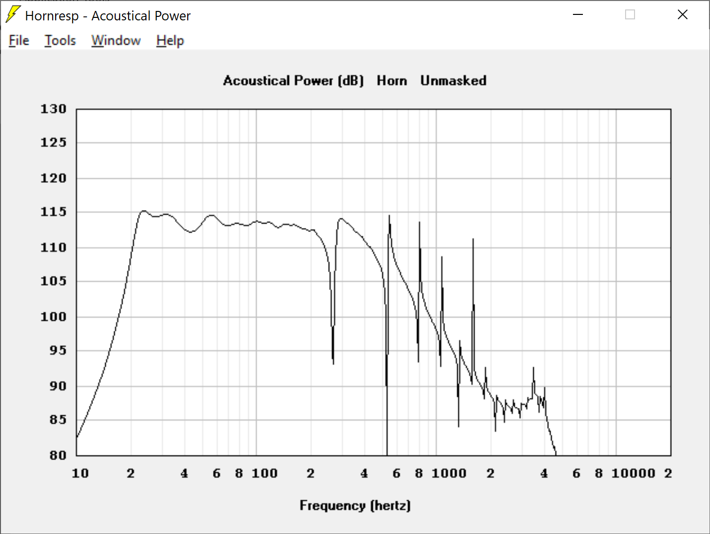

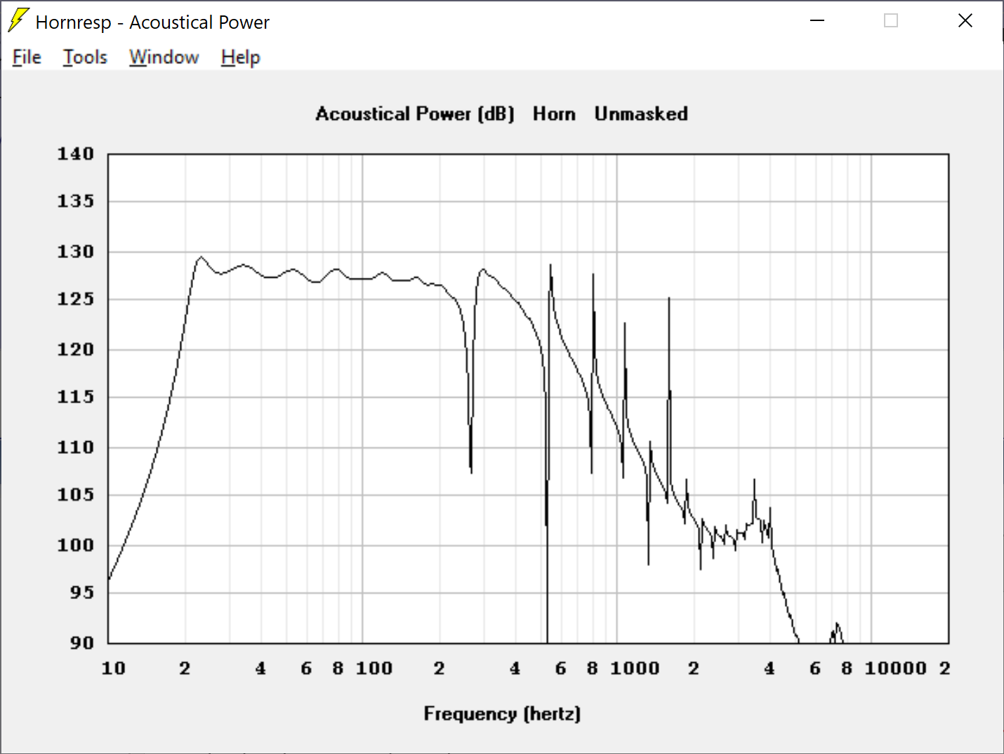

What are drivers? The model is pretty insensitive to the drivers. I gave four old school Richard Allan HD15 drivers. Two per sub (there are reasons why I did this....) works a treat. Dropping in for example an JBL2226 gives better results, if the difference actually matters.
Looing at the response using the Richard Allan drivers... with no effort to make the plot look pretty...
This includes the path length from the mouth of the horn through to the transept and up into the hall.
And this is for 2.83V into 8 Ohms. Which is 2W per box, or four watts total input. Just goes to show the power of horn loading🙂

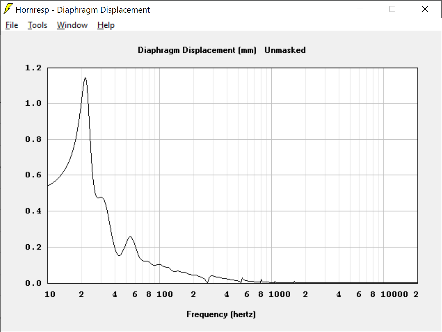

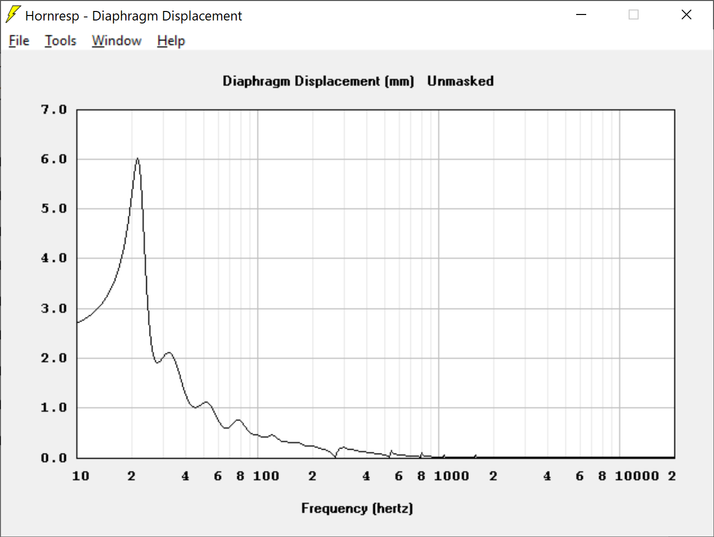

So what is the cone excursion like at 115dB?
This says that at 2.83V input, and close on 115dB output right down close to 20Hz, the cone excursion peaks at 1.1mm. Even witht he old school Richard Allan drivers, which I would rate to +/- 4mm or so in a "near engh to linear" region, there is miles of excursion to go. 50 watts per driver and things will be getting rather loud in the hall...

50W into this thing will deliver 127dB and cone excursion peaking at 6mm at 20Hz, and falling rapidly with frequency.
Below is the predicted SPL at 50W into 4 Ohms i.e. 14VRMS.
And the cone excursion doing this:
This is worlds apart from a conventional ported sub. I know, I have built dozens of the things. The obvious price being that this consumes about 6 cubic metres.
Acoustics in the hall
Will be far from ideal. Originally the hall was full of pews (and pigeon poo). It was reverberant in a way that might sound cool for a church service, but did not bode well for music.
We now have a load of carpets - in fact several loads of them - and a lot of big recliner chairs and lounge suite. Plus a bed. This has damped the reverberation somewhat, but it will never be ideal. There will obviously be some long delays in the timing of reverb...

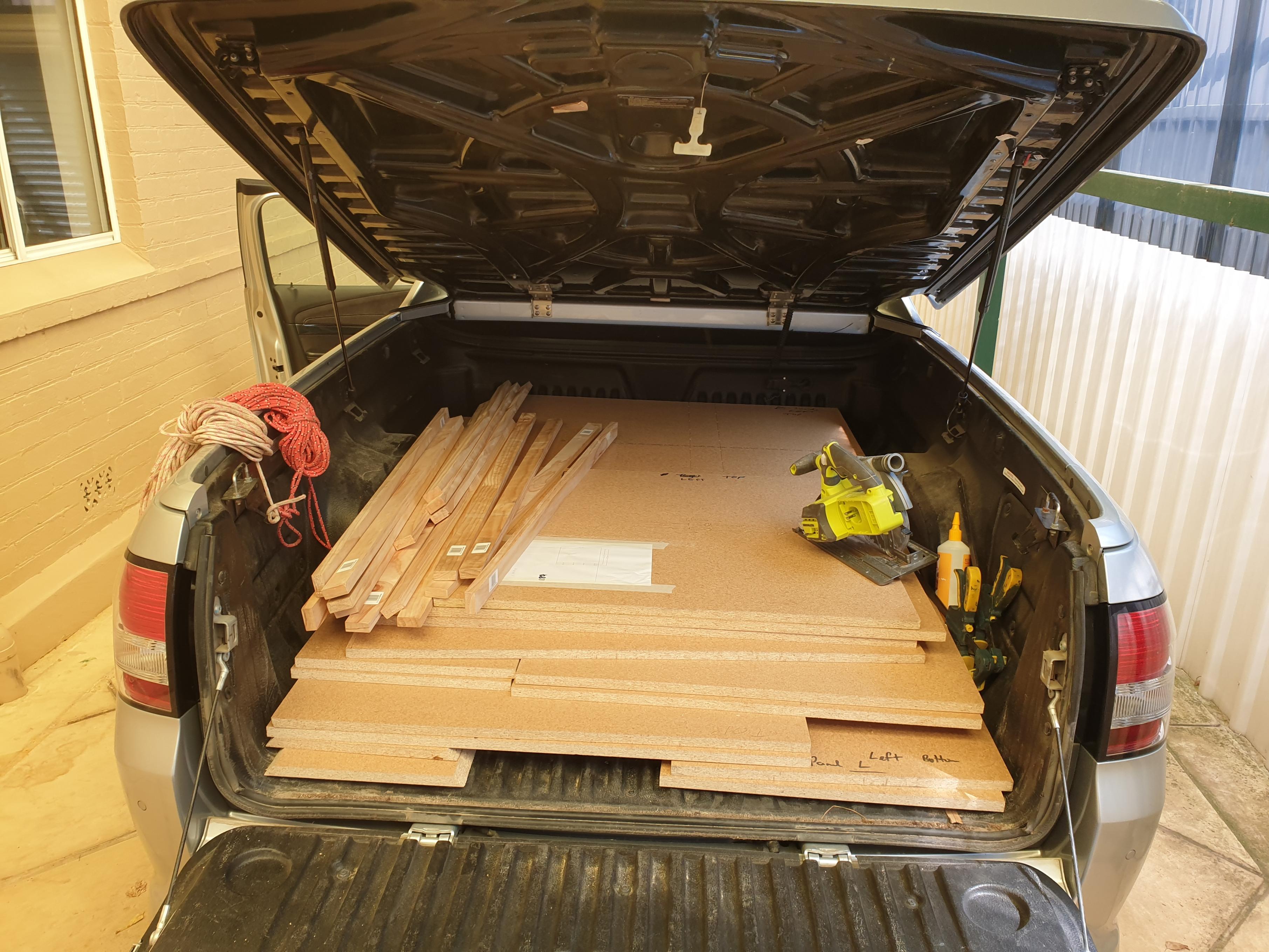

Well the timber is bought and prepped. There is a metric shitload of it!
It also weighs, well lots.
Five sheets of structafloor = 200kg plus Two sheets of MDF = 80kg. There are very few offcuts, but I imagine there is 10 or 20kg of dust in the back yard now🙂

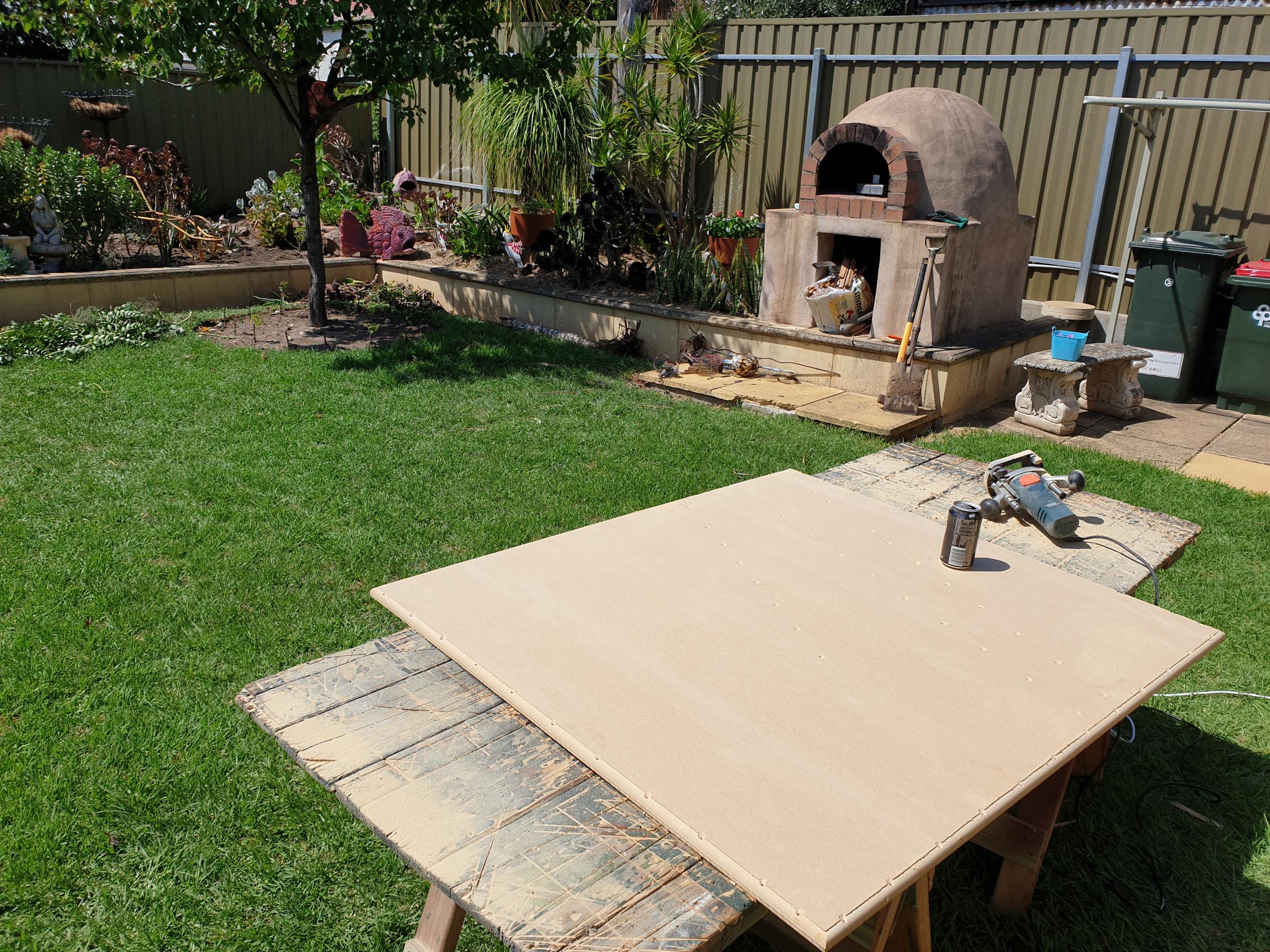

I got the local hardware store to do the worst of the cuts, but they will only cut right angles. It was up to me to deal with all the angled cuts. That's fine as I enjoy getting out with the power tools.
That is the top of one of the main sub boxes in the pic. The main subs are 1038mm deep by 1179mm wide. They will be 836mm tall.
This does lead to some ungainly panels to move around, and once built the carcasses will weight close on 140kg plus drivers. Plus about 200 screws🙂

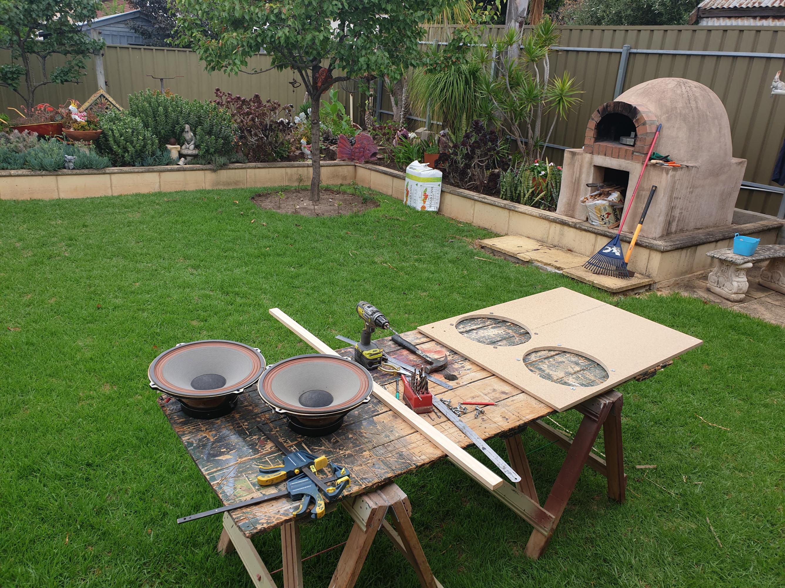

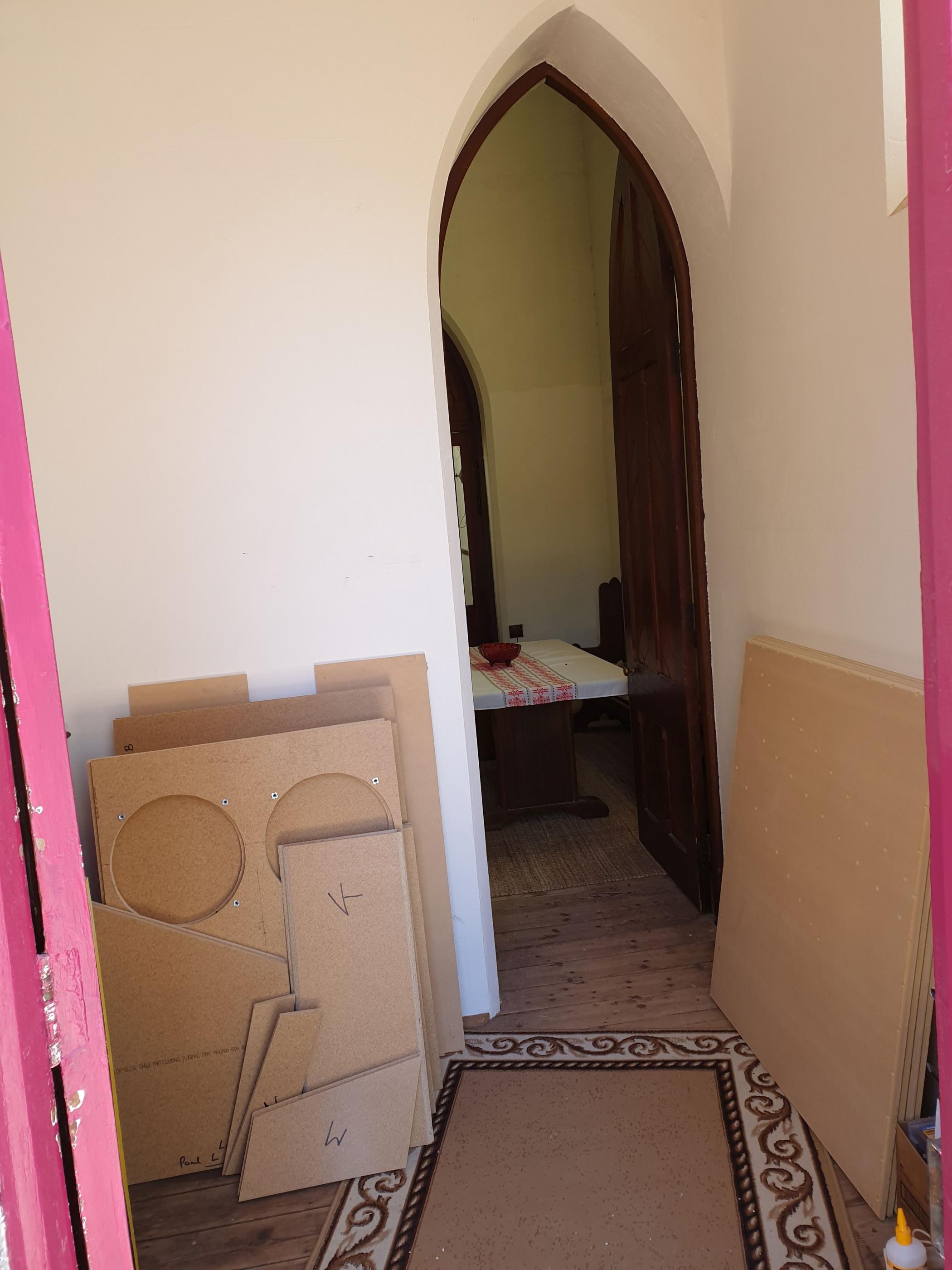

Because we dont live at the church all the time, my tools there are really focussed on the building and maintenance work we have been doing. For that reason I have done ALL the cutting, drilling and prep work at home in Adelaide and have driven the wood up here.
That went as far as installing the captive nuts for mounting the drivers.
As an engineer I suffer that dangerous mix of reliance on CAD tools and trust in the design. In this case it is essential, as just hacking out these boxes would never fly. The difference here is that at work I have a team of OCD type people to check my work before it goes into build.
I have to say that I have drunk a lot of coffee and stared at the drawings for a few hours - as I do not want a quarter of a ton white elephant at the end of this! (let alone the dollar value of wood).

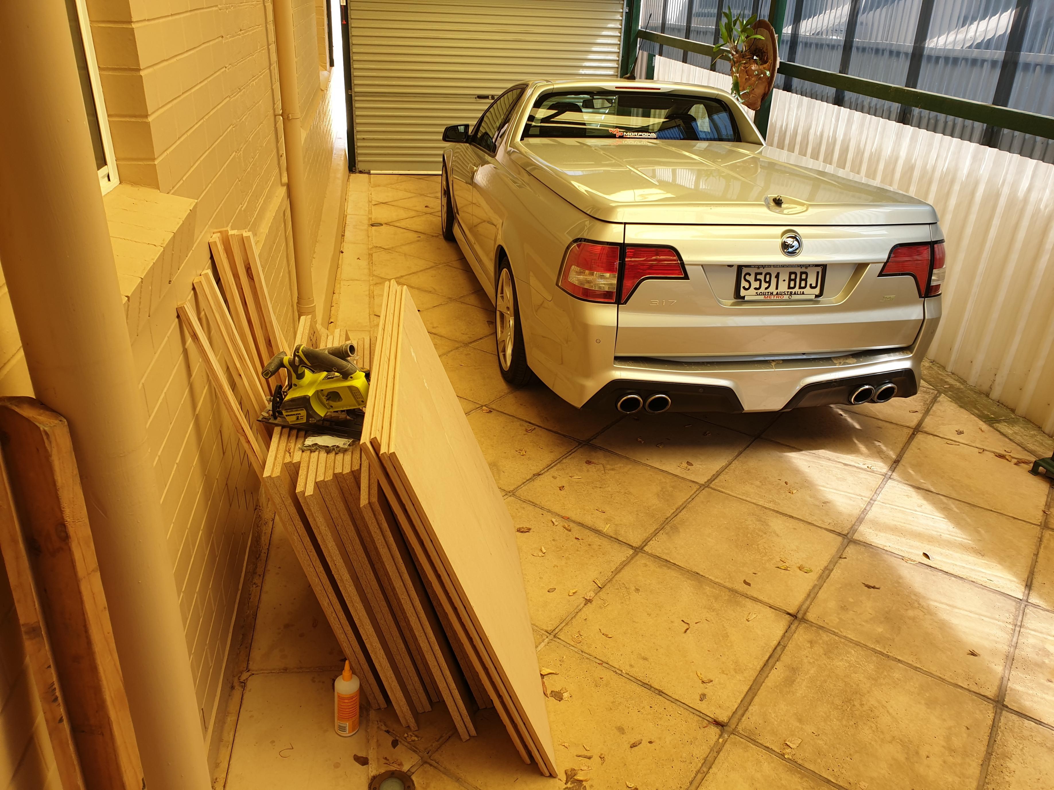

This timber I reckon half filled the tray of the ute.
Well at least this lot holds the back tyres to the ground well! (Any Aussie reading this who owns this sort of car will sympathise with this!)

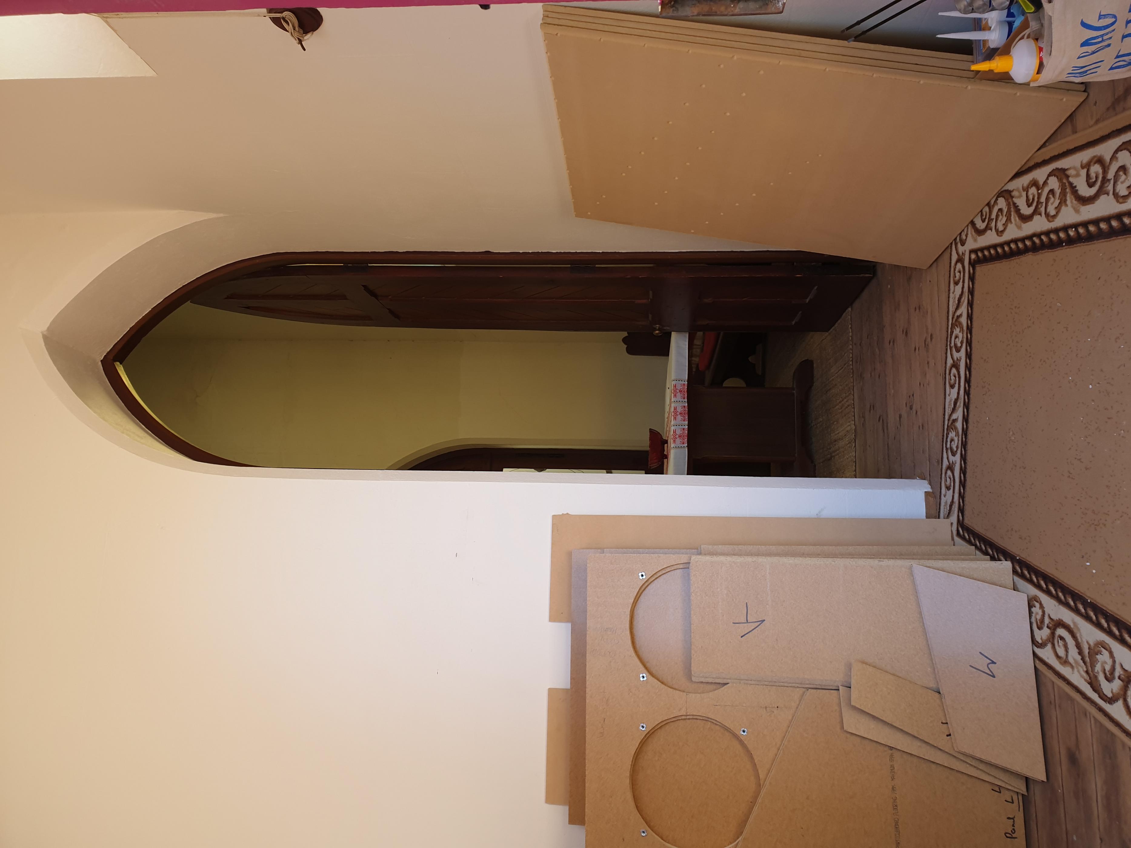

And loaded into the entry of the church hall ready for me to come and screw it together next week.
Yes that timber next to the door is 1178mm tall. And yes that door is ridiculous.
