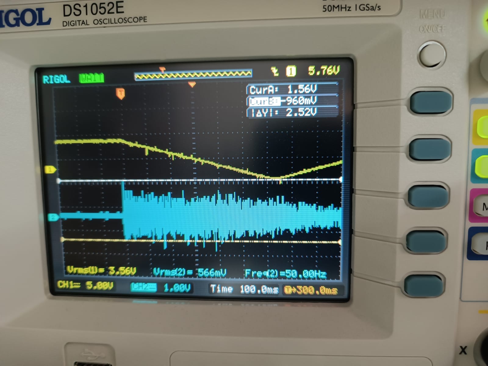

Hi, thanks for your answer. I'm new at audio, but I read the AN a couple of times. Yes, I have a 50MHz 1GSa/s rigol. I couldn't print the screen cause I couldnt make "Ultrascope for DS1000E Series" to work on my pc, but I took a picture(the output signal when I applied the crash cymbal and the csd pin referenced to 0V)

The scope isn't showing the cymbal waveform very well leading up to and at the moment of the reset. It might be helpful to try to get a better look at that.

Apparently when I turn down the level, the 2092 protection is not triggered. The schematic is the same as IRAUDAMP7s from infineon/IR, I just changed the high side ocp resistors(R2=10K,R3=6.8K)

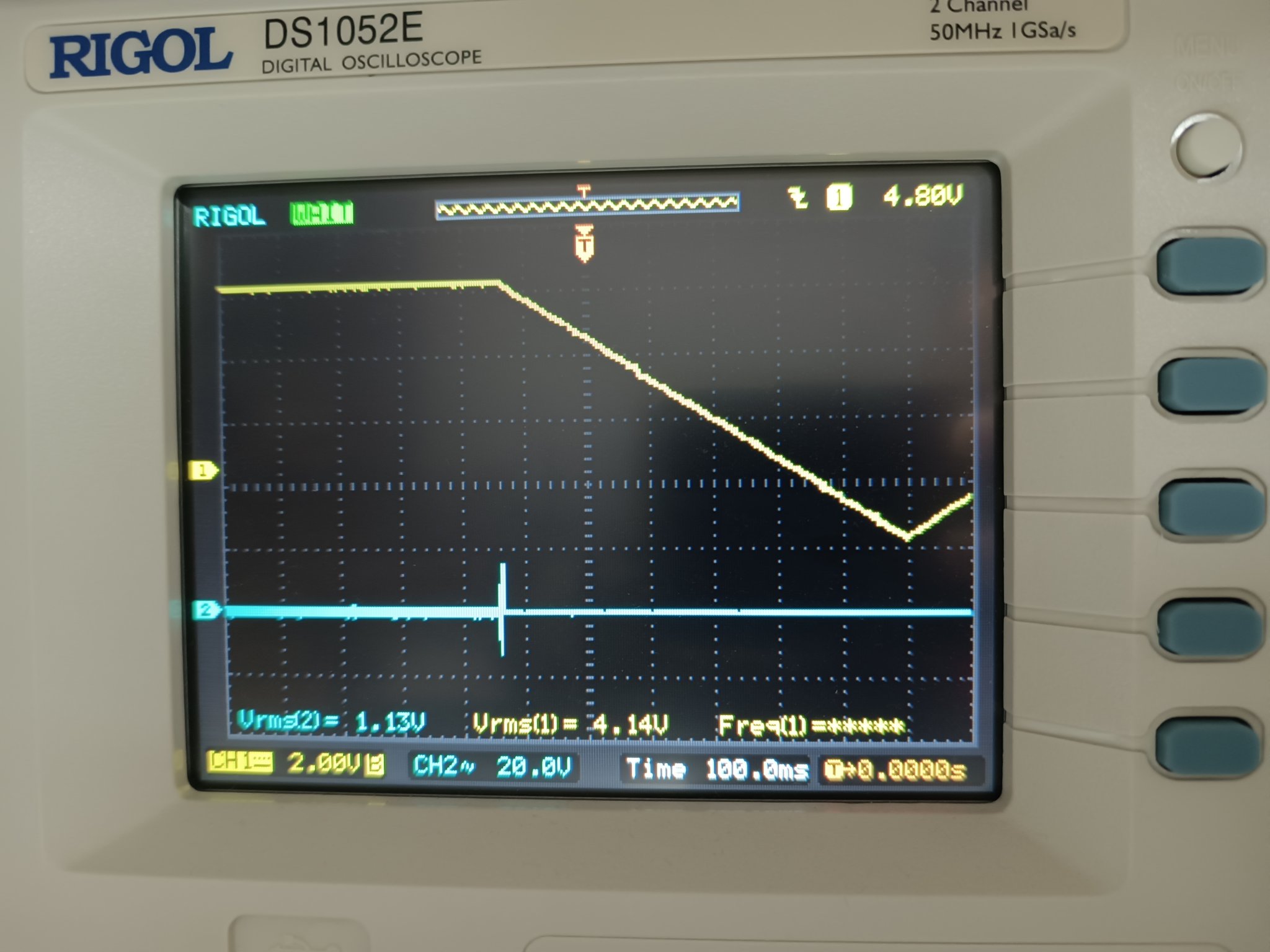

When I'm monitoring the output signal of the cymbal and the csd pin, it appears that the protection triggers so early that no output signal is sampled in the scope, I tried again and the result is the same as the pictures I sent. But when I turn down the level, therefore the IC dont reset, I can see the cymbal signal:

From the schematic it looks like the input is an analog signal. How about capturing that on one scope channel, and the OCP trigger on the other channel? Set the scope to trigger on the OCP trip, with the in single sweep mode (or maybe normal mode to help get trigger settings stabilized, just not auto sweep mode). Also try to set the scope trigger display point more towards the right side of the scope display so that a longer time view of the cymbal input before the trigger can be seen.

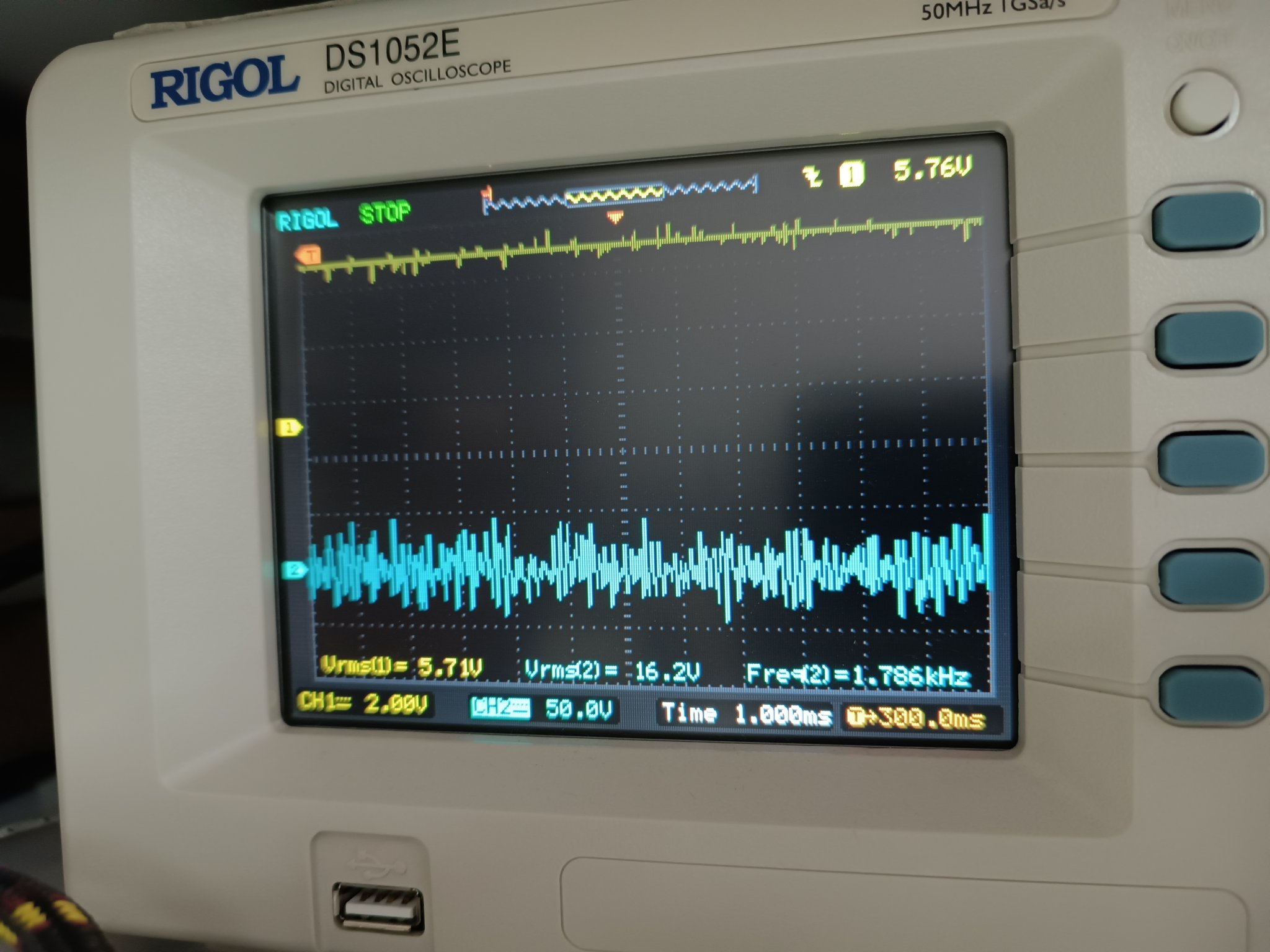

I captured the input signal of the crash cymbal at the RCA connector and I don't think the amplitude was the problem, cause after the 2092 reseted a couple of times and I was still hitting the cymbal, I also noted that the amplitude was higher than it was when the the protection triggered. I used https://www.szynalski.com/tone-generator/ to scroll through all frequencies and see if it was triggering the OCP, which didn't happened. It only happens(as far as I know) with this crash cymbalFrom the schematic it looks like the input is an analog signal. How about capturing that on one scope channel, and the OCP trigger on the other channel? Set the scope to trigger on the OCP trip, with the in single sweep mode (or maybe normal mode to help get trigger settings stabilized, just not auto sweep mode). Also try to set the scope trigger display point more towards the right side of the scope display so that a longer time view of the cymbal input before the trigger can be seen.

Please try that same test again with with a higher sweep speed. The cymbal waveform is too coarse. Can't see enough detail. We don't need to see the whole OCP trip event, only when it triggers. IOW, looks like the scope was set for 100ms per division horizontal sweep rate. Maybe try 1ms, or less. Even at 1ms/div, a 1kHz signal would be compressed into one horizontal division. A cymbal might have much higher frequency components than 10kHz, so at this very slow sweep speed too many details of what might be tripping the OCP are being lost.
Once we know what the input signal looks like in enough detail, then we need to figure out if the amp should be able to reproduce the input signal, or if tripping is correct under the circumstances. For that we will need to know the input signal amplitude in peak volts, the amplifier gain, and what the amplifier output current would be into a 4-ohm load.

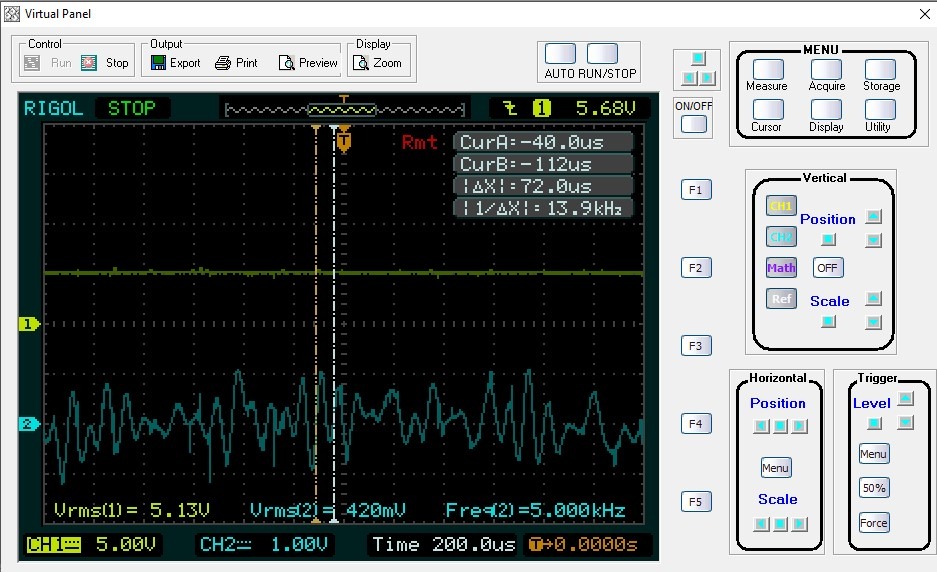

I tried with your cymbal track and after some hours, the protection triggered the same way. I captured on the scope the first micro seconds of the trigger along with the input signal. I was thinking that it could be a ressonance in the LC output filter, I don't know.Please try that same test again with with a higher sweep speed. The cymbal waveform is too coarse. Can't see enough detail. We don't need to see the whole OCP trip event, only when it triggers. IOW, looks like the scope was set for 100ms per division horizontal sweep rate. Maybe try 1ms, or less. Even at 1ms/div, a 1kHz signal would be compressed into one horizontal division. A cymbal might have much higher frequency components than 10kHz, so at this very slow sweep speed too many details of what might be tripping the OCP are being lost.
Seen from the amp an LC output filter of a class-d amp looks like a series resonant circuit. Without load it would present a short-circuit at its resonance frequency. Fortunately the load resistor gives relief in this respect by damping it. You were talking about a load resistance of 4 Ohms. Is it a purely resistive load that guarantees damping at higher frequencies also ? Have you considered using a lowpass filter before the amp ?I was thinking that it could be a ressonance in the LC output filter, I don't know.
What happens at lower frequencies ? I.e. does the amp behave similarily in cold and warm state at lower frequencies ? How hot do your inductors get after some time of operation ?

It would be better to set the scope to display peak to peak volts on the blue channel. RMS is fine too. How it trips may depend on impending peak current, based on the input signal....captured on the scope the first micro seconds of the trigger along with the input signal...
Also helpful to know what is the gain of the amplifier? IOW, how many peak amps into a 4R load is being demanded by the input signal?
