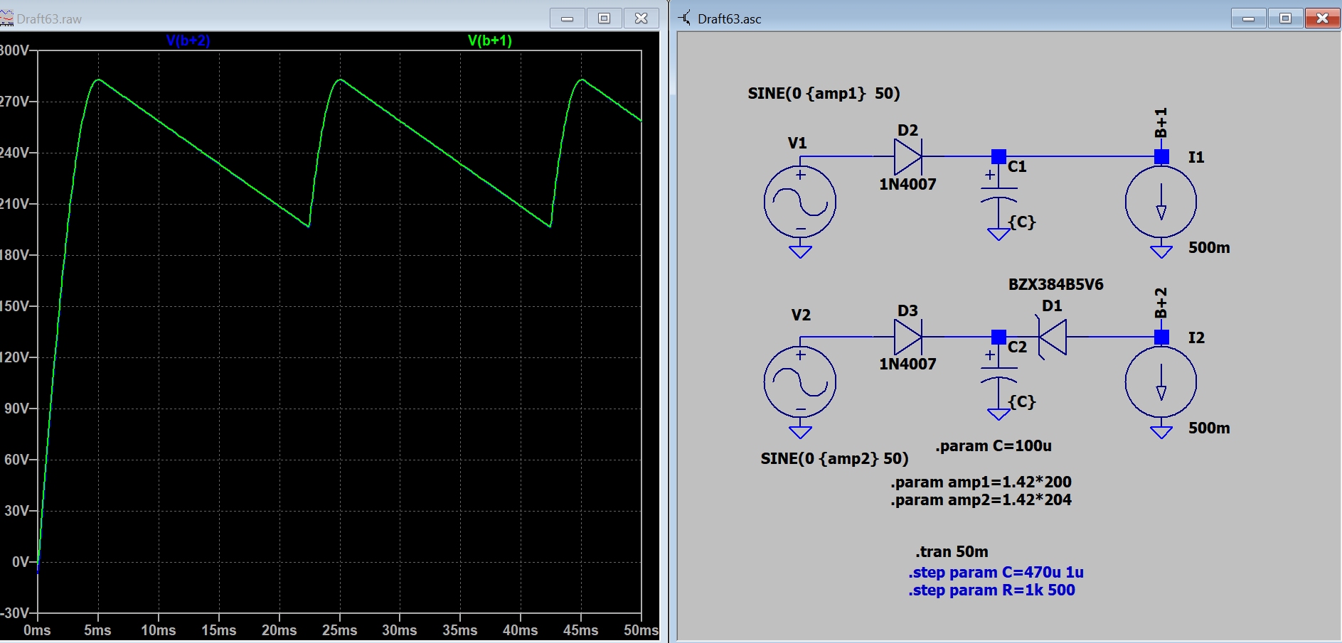

I have received one transformer for DHT preamp with tube rectification, but are not perfectly symmetrical 204 0 200.

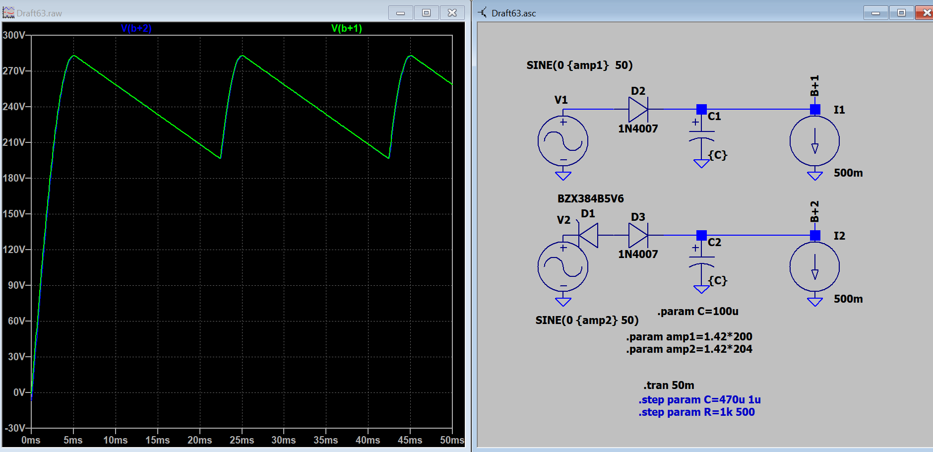

Insert a 5.6v zener to 204V winding after DC rectification or before.
