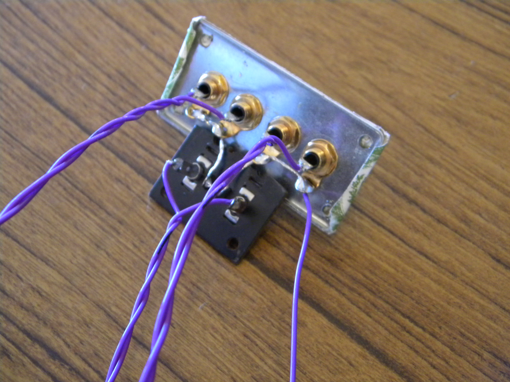

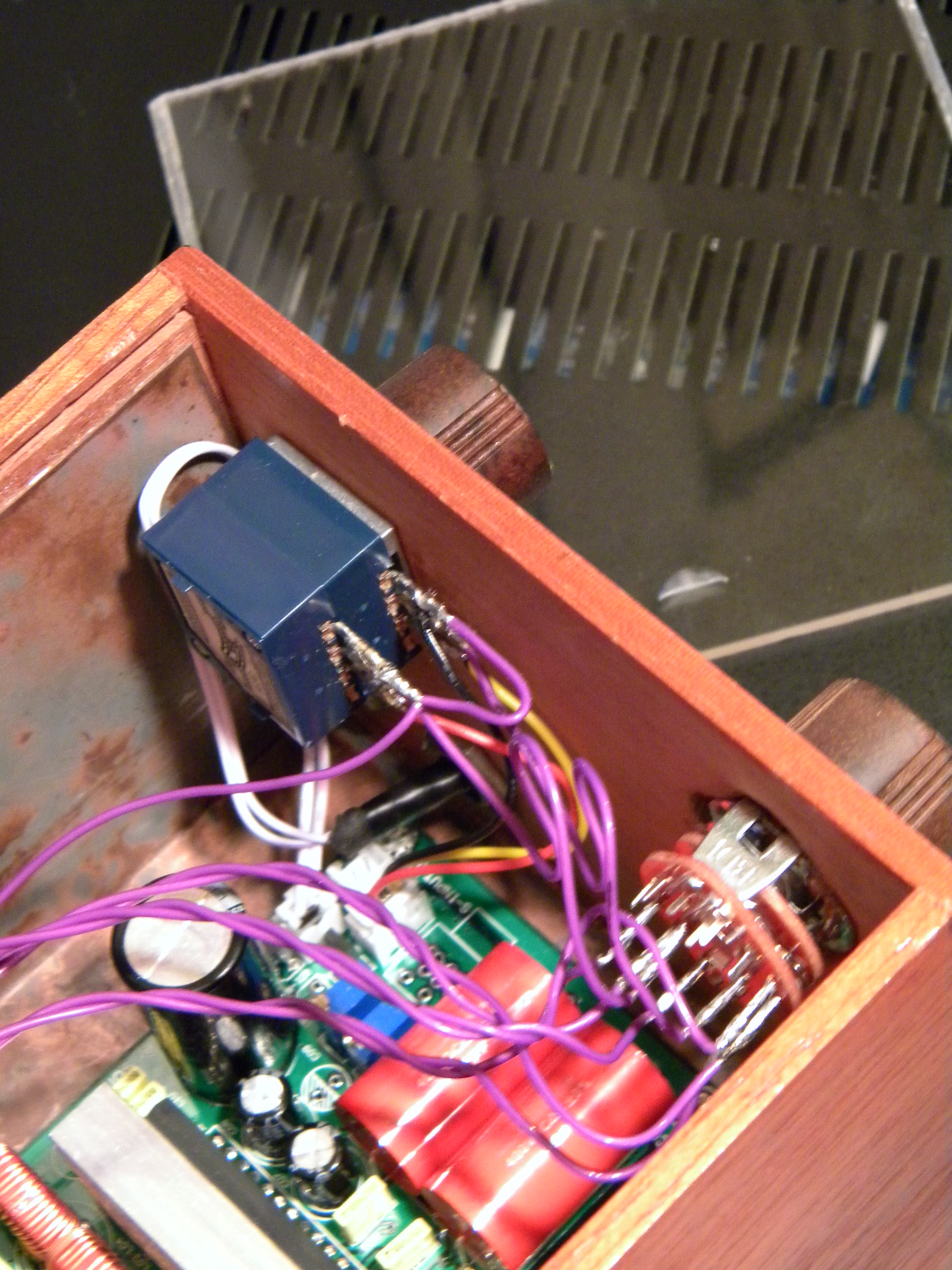

I just put one together and I will send you a few photos. Arjen emailed the pot wiring which is the standard 1 2 3 way with both 1's=ground(solder black and your own wire to one pin and jumper to the other), 2= left and right from inputs, 3=left and right inputs to board. the sticker has the numbers on it (very small). Input is easy because all the grounds are the little pins on the top of edge of the rca block (daisy chain solder them) and you can bypass the selector switch with ground and go right to the pot. If you really look at the selector switch you will figure out what you have to do. The three center pins are the out to the pot wires and you only need to use two of them since you can skip ground going through the selector. This leaves you with 6 other points to solder to on the selector and go ahead and look into the side of the selector so you can see how it works then turn it all the way to the left and mark the three outer pins that have the slide connector on them with a #1 and turn right one click and mark next pin to one counter clockwise looking from back with #2 and do it again for #3. Now 1's are wired to a left and right rca pin on the right back of the rca block, 2's to middle left and right, 3's to left side back left and right (I used rca jacks that I had already).

Send me your email and I'll send you a few closeups of mine assembled. The good thing about this kit is that it is very basic and if you really look at the parts for a while you just get it (even if you are not electrical like me).
My soldering skills are not very good so I cheated and took apart a printer input from an old tower PC I had in the basement and robbed all the brass female pins from inside the connector (just like the female pins that go to a turntable cartridge). I stripped each wire off the ribbon bundle and pushed the brass female pin out the front of the plug. You can then use these wires for your connections or cut off the brass pin and re-crimp them to your own wire ( I did all this because I have a very unsteady hand and the female pin fits right over the selector and pot pins and holds on while your soldering.

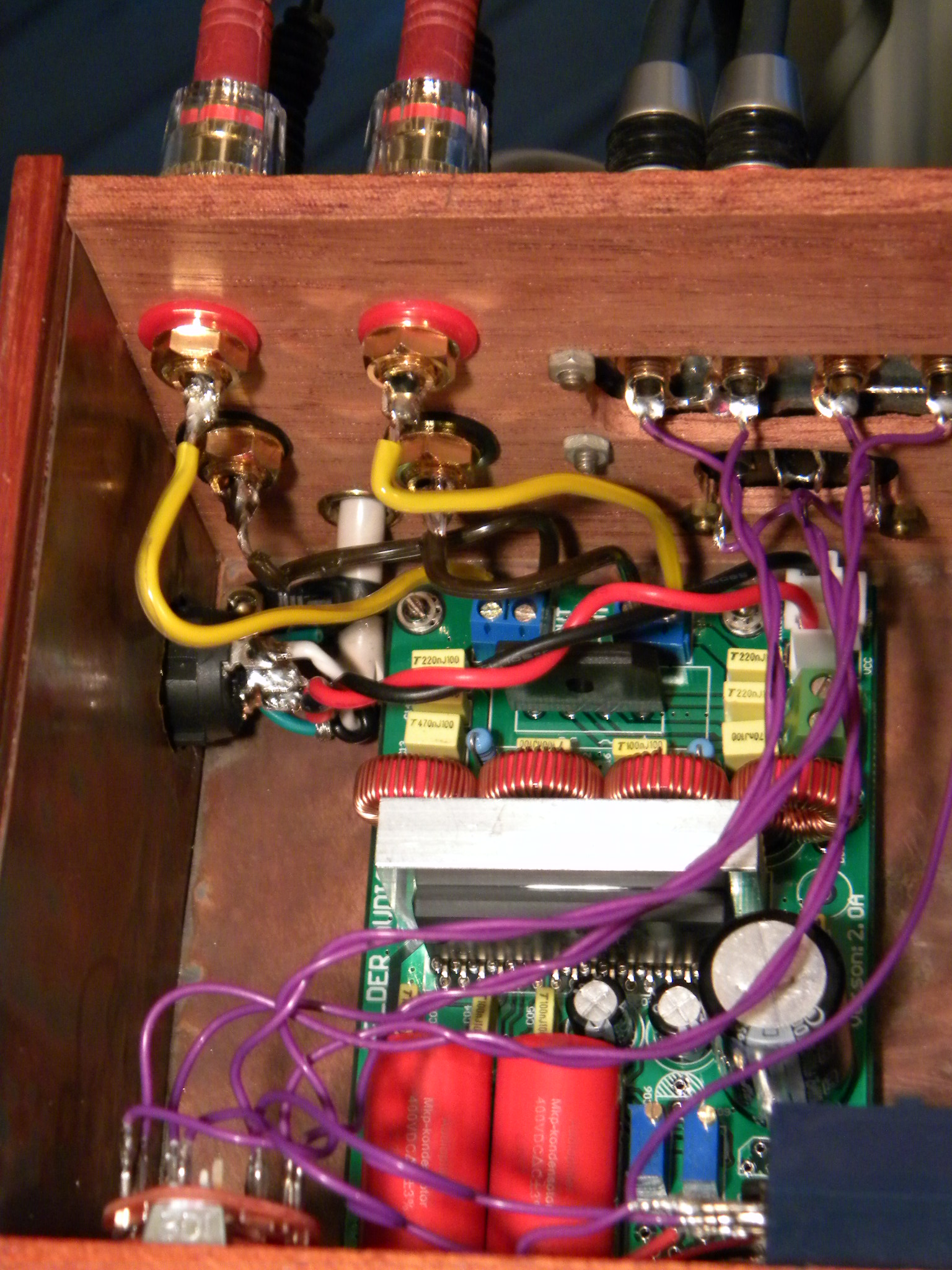

Here's some photos.
Remember that LED's are directional so test both the power and fault light set up after you have the amp all set up. Use the power LED input plug on the board to test the fault harness light too since you don't want to create a fault just to test the light. Radio shack has green and red lenses, knobs etc. in their project drawers that are cheap.
If you use a wall wart, most wall warts have positive (red) as there center pin. If you don't have one check a junk store for a printer or an old walkman power supply will work (make sure the AC is converted to DC and not just stepped down 12v AC like a few printer wall warts do).

I have better photos that are too fine in resolution so they wont load here. They do show the pot and selector switch at a lower rear angle if you need that.
