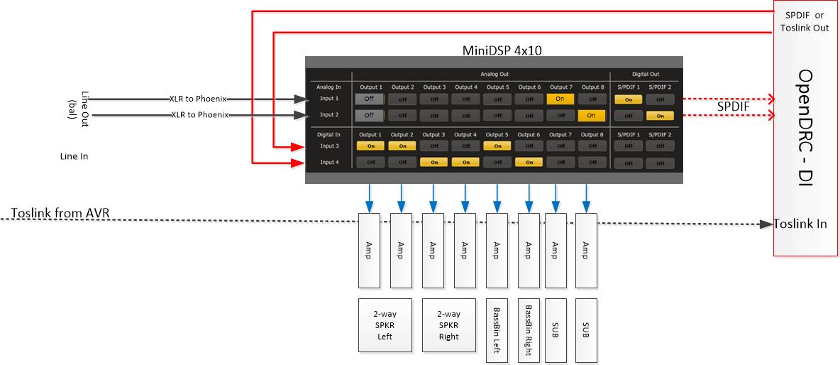

The HDPx seem like very nice and capable units but also quite pricey. I'm getting pretty much the same filtering capability, but not the nice packaging and display, with an OpenDRC-DI for FIR filtering cascaded via TOSLINK with MiniDSP 4x10HD for 2x 4way IIR XO and balanced analog input and output.

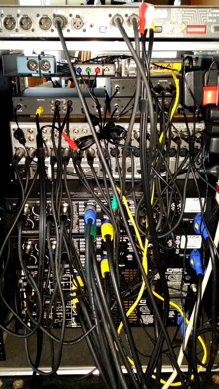

I've held on to some Acoustat X full-range electrostats, purchased many years ago in my 'purist' era when I wouldn't begin to even consider EQ.
And they still sound beautiful, au natural 🙂
But the mess you see below is powering a stereo 4-way setup that's sounding even mo' beautiful to my ears
I guess you could say I've gone active 😀

....I'd say you've gone hyper active 😱...the mess you see below is powering a stereo 4-way setup that's sounding even mo' beautiful to my ears
