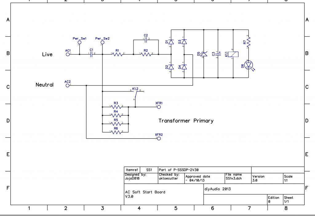

Let me add.... why did the fuse blow up? After all, fuses exist for a good reason... to contain an out of tolerance condition and prevent catastrophic failures.

My thoughts exactly. Looks like the soft start wasn't so soft after all, the fuse looks proper evaporated.
The soft start board appears to be the diyaudio store one:
https://diyaudiostore.com/products/soft-start-speaker-turn-on-delay-and-dc-protector-boards
There way this circuit works is as follows:
The resistor bank is wired in series with the transformer primary, limiting inrush current once the power switch closes the connection from the mains. With some delay, the relay shorts out the resistor bank, effectively hooking up mains directly to the transformer primary.
Maybe the relay failed closed? Should be easy enough to measure, if you know how to do it safely (hint: the power cord should not be plugged in for that measurement).
