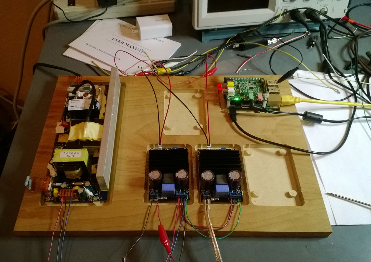

Here's a picture of my active 2-way crossover being tested. I've got two IRS2092 mono boards, one Rpi2 with cirrus card, and a power supply. The board can handle 4 amps - I'm doing a mix of 2-way and 4-way.
It's a bit sloppy but ok for testing.
Nice! I like the CNC pockets to mount the pcb's complete with wooden standoffs built in. What part is that header pin you are using to connect the wires to the power supply?
Thanks.
They're MTA156 females that I randomly had lying around.
