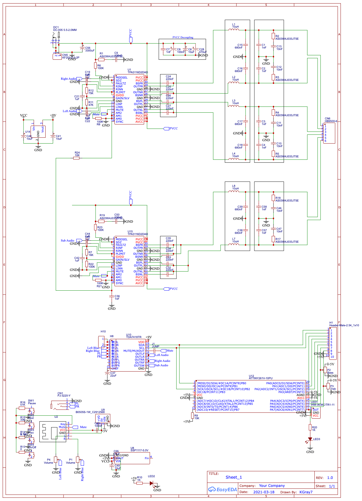

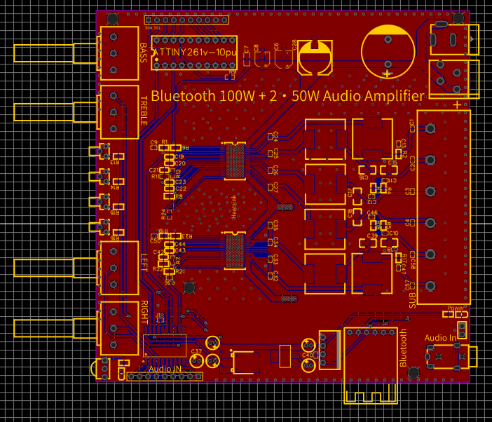

Hi all!
I have designed a 200W HiFi audio amplifier based on the TPA3116. I am trying to make it sound amazing ( 😄 doesn't everyone), so I want to know if anyone has any feed back on design, or things I should add / change.
Schematic, PCB top and bottom, and 3D photos attached.
Thanks in advance for any feedback!
