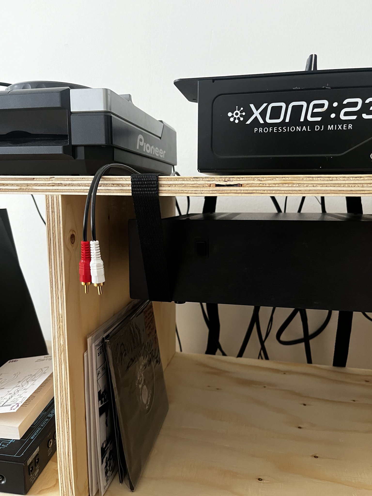

Hi, I had the RCA cable from my CDJ disconnected and just hanging about but got a shock when my arm touched the RCA and my newly built diy amp simultaneously.
I measured it with my multimeter and found that there is roughly 200V AC between the RCA and the chassis. I don’t really understand this consider that both are at very low voltages when I measure them to ground.
The amplifier has been properly earthed with the paint stripped away and locking washers to dig into chassis.
Is this unusual behaviour or should I just move the rca cable?

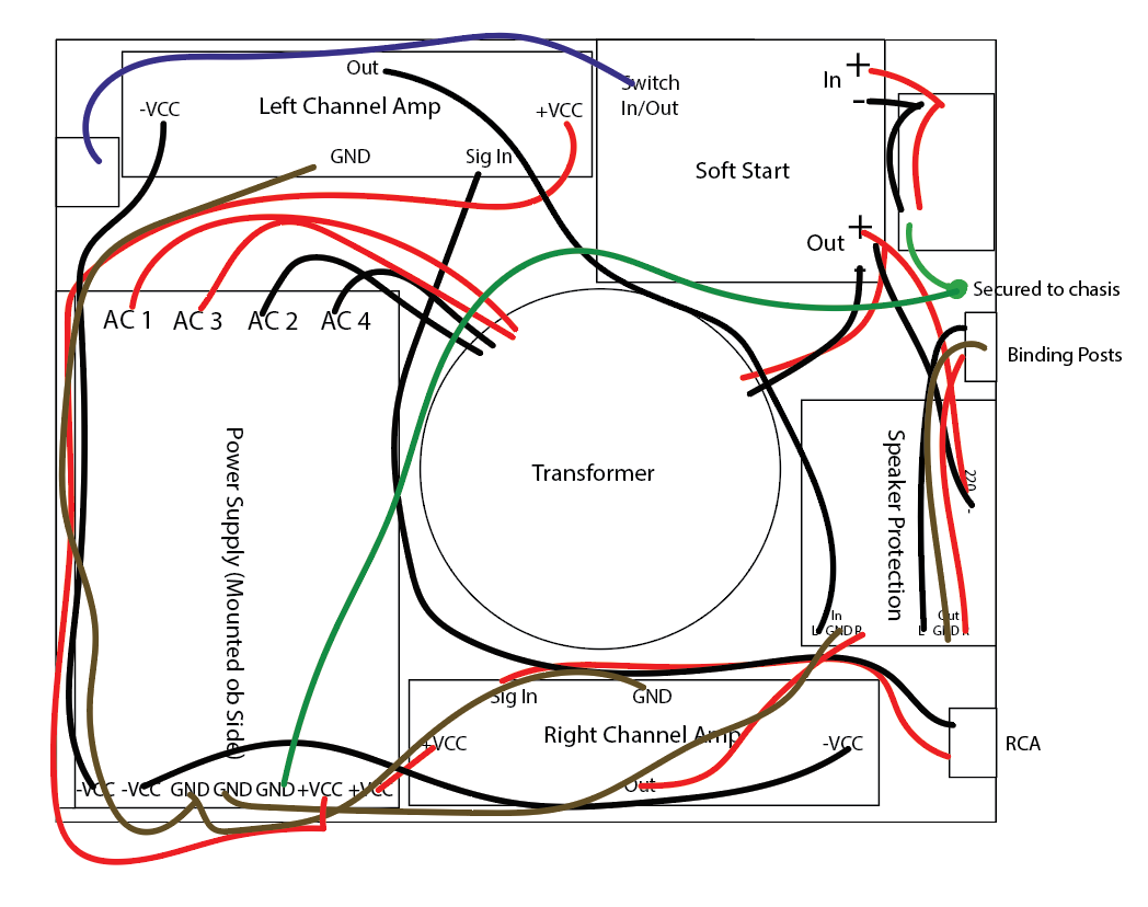

I have dim bulb tester and everything seems fine when I use that on the amp… haven’t tried it on the CDJ. I only have a simple wiring scheme of the amp I’ve attached it here. What would you like photos of?
I’ve also made sure that there’s no continuity between transistors and the chassis as that is a mistake I’ve made in the past. Also for your information there is a 1.6 A fuse in the IEC of the amp

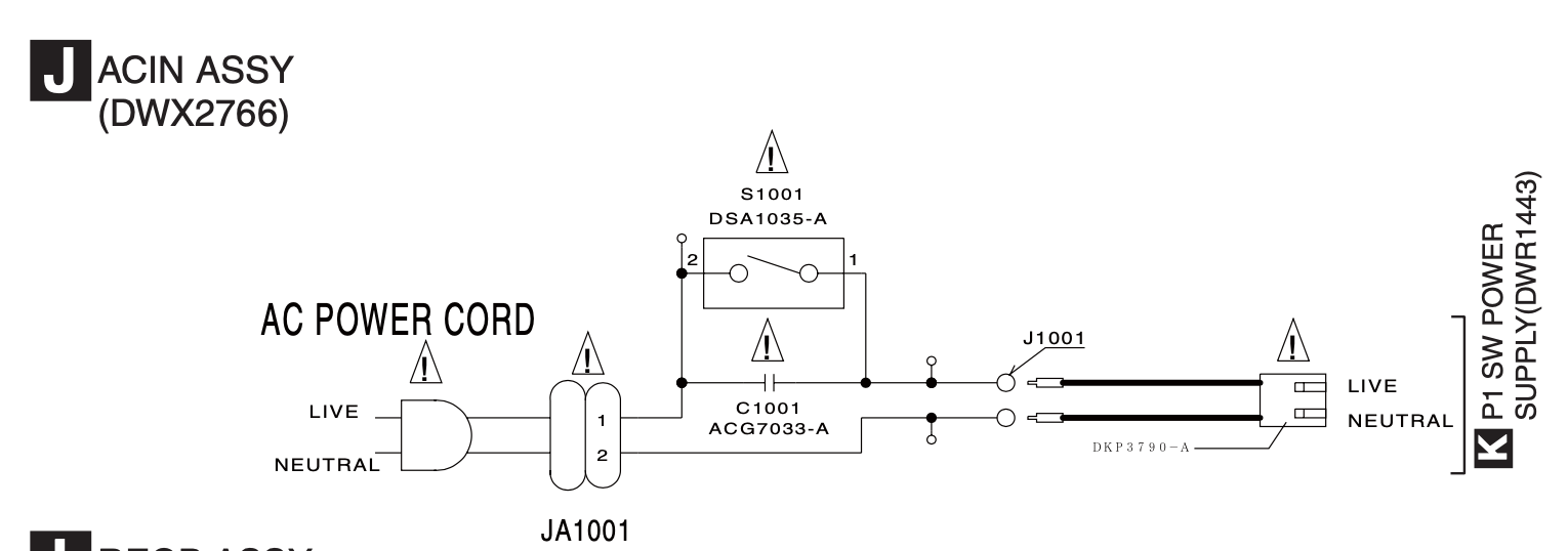

Your CDJ has a two pole mains lead. There is no earth on the CDJ so ensure the phono leads are connected to an earthed amplifier at all times or connect a mains earth to one of the deck input ground terminals.

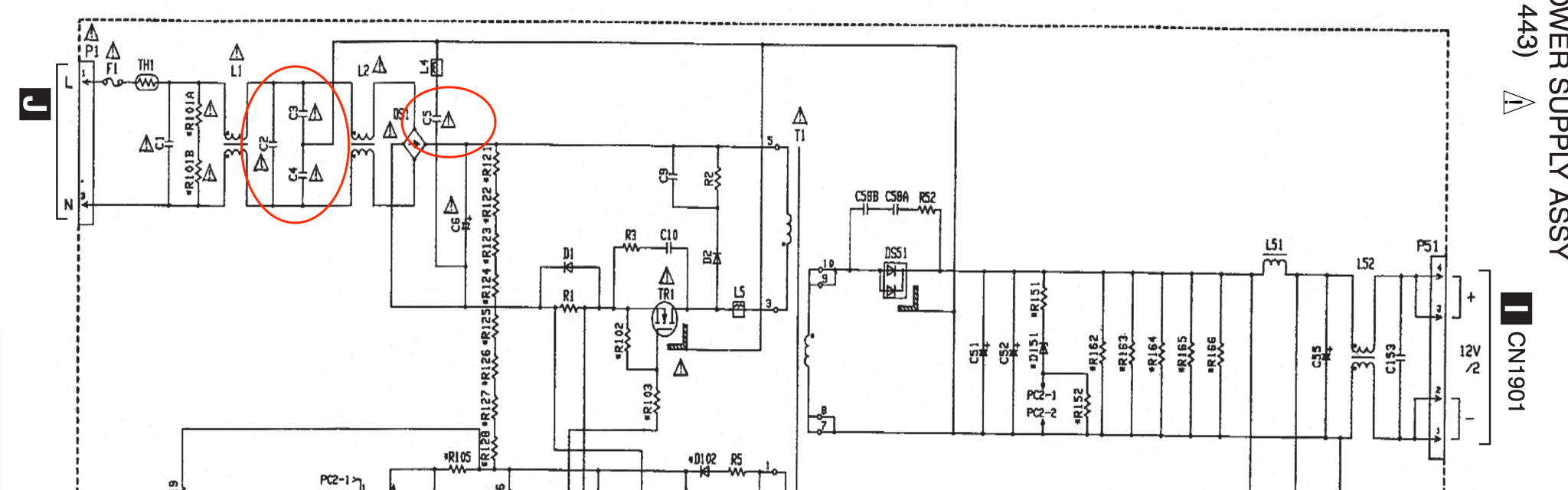

What is happening here is probably the interference suppresor class Y capacitor which connects the case and chassis of the CDJ to one side of the mains, usually the neutral wire. If the mains input is the wrong way around, (Neutral and Live swapped), the chassis will float up to mains voltage but a low current and that would explain the voltage presence when switched off.
The cure is to earth the CDJ chassis and amplifier.
