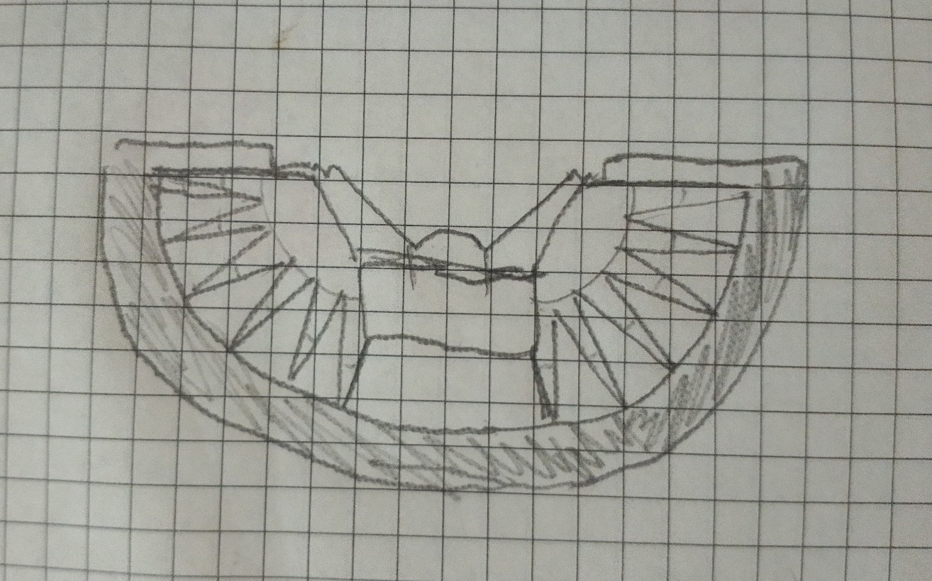

In addition / alternatively, you could use tall wedges to smooth out the impedance change between the air and the solid wall.
From the messy sketch: notice how as the back-wave expands out from the cone, it doesn't encounter a steady low resistance and then suddenly hits a wall. The wedges are like a tapered tube, but you would have to scale your design to be appropriate for the wavelengths that you want to be absorbed.

That was actually a pretty cool idea with the wedges! however it seems like it would be really difficult to produce.

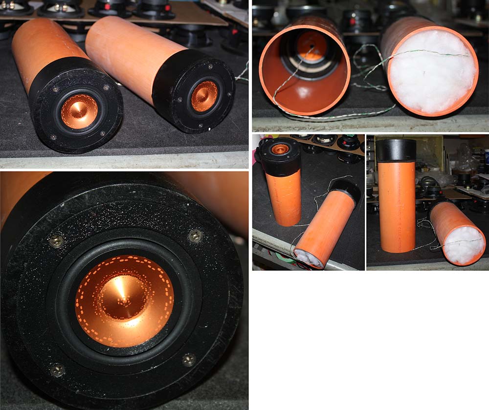

Nothing special about what we and other UK makers used for midrange tubes. I think they were just 4mm cardboard. If you haven't got a cardboard tube supplier, just use plastic drainpipe.kgrlee, do you have any links to a thread or post on the midrange tubes you describe? Would be very interesting to read up on some since it sound like a good solution 🙂
To test the AUDIBLE effect of depth, just try a pot and a tube of the same volume (both stuffed) behind your midrange unit and play pink noise. It's easily apparent. You can try wedges in your pot but I'll bet a LOT of $$$ the long tube will sound better 🙂 You can also do 'waterfalls' bla bla too but a listening test is quick and obvious.

Yeah, as already noted, paper towel, TP cardboard tubes are fine and many to choose from at your local Office Suppliers and at least here in the USA at most local Post Offices (AKA mailing tubes).Nothing special about what we and other UK makers used for midrange tubes. I think they were just 4mm cardboard. If you haven't got a cardboard tube supplier, just use plastic drainpipe.
I've got a pair of empty Infinity cabs sitting out on the deck (wife's plant stands...) that have the cardboard tube sub-enclosure for the mids - they go all the way to the back of the cabinet.

I used a piece of 4” PVC plumbing pipe for the AudioNote cabinet s i am repurposing (2 Coral 8” bipolar + a 3” midTweeter [TB W8-871eN at the moment])
And the Halcyon: 8” concrete form tube
A circular cylinder is incredibly stiff 7 easy to implement.

- 200mm diameter plastic (polypropylene?) tube for mid enclosure in sealed 3-way
