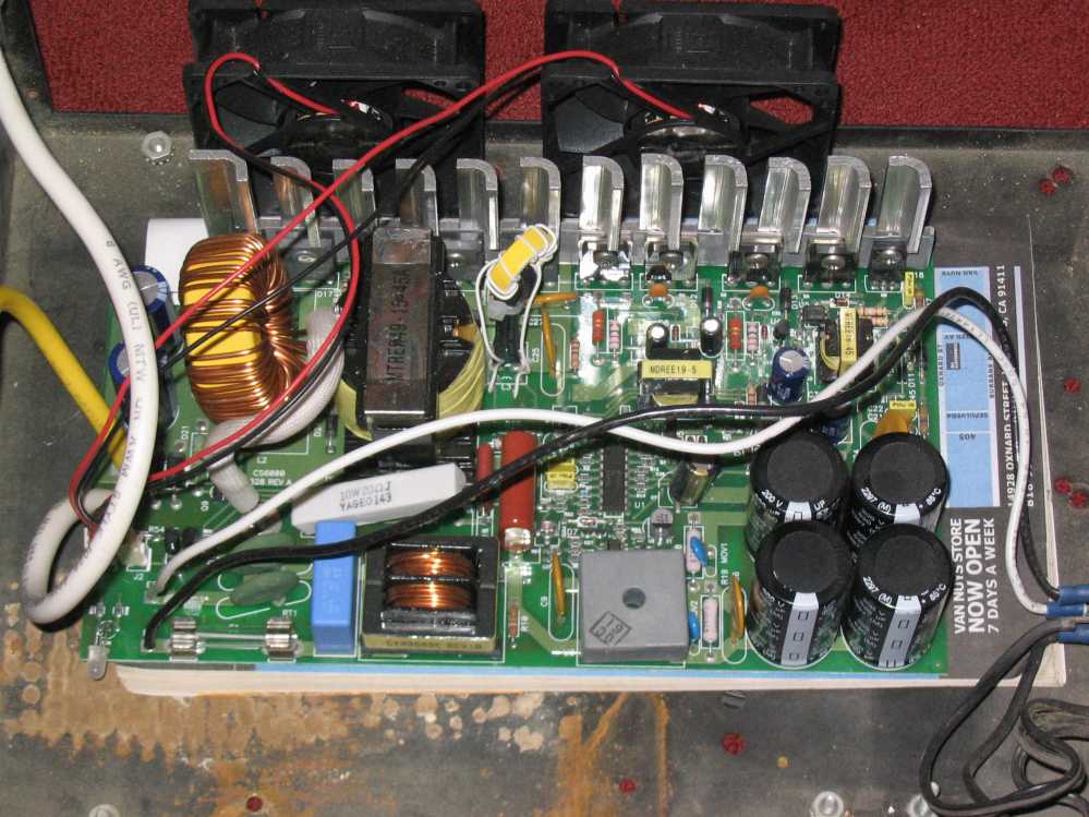

OK, clearly my memory sucks:
1) The PCB I have is not the same as the one in the picture,
2) I was wrong the input fuse is 15A, slow blow, not 12.
3) The output cables are 8 gauge, not 4...
3) There is no indication of the model number on the PCB, so I still can't tell you for sure which it is, but I just tested it at 50A and saw approx. 0.2-0.3v drop on the load, which is probably a result of the hookup wire I was using.
Sorry for the confusion, if the model they are selling is only rated at 12A, a cheap PC power supply is a better option...
Stuart
