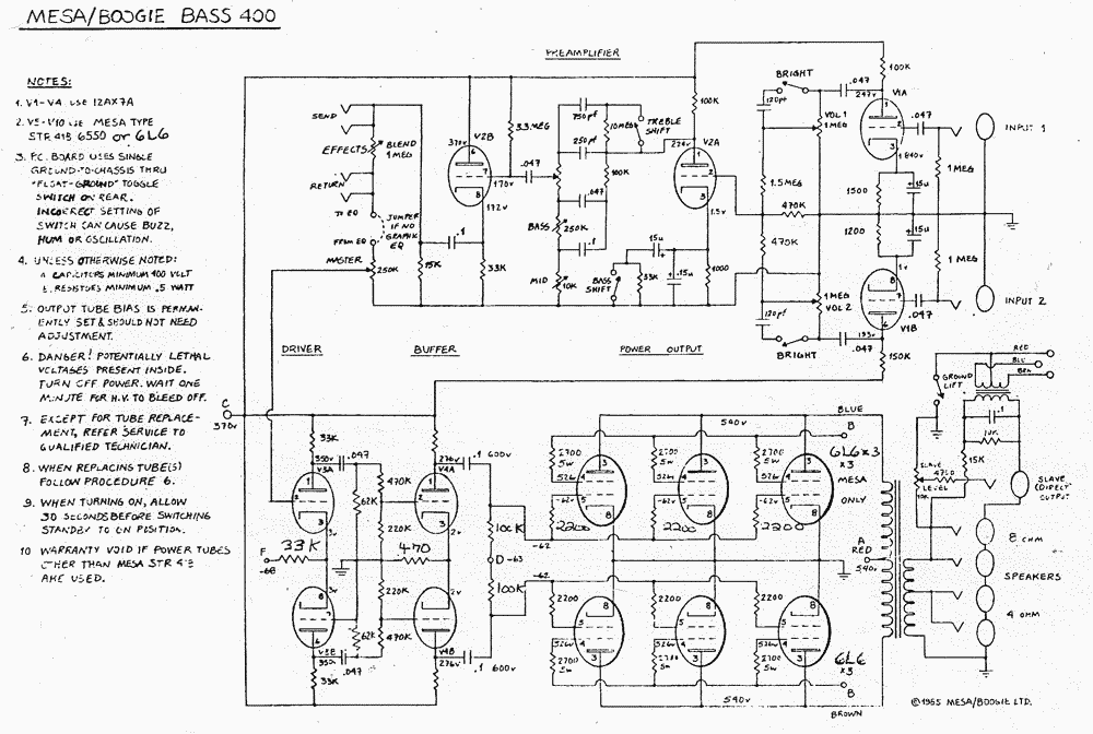

I am currently exploring tube amp construction and since I would have a 180v + 60v + 6v it might make sense to use it for an enormous PPP design (something like a mesa boogie but on a larger scale).

I was actually thinking of doing something like so:
However some good input form you guys is what I really need.
Thanks!
