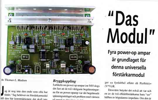

1. In short no. I have just been "killing" Das-Modul and other PCB's testing out my topology. The last test turned out quite well, so I am rather sure of the concept.
The PCB will be around 14 x 4 cm (=5,5 x 1,57 inches), double sided. The 4 x LM3886 will be along the (long side).
Each of the LM3886 will receiver the same signal and then joint in parallel at the output, so we are taking about 4 x LM3886 in parallel.
(I am thinking about the option of "2x2", so one PCB could be used as a stereo-amp, each channel being 2 x LM3886 in parallel).
Ther will be no adjustments and I have made an effort to use standard components.

Dear Thomas,
Thank your for your answers. Even though I studied a lot about groundplanes lately, I still fear them for audio a bit. Maybe you can take away that fear.
You didn't had any noise or hum with this ground-plane? And if the answer is no, How did you get it so good? 😀

Hi Sebastian
There is a lot more to noise and hum than just a good groundplan. I recommend that you take a look at D. Selfs book on power amplifier design, but feel free to ask any question and maybe I can answer them.

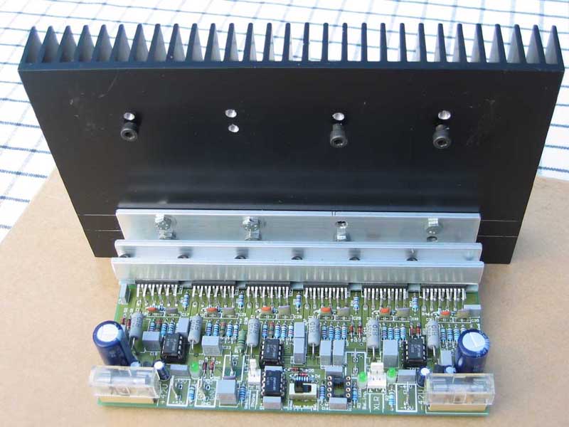

Dear Thomas,
I googled around trying to find any location where I could find the schematic of your Das Modul amplifier but came away empty handed. Can you please point me to the url of this site.
Also is the PCB for this project available with anyone? I wanted to build 8 of these power amps for my active speaker project (Orion+ by Linkwitz). The amplifiers recommended for this project are 60 W RMS per driver and I plan to use your design derated to just 60 W for the special requirements that I have
I stay in India where the ambient temperature where I live can get as hot as 44 C during summer and being conservative I am designing for 50 C as the ambient temperature.
The supply voltage is also not steady and can fluctuate around +/- 20% around the 220 V AC supply specs. hence to cater for these extremes, I would have to derate the 200 W amplifier considerably - and my calcualtion shows that derating to 60 W lives me with a lot of headroom - heat dissipation wise while keeping the amp THF+N figure less than 0.03%. From your perspective, am I being too conservative? and also where can I get the PCB for this design?

extra heat must be dissipated when your amplifier has to drive a low impedance speaker.
Bridging the chipamps makes everyone of the chips dissipate heat as if it were driving a load with half the impedance of your speaker. You will make heat dissipation more difficult by using bridging.
Are all the drivers in the Orion 8ohm?
Then use single chipamps to drive each speaker, no parallel loads.
If heat is as bad as you're suggesting, then reduce transformer (PSU) voltage down from 25Vac to 22Vac. This will reduce dissipation requirement and will also reduce the peak output power.

BPA-200 Das Modul derated to 60 W
I am planning to purchase the 8 ohms version, although the 4 ohms versions are also available. Also my earlier question on the schematic and the PCB. Are you still offering them for sale?
Would using the 4 ohms version reduce my power dissipation?
The heavy power derating would be needed considering the +/- 20% mains power fluctuation. During peak load in the summer (day time) supply voltage goes down as low as 180 VAC on the 220 VAC supply line and hence I ned to design for this voltage to get 60 W. If you consider that at the other extreme the voltage goes as high as 260 during light load conditions, then power dissipation would be very high for a system designed for 180 VAC. Hence the heavy derating of the 200 W system.
