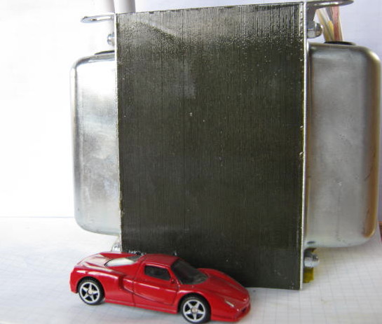

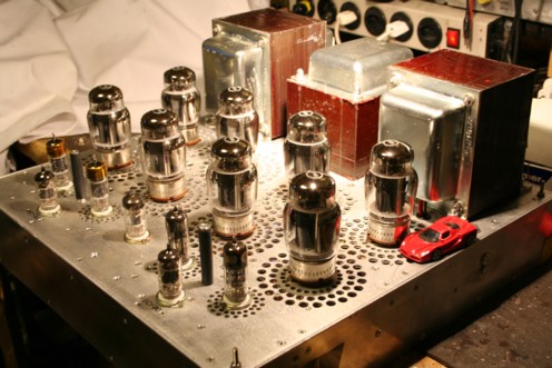

I base my 150+150W designs around 19" rack dimensions; a stereo with 8 o/p tubes with the 4 drivers and other small ones it's tight. Ventilation becomes an issue as does the mains transformer, eg, for 8 x KT88 fixed bias one has got to recon on a power transformer capable of supplying a min of 700W and more if capacitive input filtering is used. I get around this by using power factor control with a slightly smaller mains transformer. The 8x power tube heaters require a conservative 20A winding if KT90's are used.
A top flight UL output transformer in the pic capable of 20Hz-50Khz at 150W will set one back $500 and the mains at an equally painful price.
The weight of the entire amp in pic is around 75Lbs and as others mentioned the chassis fabricated to accept the weight.
How much would it cost to make this quality HiFi performing amp; bits + mytime technology + skinny profit ? For a start, $1000 for the iron. $500 for the tubes, assuming chassis bits ready, for an expert roughly 3wks finish assemble. labor costs, one ain't short asking between $7.5K and $10K depending on ones location.
One pays for frequency range. For MI with 40Hz cutoff, life and technology become far more amenable. Your choice.
