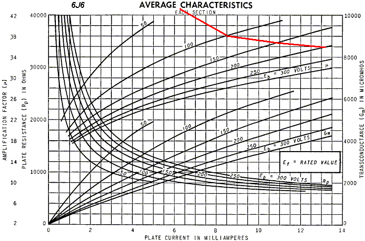

Hi Brian. Second harmonic performance isn't too shabby from the RCA plate curves. An excerpt for a 40kohm load below. On casual inspection it doesn't look worse than, say, the ubiquitous 12ax7. Better audio tubes, known and unknown, are undoubtedly available. In this application the 5964's major disadvantage though appears to microphonic. It otherwise measures very well and if last's night mono session was any indicator, sounds great in this circuit too.
However, I agree something like the 955 or 9002 make for better examples of the principle, potentially terrific audio tubes heading for the crusher for being unknown.
Edit: Loadline shown at ~6.25 ma for ease of judging linearity, I run it at ~5.5 ma.
