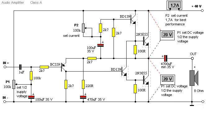

20 Watt Class A amplifier
I found a schematic of this easy to build Class A amp that would be great for a beginner
