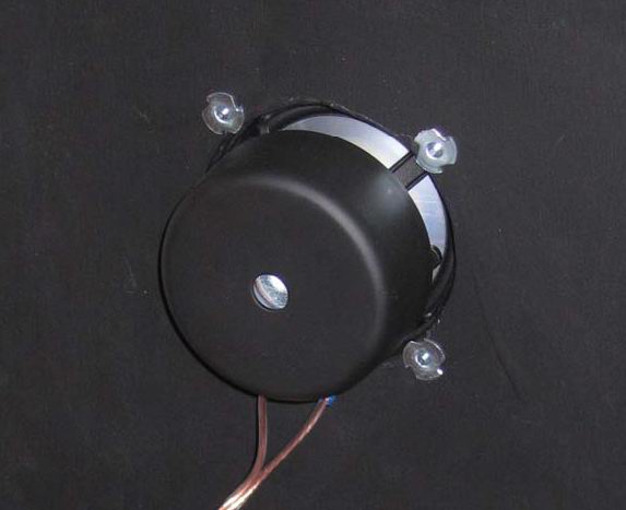

Eric Weitzman said:The dipole field around the upper baffle seems like it would be compromised based on your the photos. The back wave from the Jordan driver appears to be mostly obstructed. Did you investigate this?
No I have not. How would you detect this and what would you do about it IF it was determined to be a degradation to the sound. IF this is true how do we determine IF it is an advantage or a disadvantage?
I hesitate to give you actual *advice*, Martin. I don't design speakers. This may all be wrong, but at least it's food for thought.
The driver becomes directional at around 1kHz (driver diameter = 1/3 wavelength), so we're only concerned below that. Is the magnet structure and cover acoustically transparent below that? I don't know how to figure that out. But if it distorts the polar response by blocking the on-axis rear wave, then the monopole field will have too much energy elsewhere and move the cancellation plane.
You could simply measure the off axis response all the way around the speaker and see.
This might help a bit: http://www.linkwitzlab.com/models.htm#D
But it also made me think of another issue. The Jordan is offset from the edges so the dipole distance varies from perhaps 18" to the furthest corner and 7" (minimum to one edge). Fequal ranges from 125Hz to 325Hz (0.17v/D) and the 6db peak before the comb filtering starts (0.5v/D) ranges from 372Hz to 957Hz. Whatever the actual frequency, which seems to lie between the crossover and beaming frequencies, there will be comb filtering above it.
What to do about it if a problem? How about living with the design as a quasi-dipole with a little more ambient sound than theoretically possible. If I'm correct about the large magnet distortion the dipole field, choose a driver with a smaller motor. Maybe the resonant peak caused by the cavity is a good thing, offsetting a null above Fequal.
- Eric
May I ask by what ?
Unless you are referring to the magnet structure ?
And the possible need to bevel the driver cutout ?

Yes, both. The photo of the back of the upper baffle shows that the magnet cover is about the same diameter as the driver and is perhaps an inch away from the back of the baffle.sreten said:Unless you are referring to the magnet structure ?
- Eric
MJK said:I am not trying to shoot these ideas down, I am just trying to play devils advocate. So many times in audio we rationalize rocket science explanations for something and it is just not that significant. We totally focus on minutia and neglect the simple things we can do to improve a system's performance. My experience leads me to question things that sound complex or seem to elaborate, most of the time the simple answer is correct.
Agreed. But all you need to do is measure all around the speaker off-axis to see if it's an issue of significance or not. Maybe dipole behavior isn't a major prerequisite for this design anyways.
Every driver has a frame and magnet structure so it should be to some degree a common accurance. Look at the magnet and frame structure on the back of my Lowther PM2A which seemed to work fine.
Another option is a larger driver. Here's a shot of the back of the driver used in the Orion. But if one of your criteria is to use a full ranger, then your options are limited.
- Eric

Eric Weitzman said:Yes, both. The photo of the back of the upper baffle shows that the magnet cover is about the same diameter as the driver and is perhaps an inch away from the back of the baffle.
The opening is probably a little better then what is depicted in the picture, the angle I took the picture makes it look smaller.
But in any case, what I ended up with is a 3/4 inch long annular TL behind the driver. The tuning frequency for a 3/4 inch long TL is about 4500 Hz. At that frequency the acoustic impedance at the open end of the TL, based on the available open area, is probably purely resistive. So sound is not reflected back to the driver and is efficiently transmitted into the room. Below the tuning frequency air just moves as a slug in and out of the cavity adding a parasitic mass load to the back of the cone.
That is my simplistic thinking about what happens in this region. Maybe I am right or maybe I am full of crap. The sound is all that matters.
