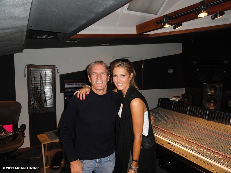

Also take a look at the monitors in that studio.
Michael Bolton's photo "In the studio with the incredibl?" on WhoSay
The big monitors seem to have toed in bass drivers. For better dispersion and bigger sweetspot?
Also mention the horn size and proportions.
By the way Michael Bolton's are always nice and always have deep bass notes. Some better, some even better, but he has never betrayed good sound in the way many other performers have did it.
He has some very nice records with Capitol studios.
Capitol Studios & Mastering
Again in all studios A, B and C same alignment of bass drivers, again two way and again horisontal wide and narrow horn.
Maybe they are after the effect of that Sansui
Actually quite allot Sansuis have midranges arranged like that. The question is why woud someone toe in bass drivers like that.
