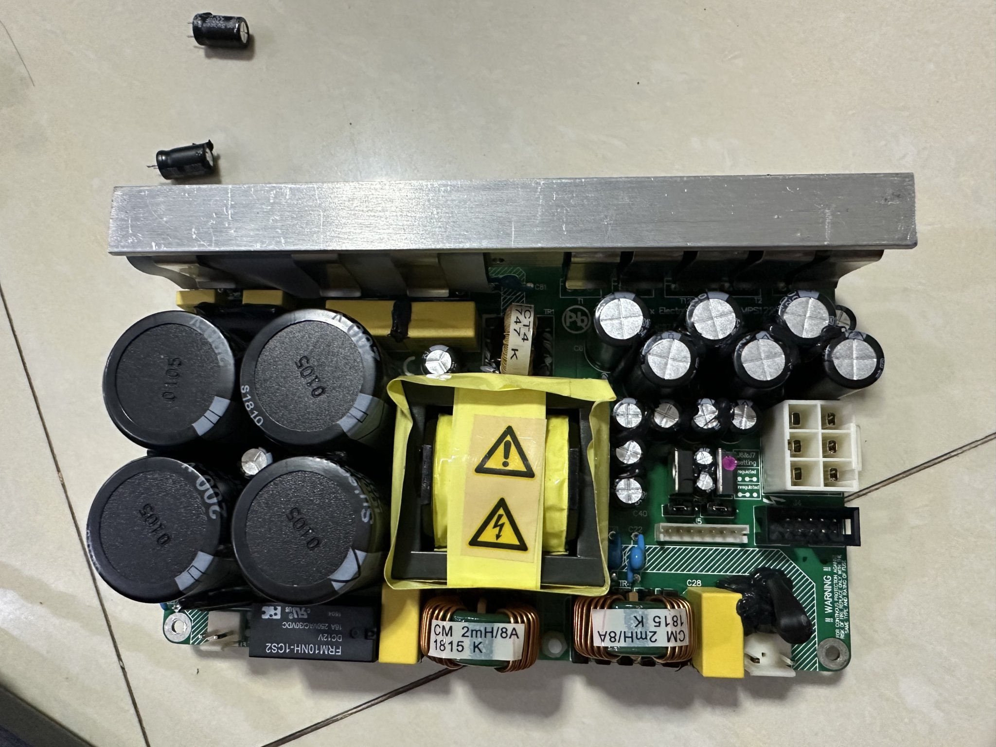

Hi, I have the same problem on one channel of my Nord One SE. The relay on the SMPS1200A400 won't click when I turned on the amp in the morning.
When this problem started 2 days ago, the relay will click occasionally (1~2 times in 10 minutes) if I kept the amp on. But, it won't click at all now.
No sudden power cut prior to this.
I have checked and done what Landmaker did but no luck.
  • The fuses are fine ->Done
  • The current inflow thermistors are fine ->Should be OK since 4 main caps are able to charge up to >150Vdc
  • The main capacitors are charging ->Done. Charged up to >150Vdc
  • I've tried letting the main capacitors discharge fully before powering on again ->Done. Verified all 4 caps with DVM to be 0V
  • I have checked on other power outlets ->Done
  • I have tested with and without NCORE modules hooked up ->Done. Tried this on the good channel and relay will click
Additional checks:
  • Inspected and confirmed no bulging caps
  • Swapped good and bad channels SMPS ->Confirmed the bad SMPS won't turn on (no relay click)
  • Replaced C38 with 220uF/50V cap ->no change
  • Measured C38 leads ->~5.2Vdc
  • Measured C39 leads -> 0V
  • Measured U1 and U2 (12Vdc regulator) -> no input or output voltage
  • Measured relay coil -> 0V
  • No output from J5-V(aux) ->Nord One uses J5 V(aux)-GND pins for power on/off LED on the front panel. When the LED wires were swapped to the good channel's SMPS J5, the LED will illuminate.
I will replace C39 next, but I would appreciate if anyone has more experience to share. Thank you!
