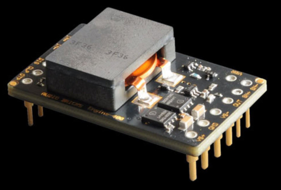

Hypex Electronics B.V.
Hypex has complete plate amps including power supply.
http://www.a-bricks.com
Check out the small cute A-Bricks 400 W in a creditcard size.
I've seen the Hypex units before; quite expensive vs what's possible with a separate amp unfortunately.
The a-bricks look interesting. Probably underpowered for what I wanted, but any idea of pricing?
