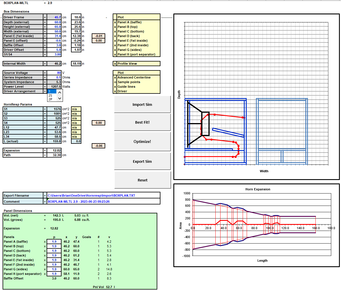

Offset-driver TL for one driver. Two boxes side by side = 100cm x 78cm x 71cm. You can make the box slightly narrower, if you trim the inside of the side panels a little to allow the driver's frame to clear and be mounted on the baffle. Good to 35 Hz. Brace that top panel and lie them flat and stacked for best response. Well, it's a start.... 🙂

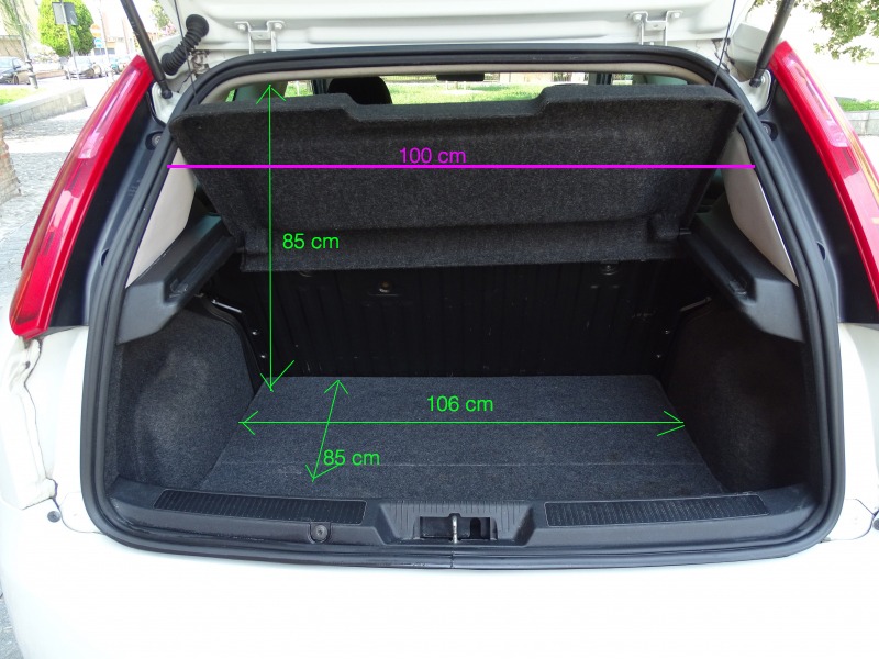

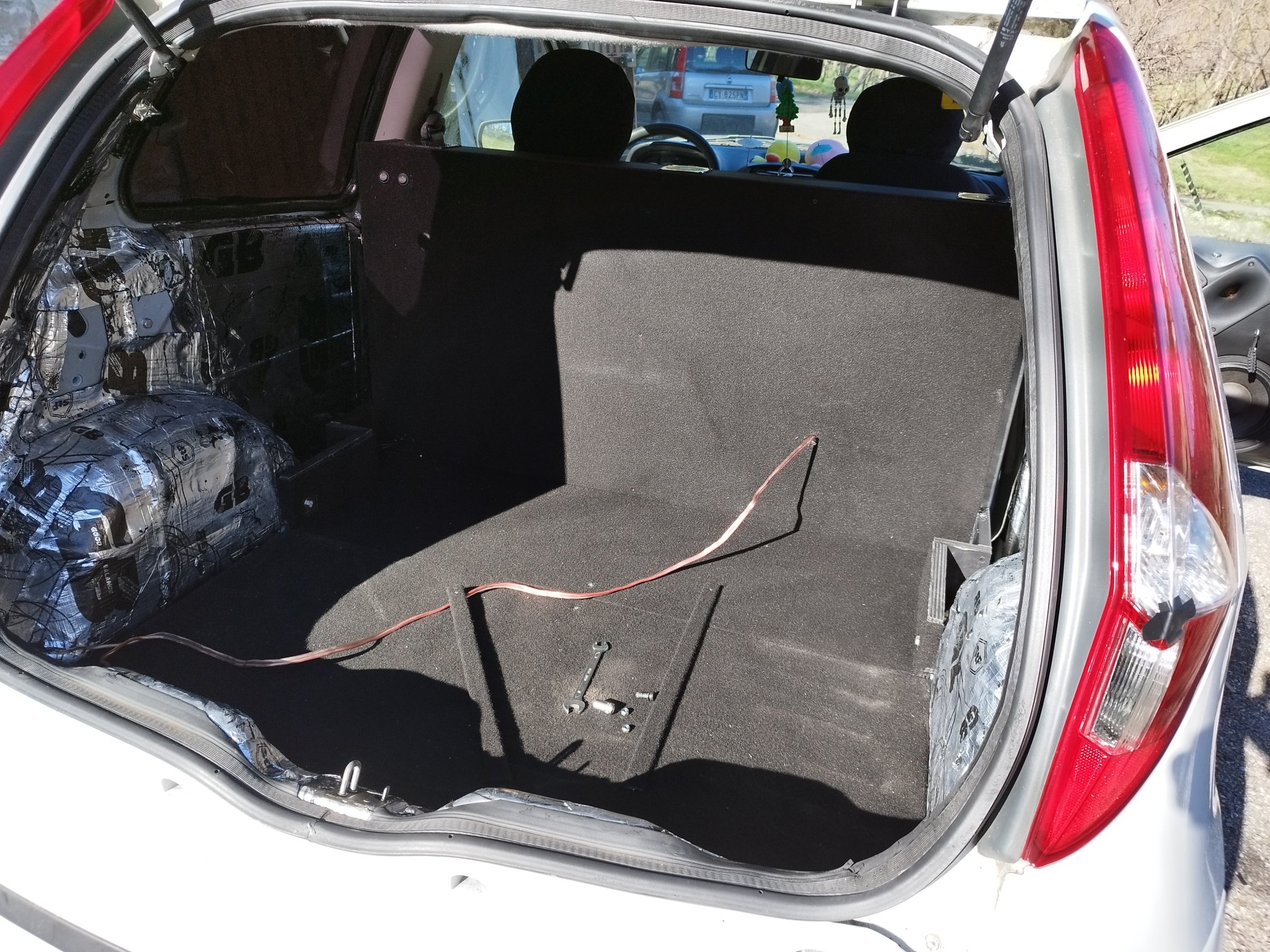

The green lines are the box dimension once into the car, but the problem is the trunk opening that is 100cm. obviously this is a downloaded pic, not the real car. mine is flat inside with no rear seat
i like the @Brian Steele solution, i never thought about splitting in half the box but i'm curious what are you talking about @Smitske96
Hi, trunk bed is 85cm deep but I doubt the top is. Perhaps 50x80 or 60x60 or something like that fits, 1m wide of course.The green lines are the box dimension once into the car, but the problem is the trunk opening that is 100cm. obviously this is a downloaded pic, not the real car. mine is flat inside with no rear seat
Perhaps Brian Steele box fits if you slant one edge so that the hatch closes.
Measure available space accurately, hatch closed.

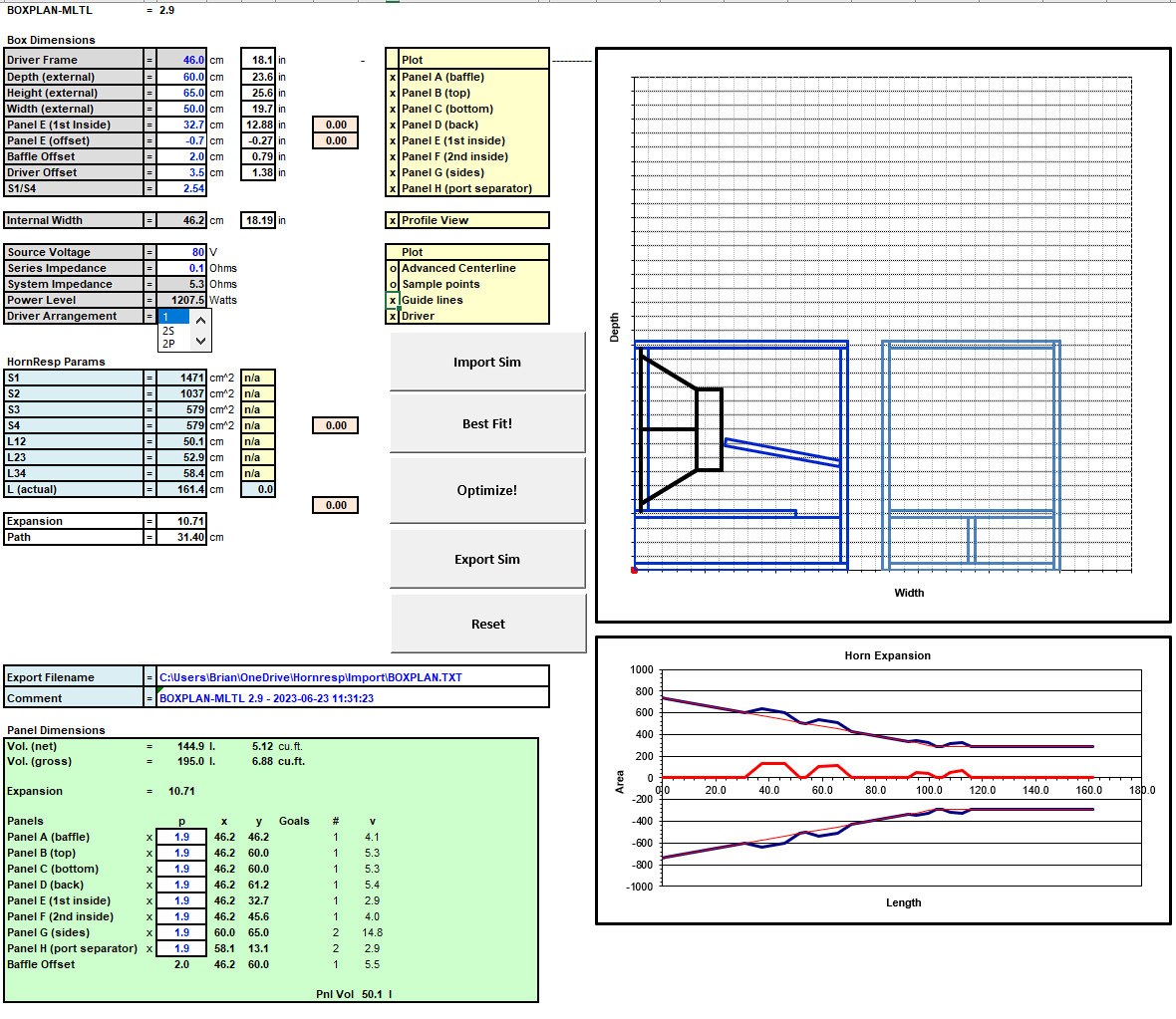

Downsized Offset TL. Fb is now 37 Hz and the response will be sloping down to that point, but it's nothing you can't fix with a bit of EQ or DSP. Brace the top panel, add a little stuffing to the top chamber behind the woofer. 100 x 65 x 60, so fits your dimensions. 3:1 Sd/Vent ratio, basically right on the minimum ratio I'd use for a subwoofer.

I forgot to mention, my workbook does not take into consideration the volume displaced by the driver's chassis. Not usually a big issue with larger boxes, but as box size gets smaller, the impact may be more noticeable. I suspect that for this design the efficiency around Fb might be impacted a bit.

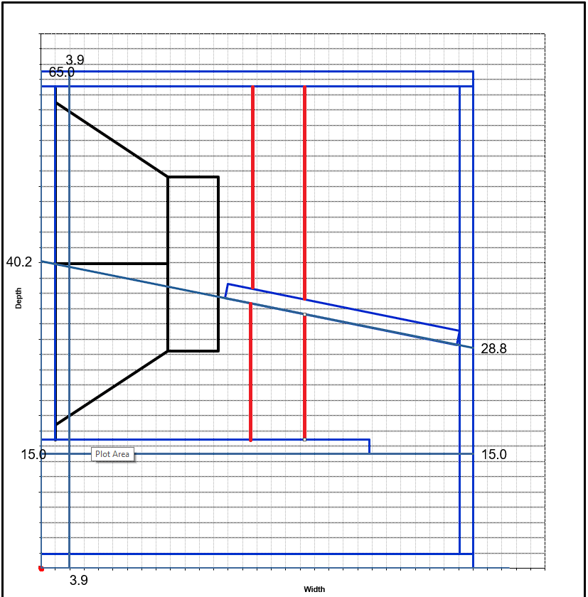

Slightly tweaked version. Speaker baffle is now square, and just fits the driver. Basically, install the driver dead center of the baffle. As the baffle is recessed a bit into the cabinet, it will be a very snug fit. Can't double-up on the baffle thickness because that gives up too much volume. Second picture shows suggestion for possible bracing for the top panel. Fb will now be closer to 38 Hz, so you're not going to be able to reproduce anything below that with this design.
You might need to trim the internal panel a bit around the driver's magnet to ensure proper clearance for the vent. That shouldn't affect Fb too much.
The second picture is a suggestion of where to put the brace for the top panel.
It doesn't take long to create these - just a few minutes with my BOXPLAN workbook.

Brian, What is the top panel? Cause as it is shown it is intersecting the panel behind the driver. So you need to cut 2 pieces for the bracing?
Or the top panel is the one that is removed (side) so to show the internal panel layout, cause if you add that panel you won't be able to see how the internal path is made.
