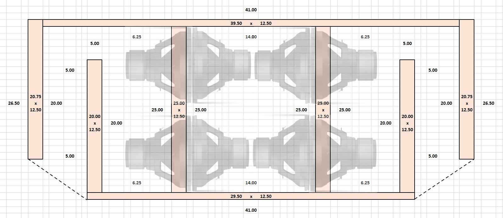

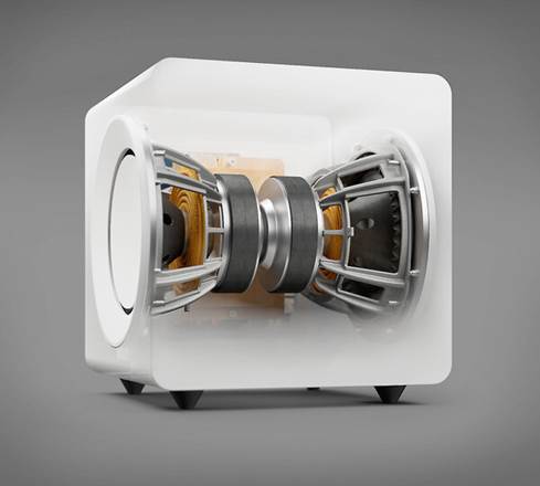

The dual-opposed design really does cancel vibration very effectively. Imho, well enough to reduce the advantage of cast frame baskets. Especially if you use a cancelling rod (or many) to mechanically link the 2 drivers internally. Like what KEF does with the KC92/62.
Since you'll have DSP, the box size is less critical, esp with sealed. Peerless SLS10 drivers would work fine in this context. The 8.3mm Xmax is probably good enough since you'll have 2. A 70-80 liter box, with a rod slightly tensioned between the magnets of the drivers. FA251 driving the drivers in parallel.

Roughly 72L sealed section with isobaric configuration.

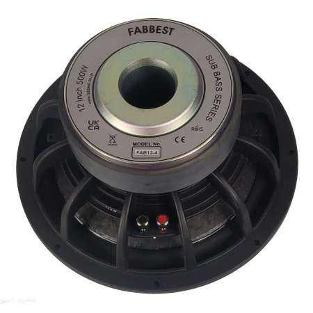

@svp if you can handle a couple extra inches of width, perhaps consider the BK Electronics Fab-12:
https://www.bkelec.com/HiFi/Drive_Units/Fabbest/FAb12-4.html

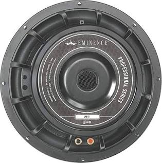

Very similar specs to the Lab 12C, which is happy in small enclosures. An opposed pair of these in net 65L or so, with a bit of DSP EQ, should go very nicely.

Thank you, did not know this brand, could be a feasible candidate for bigger version, but I will stay on 10 inch for this one.

From what I understand, BK had for a long time used the Lab 12 driver in their Monolith sub model, and more recently developed this driver as a slight upgrade. A bit more xmax and power handling, larger VC, rubber surround, but otherwise very similar specs. No idea where it is actually manufactured, but BK Electronics is a UK-based company.
