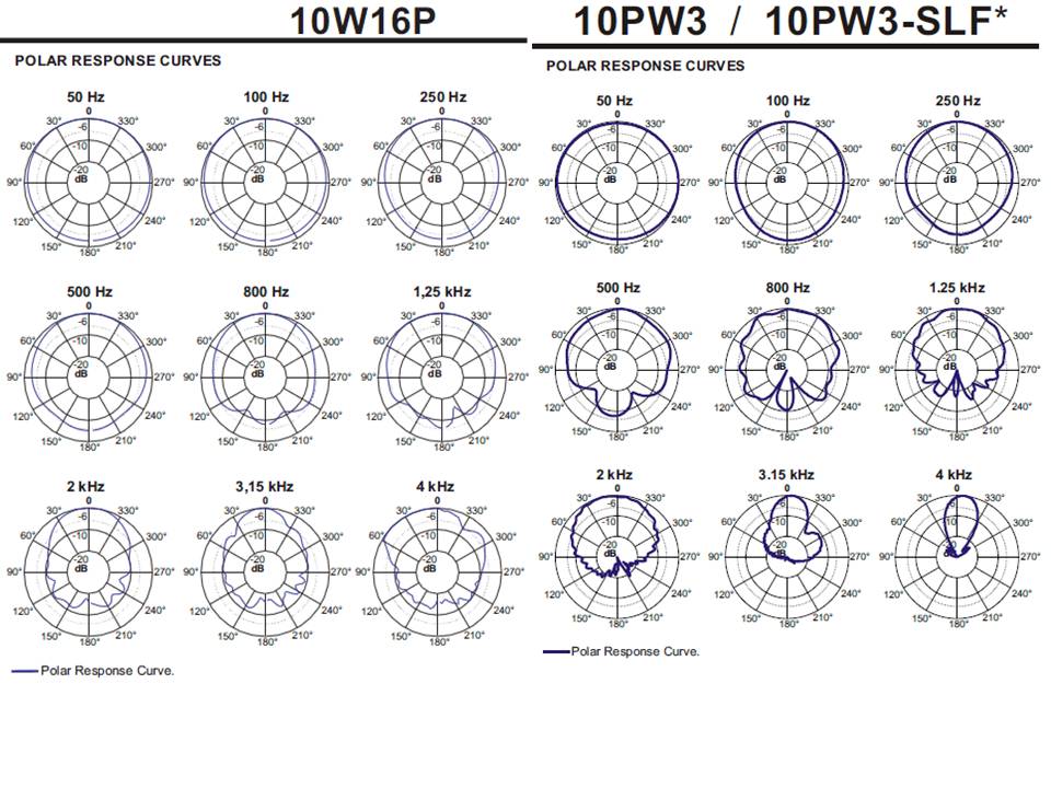

DECISION #1... construct a true full-range 3-way by adding a "real" woofer, OR construct a limited bass 2.5-way using equalization on the second 10PR300, OR use just one 10PR300 in a ported box down to 65Hz
The Faital 10PR300 has an Fs=60Hz, and Qtc=0.25, and Xmax=5mm, and 98db/watt efficiency .... it is a pro midrange, and not a woofer. So, you will need to decide if you want to purchase a "real" woofer and construct a true 3-way for deep bass, or if you want to use the second 10PR300 with EXTREME bass equalization to get limited bass(Xmax=5mm) from this 2.5-way topology. You cannot run the two 10PR300s together because a small mid-tweeter center-to-center distance is required to avoid lobing and also to have a smooth polar response transistion between the midrange and tweeter. You must crossover the second/bass 10PR300 at around 300Hz(the baffle step for a 16" wide box) so its highest output wavelength does not interfere with the tweeter and generate NULLs.
I do not have polar response curves for the Faital 10PR300, so look over the 10W16P example attached to see how this 10" speaker starts to BEAM at 90 degrees around 1250Hz. With a LR4 Xover at 1250Hz, this 90 degree polar response from the midrange will just match the 90 degree polar response from the SEOS12(or similar) waveguide tweeter. SMOOTH transistion. I think you will get the best sound using one 10PR300 midbass in a stuffed sealed box crossed with an LR4 slope at 1.2Khz to a SEOS12 waveguide with a 1" compression driver. To reduce lobing, it is important to butt the waveguide next to the 10PR300. Home page DIY Sound Group

Simple simulations for the 10PR300 show a good ported box starting point might be a 35-40L box tuned to 68 hz. This is +/- 2db over the passband with a 1 db peak around 75 hz and a 2 db pipe resonance around 515 hz.
