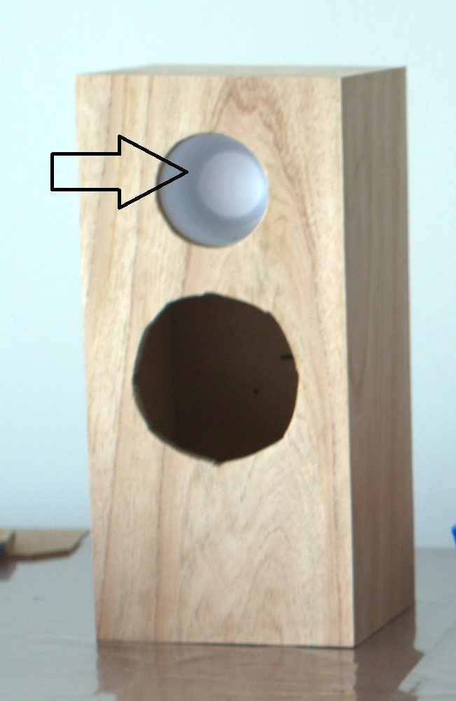

The boxes
This time most of the materials that I used were the ones I have or were available in Buenos Aires, and I made all the calculations in order to be able to use then.
After some iterations, using the specs of the woofer, I arrived to 8.5l boxes. For the construction I got precut 9mm MDF (12 pannel), and then I glue then with vinyl glue (the white one). Then I did the cuts for the speakers in the front and the port and connectors in the back.
The only issue was with the hole for the woofer that I had to do with a jigsaw, instead of a cup cutter. The result was functional but not neat.

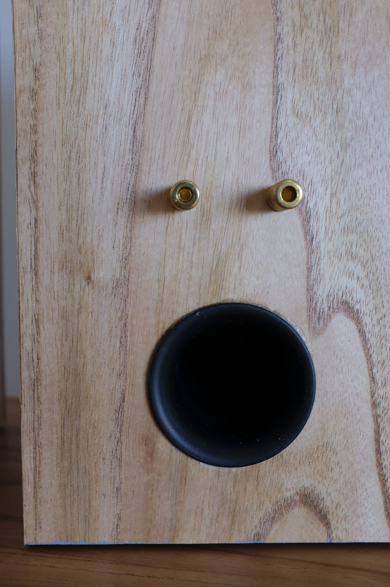

The idea of placing the connectors directly over the MDF is simple, but in other projects I used a round terminal cup. I recommend this last one method.
The port tube is from Part Express and if flared, I think that in this application a PVC tube will also work.
After testing, I disassembly everything and proceeded to cover the MDF with veneer. I used Paraiso wood. There are 2 methods to do so, one using white vinyl glue (it takes longer but should be better), and one using contact cement. Due to the small size I prefer the second method.
Then I covered the veneer with 3 coats of acrylic transparent paint y cut the holes.
In the future I will add a front screen, and to do so I let magnets under the veneer.

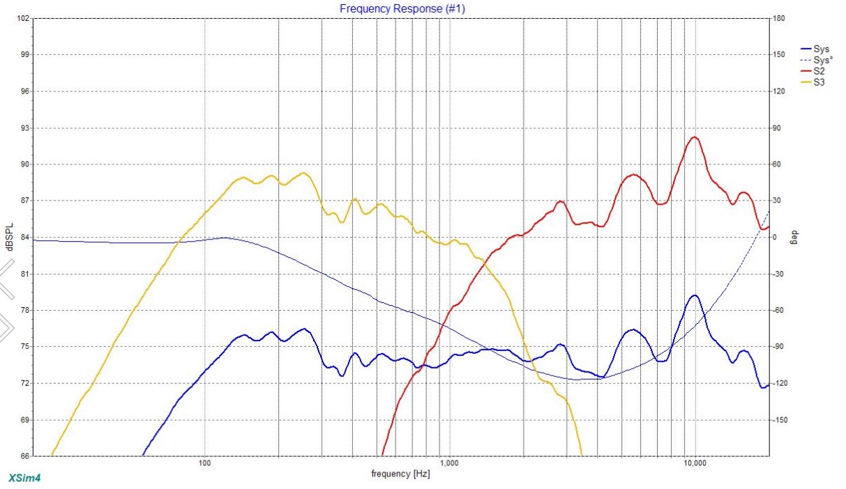

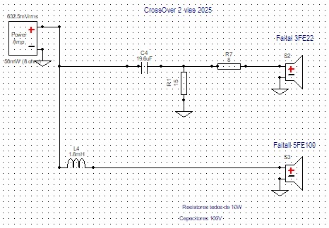

The Crossover and Testing
For the crossover design, I used XSim4 for the calculations, along with Audio Tools software and a Dayton Audio iMM-6 calibrated measurement mic for testing.
I kept things straightforward with a first-order Butterworth filter set at 1kHz. Of course, you can tweak the resistor values if you want to adjust the high-end response—either to bring it up or tone it down.
Everything was mounted on an MDF board, which I screwed to the bottom of the enclosure, right beneath the port tube.
In theory and according to the metering the tweeter should be lowered 3db, but in reality I found it better the way it is now. Lows sound bold and highs are not strident at all, plus voices that are very clear, so no further changes are needed for me.
One challenge I faced was the room itself—it’s pretty empty and sounds terrible acoustically, so I didn’t see much point in over-refining the tuning. Still, the materials I had on hand performed well enough.

Here is the schematic for the crossover.
The theoretical curves are very close to the metered ones.

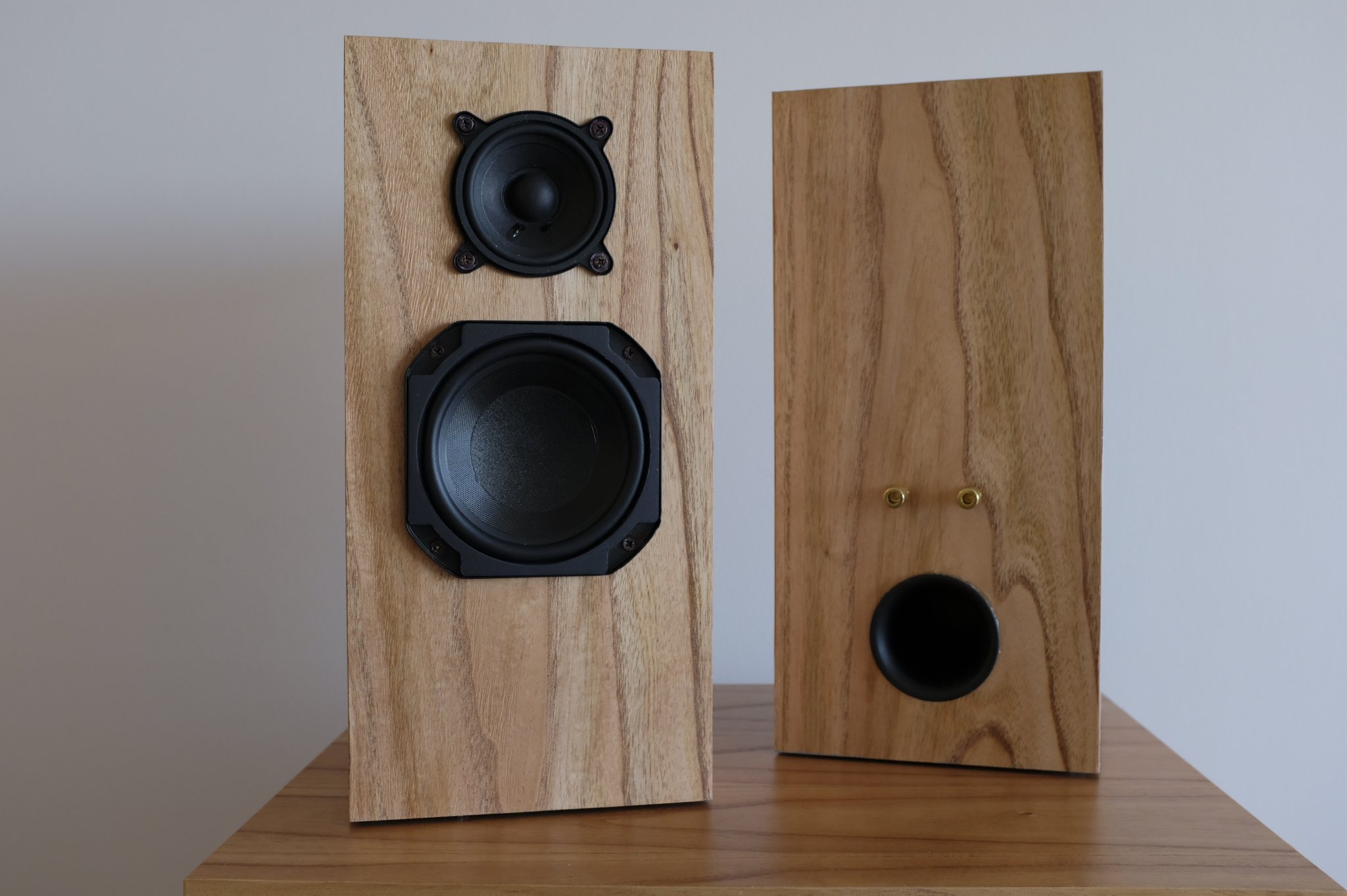

Final Assembly
To start, I protected the tweeter from protect the tweeter from being blown by the woofer by covering it with a yogurt cup, simple but effective. Then I mounted the crossover at the bottom of the box and sealed the port tube in place with silicone.
I added acoustic damping material to the back and side panels, then soldered and connected everything, making sure to double-check the polarities. Once that was done, I installed and screwed in the drivers.
The end result turned out really well—and considering the time and budget I put into it, I’m more than satisfied.
The total cost came to around USD 250, and it’s hard to find something this good, brand new, for that kind of money around here.
