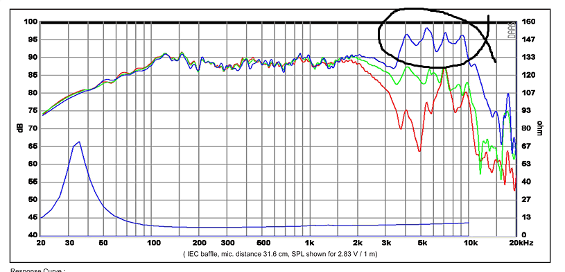

Sorry, Bill, I get cross at such rank bad advice to someone who is new to this. 🙄
I'd know what to do with that 5kHz cone-breakup, highlighted in black, but most people wouldn't.
6" SB17NRXC35-8 :: SB Acoustics

The SB17, as System7 says requires special handling

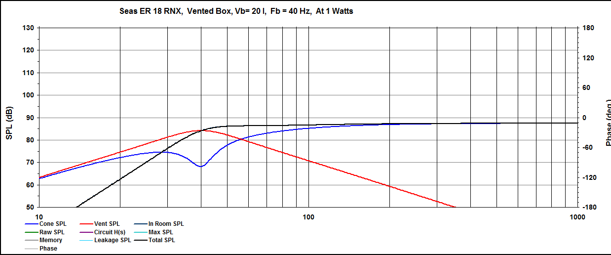

I can't exactly ignore the fact that, based on Zaphs measurements, the unit simulates very decent, in an appropriately sized and tuned box, to F3/F6/F10 41/36/31 Hz at about 83 dB/2,83V/1m once the baffle step compensation is taken care of. That is healthy figures for an 8 ohm unit.
Of course, what I say is relevant only to me and I can't guess other people's taste in these matters.

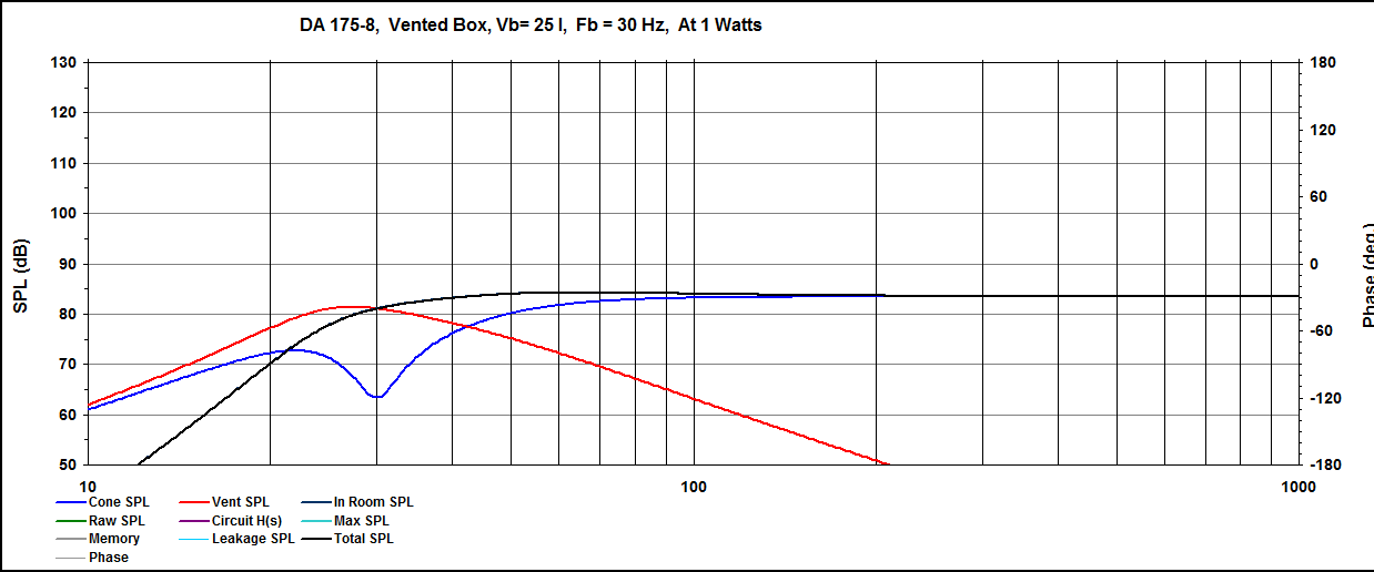

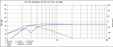

edit: DA 175-8 simulates like this 31/25/22 Hz and 79,3 db/2,83V/1m. Definitely a proof of deeper bass as wished by OP. What is to be with break-up frequencies, is a separate thing to think about.

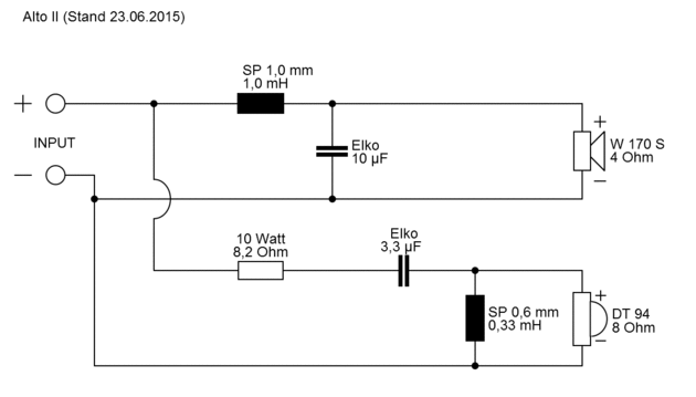

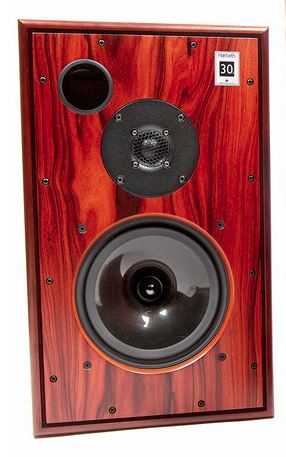

Crossover design is fairly easy with 5" bass and 8" bass two-ways. 6" bass is the one that always stymies me. Everything about it is difficult, from time alignment to tonal sound to the lack of natural rolloff in the bass.
With 6" bass, the 4 ohm woofer/ 8 ohm tweeter seems to be the easiest. Which is why commercial designs often use this cheap 3kHz combination. 1mH coil and 10uF on the bass, 3.3uF/0.3 mH on the tweeter with some attenuating resistor in front. Like the Visaton Alto II design, below.
ALTO II

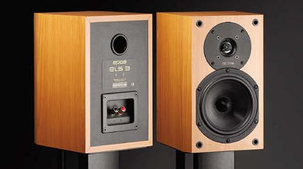

There have been a lot of 5" and 8" polycone designs. Below. Both are easy enough, IMO. As it goes, they both use metal tweeters. The bigger Harbeth M30.1 design uses negative polarity on the tweeter. It's a neat trick. The more you recess the bass, the lower you can take the crossover frequency. Let's say that 3kHz is 5cm half-wavelength. Which is about the difference in acoustic centre between the bass and tweeter.
Of course, anybody who thinks a 5" bass is going to go deep and loud in a big room is dreaming. But great for a bedroom. 😀
