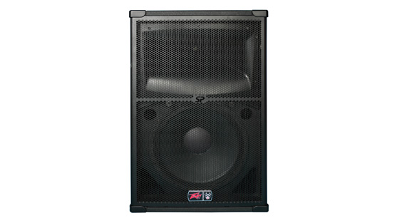

I wanted Altec Voice of Theaters, never could afford them if I did see some for sale. Saw Peavey SP5 on a website, went to the store, heard them, liked the SP2 better because the 15" woofer give better bass. The SP2 has a 2" piezo driven plastic horn, a 15" woofer, and a 1200 hz crossover. I love the sound, especially on top octave piano. Now I find out there are 6 or more vendors selling this design, although some have a smaller piezo driver. Yamaha, Mackey, American Audio, Electrovoice, all have versions of this design. There must be a lot of people that like it. I know some keyboard players on organforum.com are using different brands.

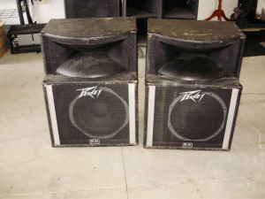

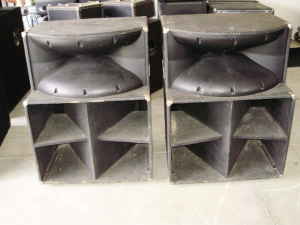

So who was first to do 15" woofer + piezo horn? I include some pictures gleaned from craigslist or peavey. Here is the primitive looking SP1.http://www.diyaudio.com/forums/attachment.php?attachmentid=181360&stc=1&d=1279897280 Here is an early SP2http://www.diyaudio.com/forums/attachment.php?attachmentid=181361&stc=1&d=1279897280 Here is a modern production SP2 http://www.diyaudio.com/forums/attachment.php?attachmentid=181362&stc=1&d=1279897280

Are you sure those are piezo horns? Aren't they standard 1" throat compression drivers?
12" woofer + 1" compression driver on a horn is a very standard PA device. The origins go back to the 1930s or so.

Thanks for the answers. No, I'm not sure the horn driver is piezo, although some quoted text about another brand said it was 1.75" piezo. Beautiful pictures.
They aren't piezo. They are standard compression drivers.

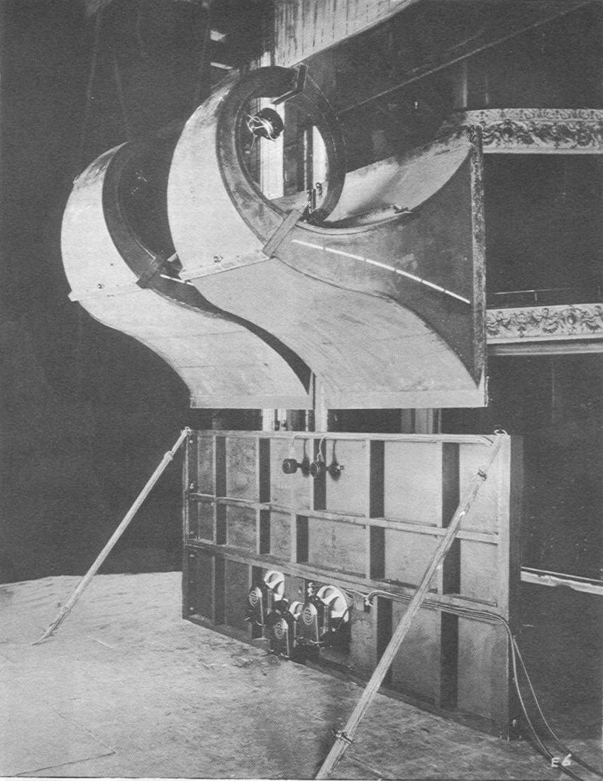

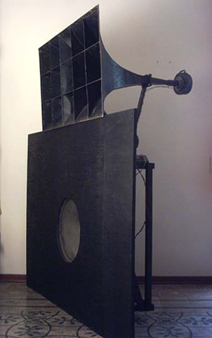

The 'modern' point source driver ('full-range', woofer, etc.) was invented in 1925 with the earliest 'modern' horn/reflex speaker AFAIK being a 1930 Bell Labs/W.E. 12" 'full-range'/800 Hz multi-cell design (can't find a photo ATM) that was quickly replaced with a cast alum. radial horn, then in 1936? a 15" woofer with a new 800 Hz multi-cell that remained in production with various horn, woofer models till the end of the 1970s ('80s if you include the Model 19) as the JBL/Altec Iconic, Valencia, 800 Hz Voice of the Theater in both pro and consumer versions. (JB) Lansing Manufacturing's version that would dominate after being bought out by Altec: http://www.lansingheritage.org/images/altec/catalogs/1942/page07.jpg
The Bell Labs/W.E. design would be resurrected after the Korean War and last through the '80s with various woofer models as the A8: http://www.lansingheritage.org/images/altec/catalogs/1966-vott/page4.jpg

Hmm, missed the piezo part. Don't know, though I first saw them in '50s era Motorola HIFI consoles. Still have a pair of 700 Hz cut-off/1200 Hz XO horns with large screw on piezos. I don't recall Peavey using the driver, but they were considered as strictly entry level rigs when they first hit Hotlanta in the mid? '60s. I remember trying to listen to a large (for the time) array at Rhythm City, but they were so shrill at high SPL that I had to make a hasty retreat, so may very well have been piezos. Mostly, I remember the crude fiberglass horns looking like they'd been made from a back poured JBL.

Those early 2 piece SP2's in the picture at start post may be the shrill ones you are talking about hearing in 1970. They only sell for about $200 a pair. Whereas the SP2-XT is pulling about $300 each used, and SP2G with the speakon connector is getting $150 less than retail at about $450. Thanks again. Will look at the archive, have been to Peavey's site about the new model but didn't figure out that feature on the older ones. I did actually hear a VOT setup once in a theater in 1967, our band director told us to go have a listen. I heard them on Lord Jim movie, which had an indonesian gamalong orchestra soundtrack. Interesting and pleasant, but I had no live experience with those instruments to know what they really sound like.
Assuming the bass horns are FH1, I've suffered their excessive delay on many occasions, but the HF horn was a more abruptly terminated radial with no mounting flange, only glassed in metal mounting tabs to mimic the tabs on Altec sectoral horns, but I can't remember the JBL model it appeared to be a clone of and the stack was high enough that I couldn't see the HF driver.
The drivers I've seen though looked like some cheap EVs I've seen which in turn was offered as an Altec IIRC after being bought out by them, but I can't find the right info ATM.
